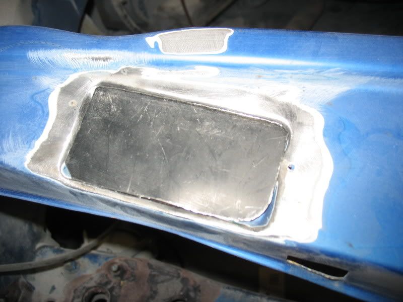

So i had to do a bodge for clearance for the ic pipes. Looked like this..
http://i6.photobucket.com/albums/y23...rontpanel9.jpg
That's the better side,

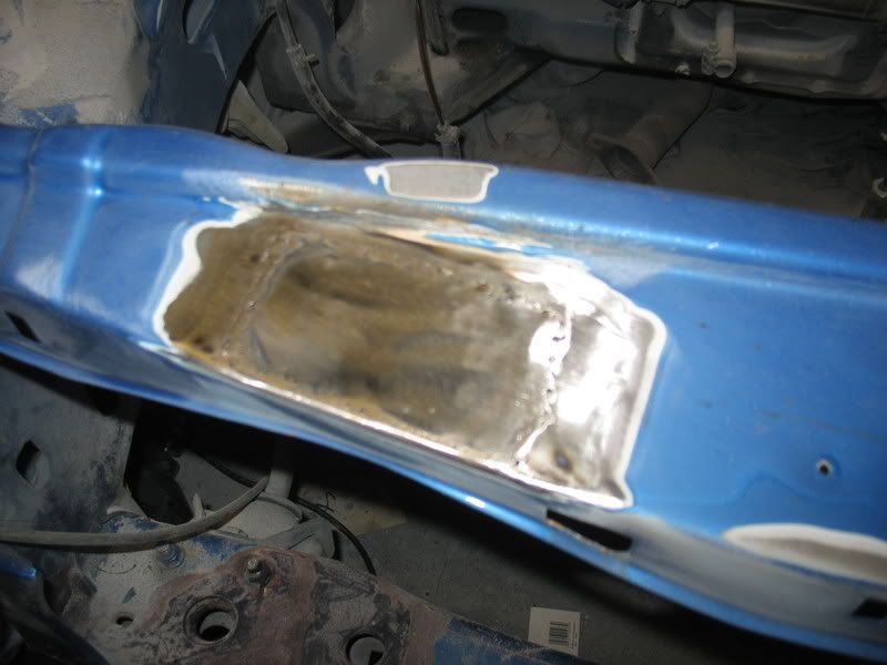

Cut and shaped it back,
http://i6.photobucket.com/albums/y23...rontpanel2.jpg
Be the join for the front panel has been cut off here, i had to weld it back together..
http://i6.photobucket.com/albums/y23...rontpanel4.jpg
Better than my welder.. but it was still having probs..

Ground the welds down,
http://i6.photobucket.com/albums/y23...rontpanel5.jpg
http://i6.photobucket.com/albums/y23...rontpanel6.jpg
Had to fill the holes a bit, used my weld.. God i hate it..lol
http://i6.photobucket.com/albums/y23...rontpanel8.jpg

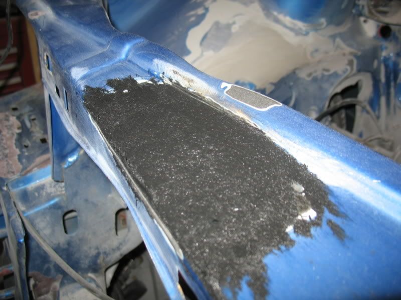

Rusted treated it as a just in case.
http://i6.photobucket.com/albums/y23...ontpanel17.jpg
Sealed it up,
http://i6.photobucket.com/albums/y23...ontpanel19.jpg
http://i6.photobucket.com/albums/y23...ontpanel20.jpg
Now its ready to primer and paint.

It seems you're not using any / enough gas when welding there Benn.
Gas will give you the penetration you want.

Yeah? There was very little gas in it, but my welding i just cant get any of the setting on it to work right, it just spits and done funk all. Dans welder (one that broke) welds really nicely and i can get a good beading going. Might have to buy a new cheapish one.Quote:
