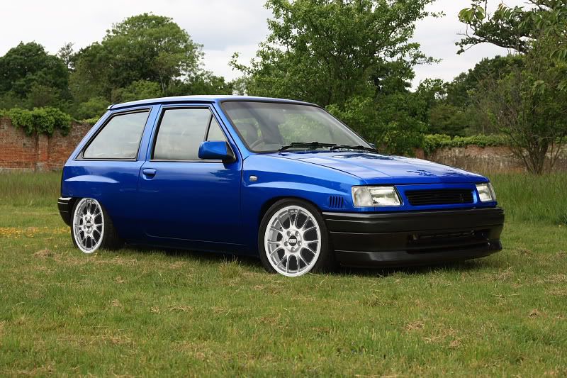

Was looking smart again Ben wheels suit it and more I saw them today the more they grew on me! Top work as always!
Top choice!
That looks ace with those wheels.
OMactualG
Top choice, i do doff my hat to you Sir Benn
WOW :cool: more WOW the wheels look perfect, still love the turbo rims for retroness but the BBS's seem to make the look somehow more upto date.

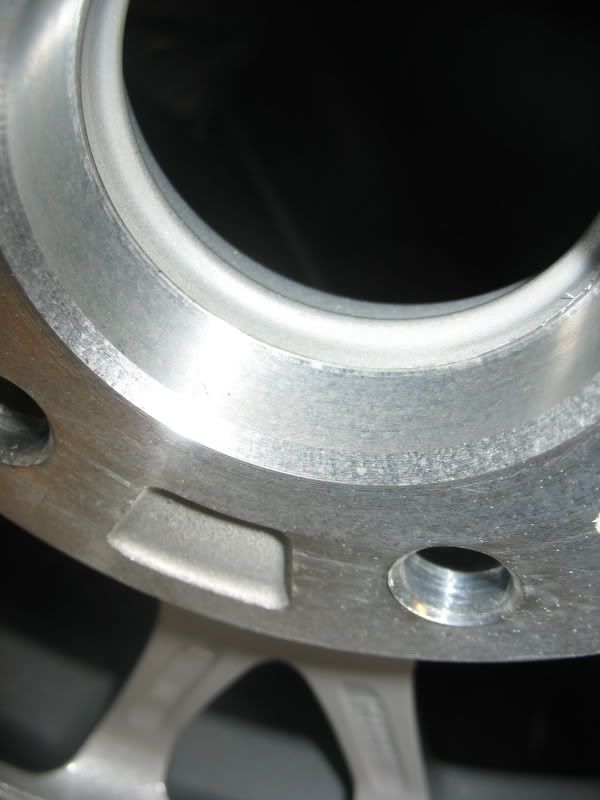

A quick search and i found a set of "wobbly" wheel bolts. After doing alot of re-search, i found some that have "wobbly" washers on them they give 2mm movement. Made in the uk buy a engineering please, stating that they are 100% safe, so i ordered a set. Next was a trip to the machine shop to open the center bore out to fit my Cav hubs. I measured the hubs at 65.75 so i had the wheels done to 66mm. Thinking the 0.25 of a mm wont give any probs..

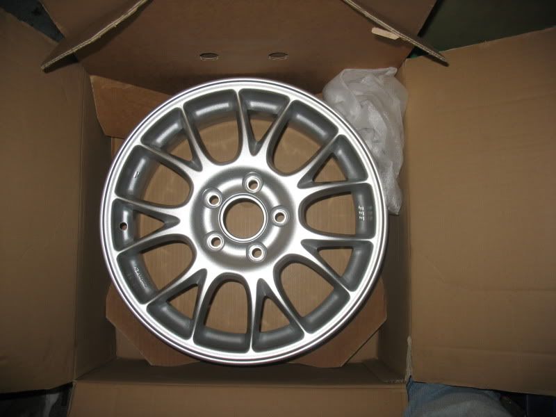

BNIB... Mmmmmm
http://img.photobucket.com/albums/v3...s/IMG_0459.jpg
Give the tuck i want...

Center hole machined..
http://img.photobucket.com/albums/v3...s/IMG_0460.jpg
http://img.photobucket.com/albums/v3...s/IMG_0461.jpg

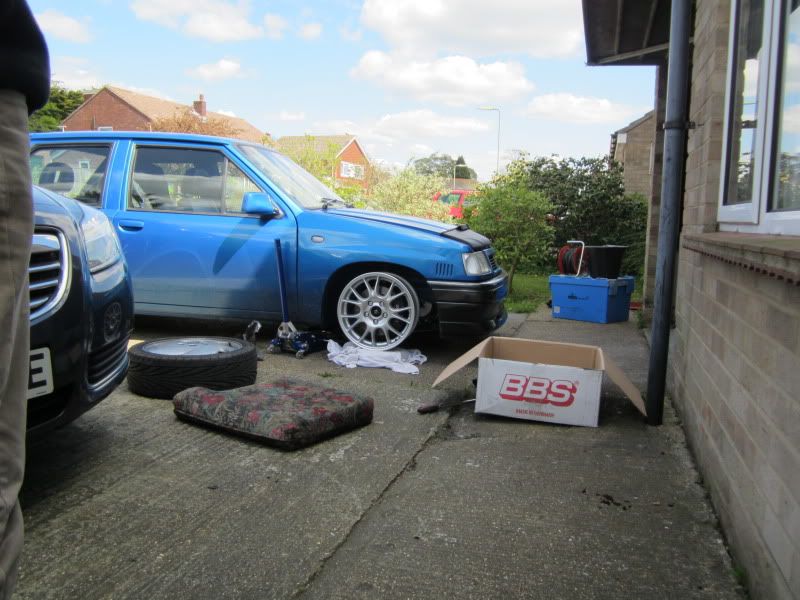

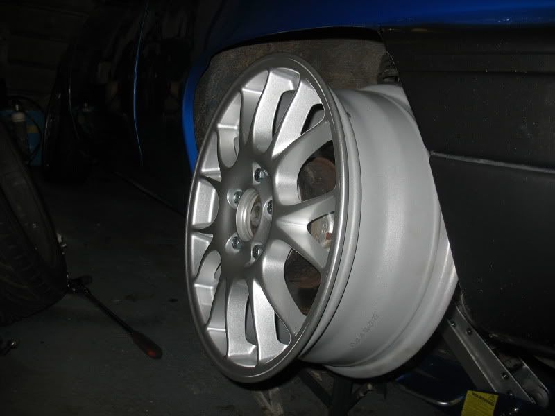

Test fit in the garage.. (before new rear discs and re-furbed calipars)
http://img.photobucket.com/albums/v3...s/IMG_0464.jpg
http://img.photobucket.com/albums/v3...s/IMG_0471.jpg

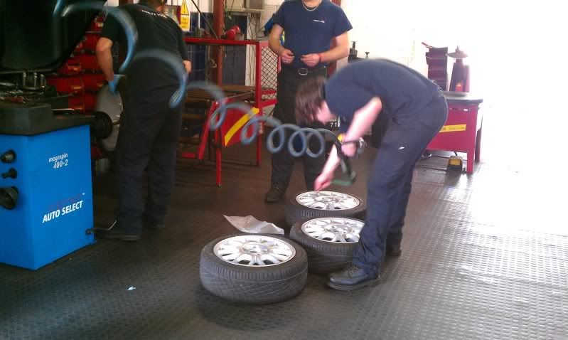

Next i needed to try with tyres and front spacers.. Popped to Protyre Fareham. Huge thanks to Jim, Paul and Jason. For fitting the tyres very very very carefully..
Nitro filled too..
http://img.photobucket.com/albums/v3...elfitting2.jpg
Jim checking for any marks.. Where none.
http://img.photobucket.com/albums/v3...elfitting3.jpg

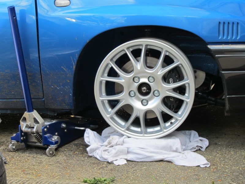

Met Dan and Pete at John's house, fitted a 3mm spacer and...
http://img.photobucket.com/albums/v3...fittedtwo2.jpg
Just enough i think..
http://img.photobucket.com/albums/v3...fittedtwo3.jpg
