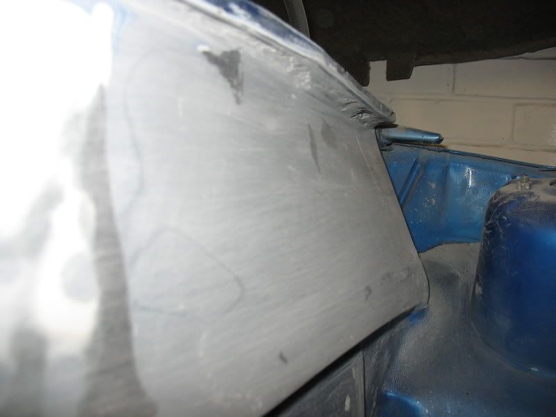

Right From the last pics up there ^ I sanded the fiber glass back, but found the bit i had welded in was still a bit warped so i have to tap it back abit. But in doing that i broke a few welds so i ground them back and rewelded them, this time getting them much better and stronger.

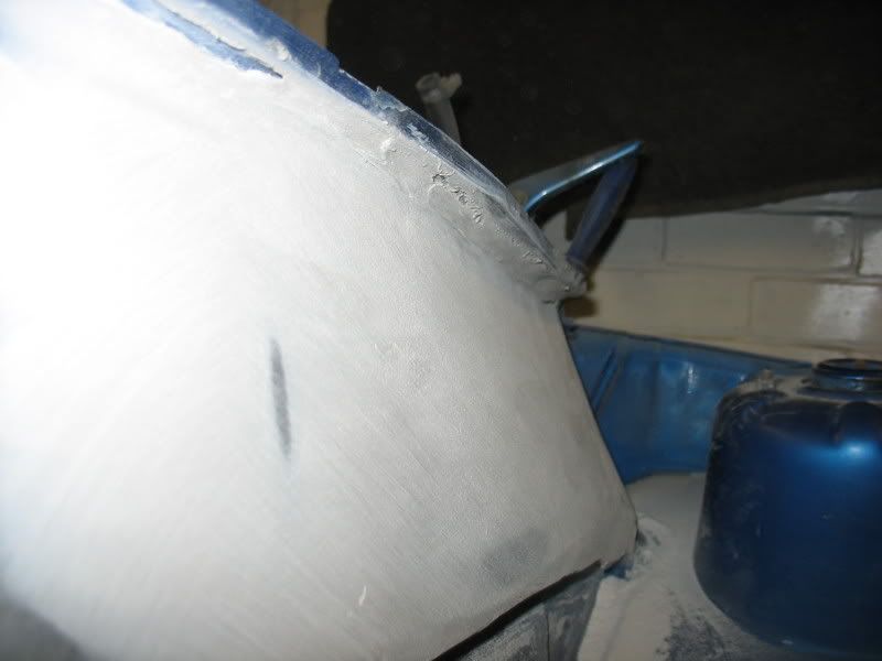

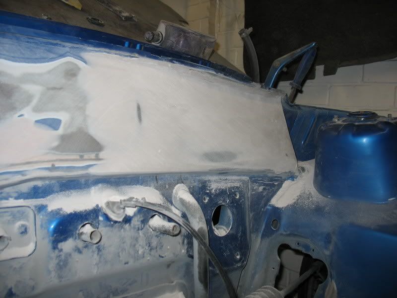

Refiberglass over the welds and then got it all sanded back.
http://img.photobucket.com/albums/v3...s/IMG_4599.jpg

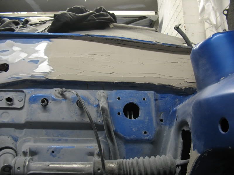

Quite flat but not enough..

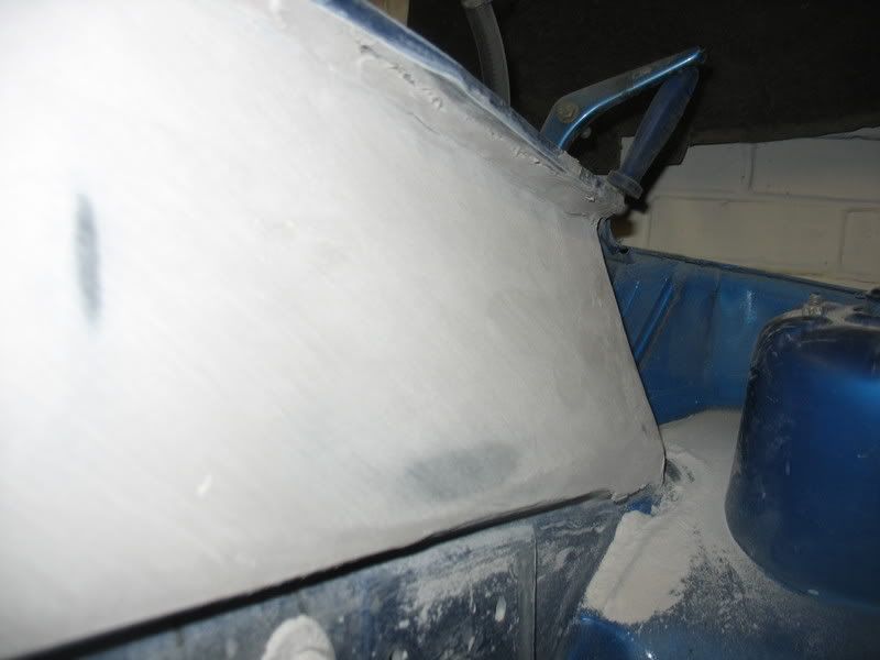

http://img.photobucket.com/albums/v3...s/IMG_4598.jpg
http://img.photobucket.com/albums/v3...s/IMG_4597.jpg
So gave it a skim of filler to get it nice and smooth.
http://img.photobucket.com/albums/v3...s/IMG_4600.jpg
http://img.photobucket.com/albums/v3...s/IMG_4604.jpg

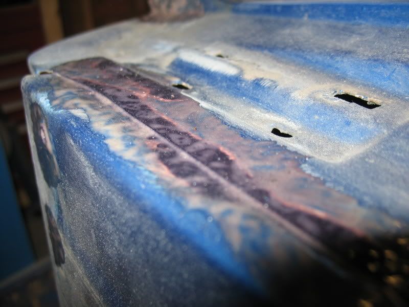

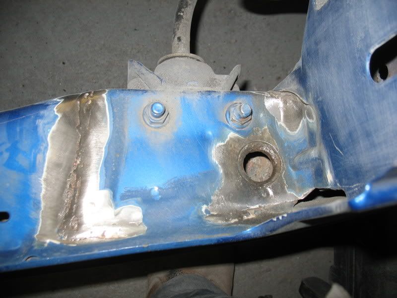

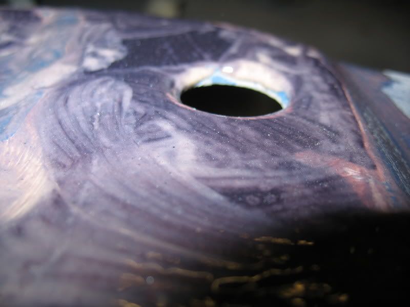

So with that drying i started to clean up the front pannel where the rad sits.
http://img.photobucket.com/albums/v3...s/IMG_4606.jpg

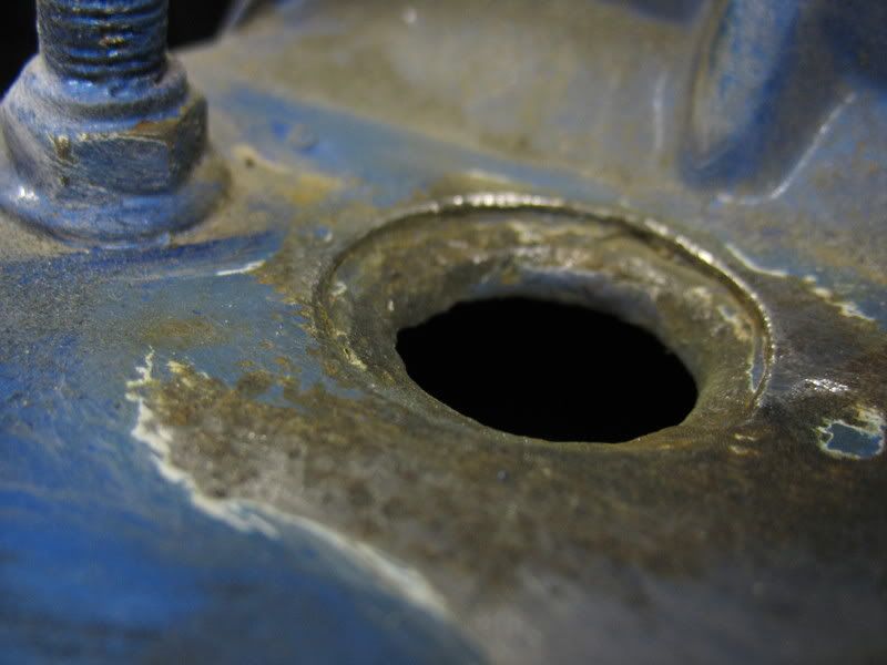

The round holes get wet from rain and if the rad leaks (which i found out mine does) and i wanted to clean up the welds as well.
http://img.photobucket.com/albums/v3...s/IMG_4607.jpg
http://img.photobucket.com/albums/v3...s/IMG_4602.jpg
http://img.photobucket.com/albums/v3...s/IMG_4601.jpg
Got some rust killing cleaner stuff. Works very well bubbles away then you can just wiper it off and the rusts gone..
http://img.photobucket.com/albums/v3...s/IMG_4611.jpg
http://img.photobucket.com/albums/v3...s/IMG_4610.jpg
