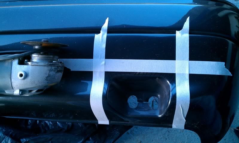

Who needs one of them? (0.5mm cutting disk)

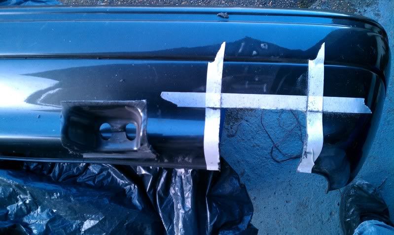

I cut this from a Nova in a scrappy ages ago, ready for this job.

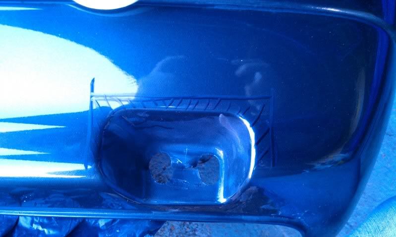

Spotted it in and adjusted,

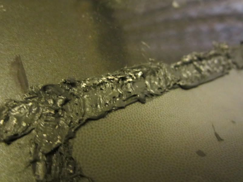

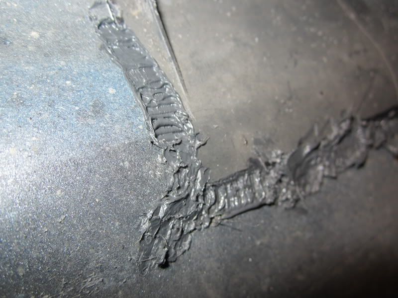

Plastic weld in,
http://img.photobucket.com/albums/v3...earbumper6.jpg
http://img.photobucket.com/albums/v3...earbumper1.jpg
http://img.photobucket.com/albums/v3...earbumper8.jpg

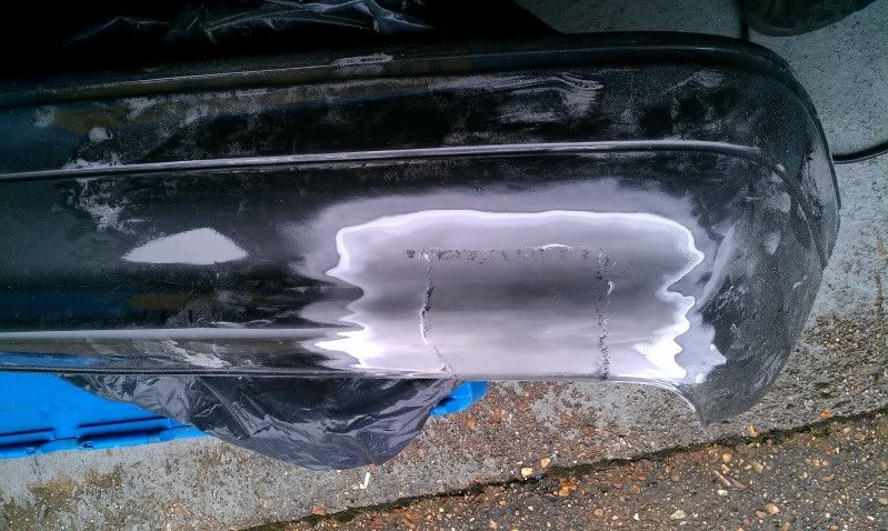

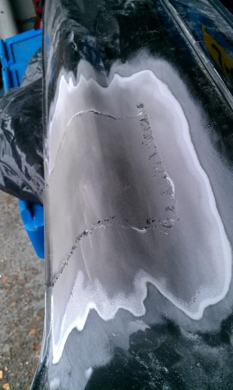

Sand xs off,
http://img.photobucket.com/albums/v3...oeingeye24.jpg
http://img.photobucket.com/albums/v3...oeingeye25.jpg
I then weld the holes you can see, as i want to use as little filler as poss.

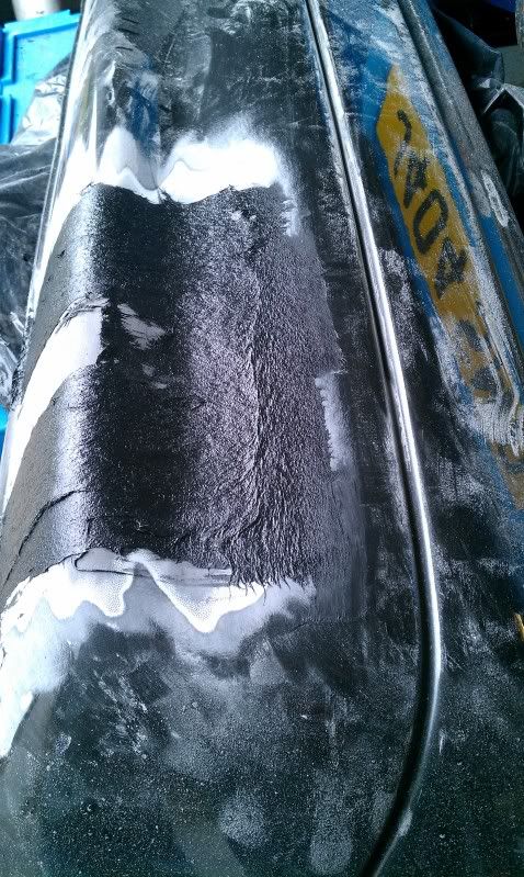

Black carbon fiber glassed over it (as its a flexi fibreglass)
http://img.photobucket.com/albums/v3...oeingeye27.jpg
Sanded that off tonight and use a very small skim of filler to make 100% smooth. Gonna take it and primer it tomoz.
