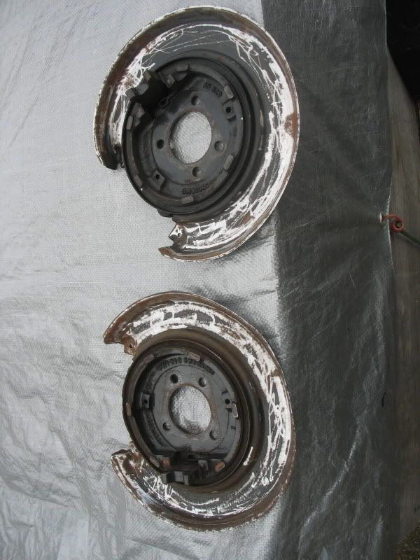

So rear beam... With it off and at the powder coaters i stripped the hubs down..

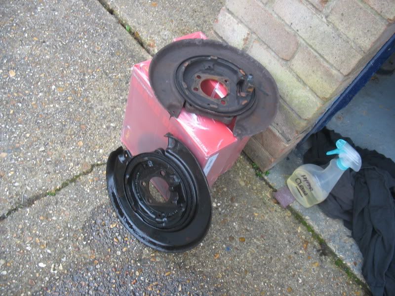

Backing plates cleaned and painted,
http://img.photobucket.com/albums/v3...earbrakes1.jpg
http://img.photobucket.com/albums/v3...earbrakes2.jpg

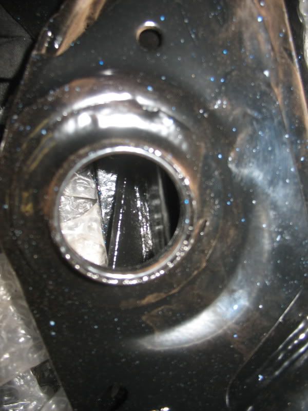

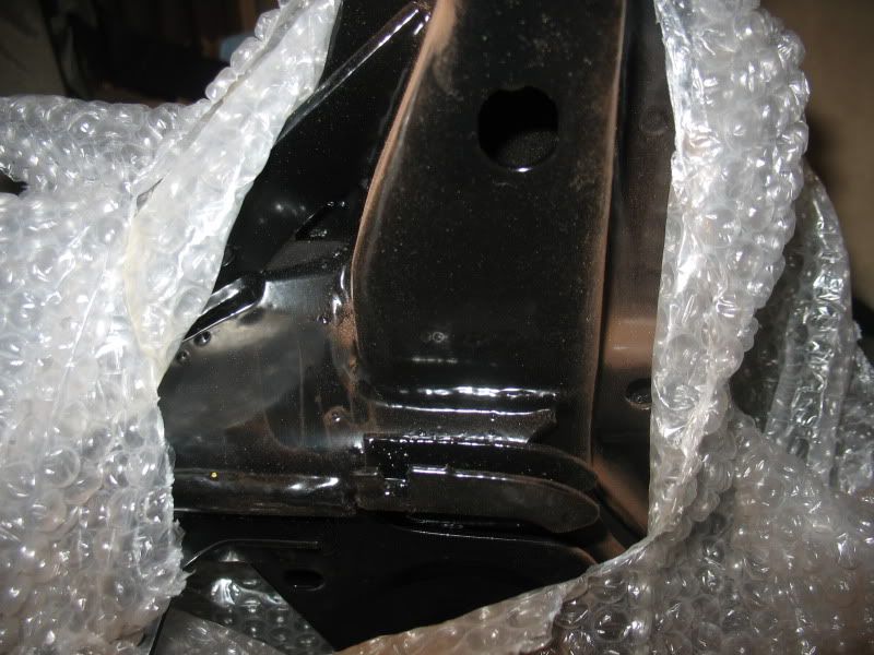

Beam back.. Looks great, had to drill out the old bushes (hence the rusty dust in some pics)
http://img.photobucket.com/albums/v3...Beamstuff4.jpg
http://img.photobucket.com/albums/v3...eamstuff28.jpg
http://img.photobucket.com/albums/v3...Beamstuff7.jpg
http://img.photobucket.com/albums/v3...Beamstuff8.jpg

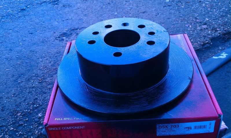

Discs grease masked and painted. (painted the edge of the disc as i hate it when they are all rusty)
http://img.photobucket.com/albums/v3...n/IMAG0251.jpg
Grease it,
http://img.photobucket.com/albums/v3...n/IMAG0250.jpg
Then paint it,
http://img.photobucket.com/albums/v3...n/IMAG0249.jpg
Then wipe paint off and the braking surface is clean...

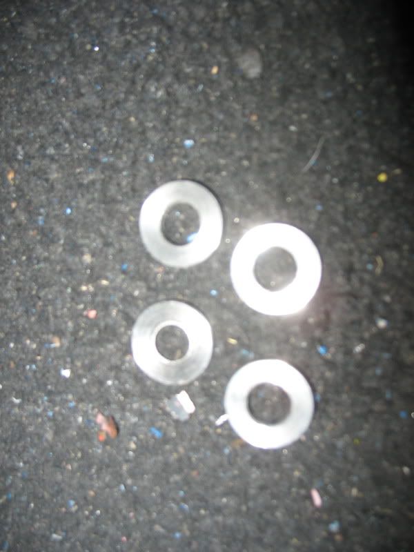

So then start rebuilding beam, Remember my bad caster? Using some tig (soh-cah-toa) i worked out what was needed to fix it and had some shim made to correct. (left 1.4mm and right 2.9mm cut on a lathe)
http://img.photobucket.com/albums/v3...0on/shims1.jpg
http://img.photobucket.com/albums/v3...0on/shims2.jpg
