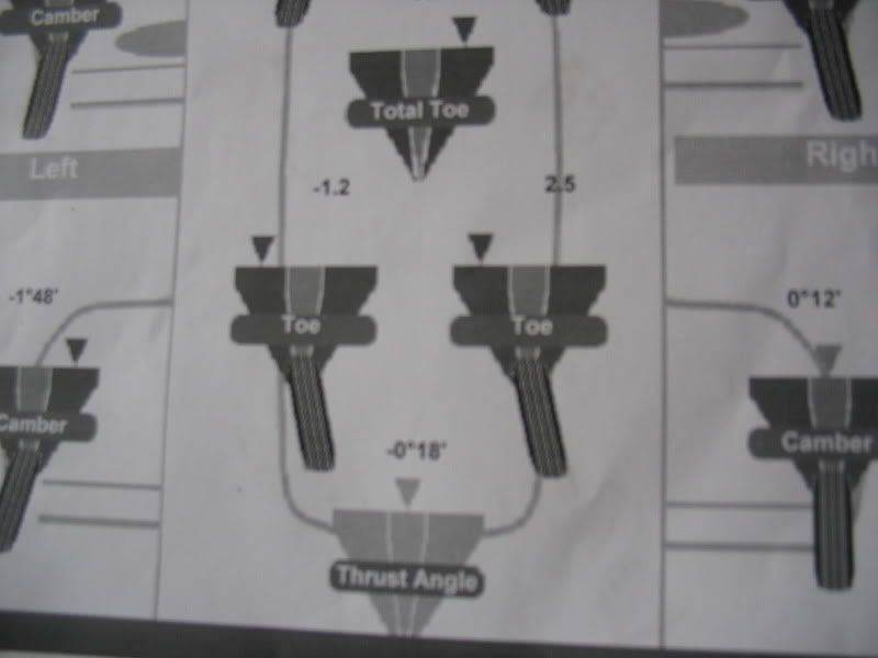

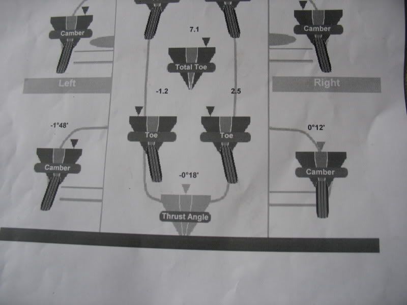

New print out...
http://img.photobucket.com/albums/v3.../beamoff22.jpg
http://img.photobucket.com/albums/v3.../beamoff29.jpg
One from before to compare..
http://img.photobucket.com/albums/v3...n/IMG_0067.jpg
So it's better and now in the "acceptable" area But i'd like it better than that. So with a bit of maths (trig) i can work out the size of the skim to make to correct the toe and get the camber the same on both sides...

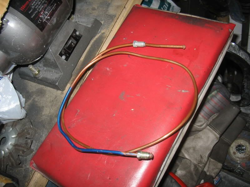

In the week i popped in to the bodyshop and made a brake line loop to stop fluid loss.
http://img.photobucket.com/albums/v3.../beamoff21.jpg

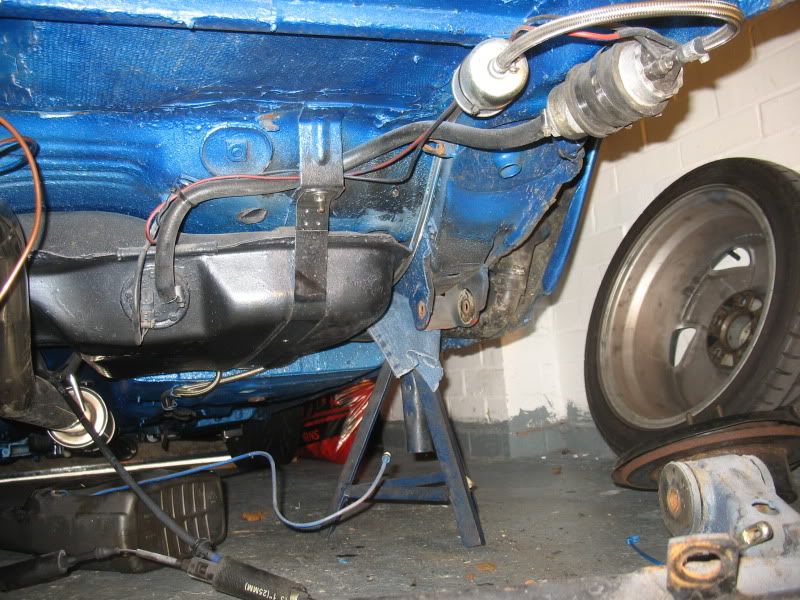

Getting it fitted, (can see bits that need a repaint under there too)
http://img.photobucket.com/albums/v3.../beamoff23.jpg
Then start unbolting everything again...
Everything off, beam out, again see more bits that need painting :grr:
http://img.photobucket.com/albums/v3.../beamoff26.jpg

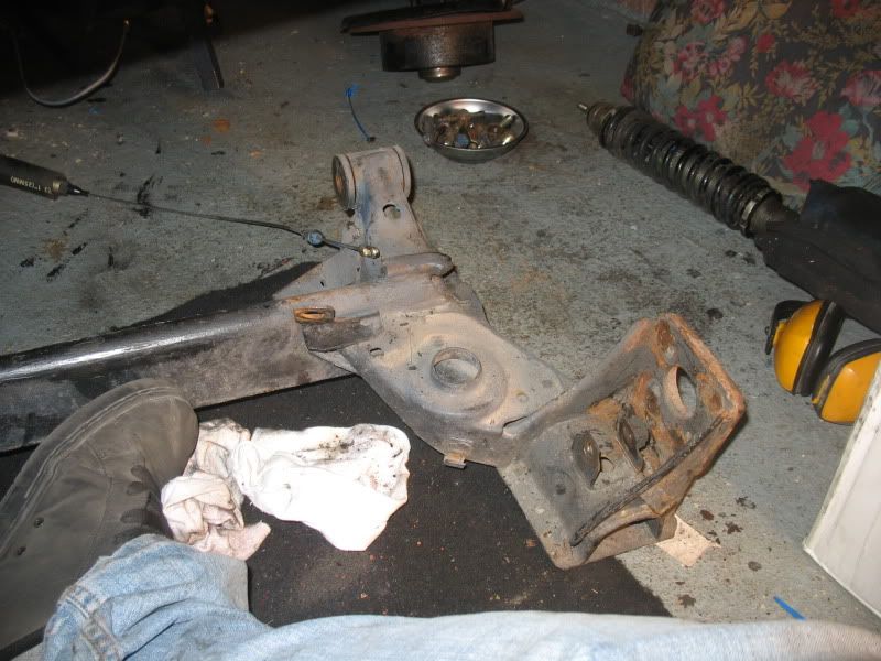

Stripped everything off the beam..
http://img.photobucket.com/albums/v3.../beamoff25.jpg
Can re-furb my calipers now, paint my break lines too.

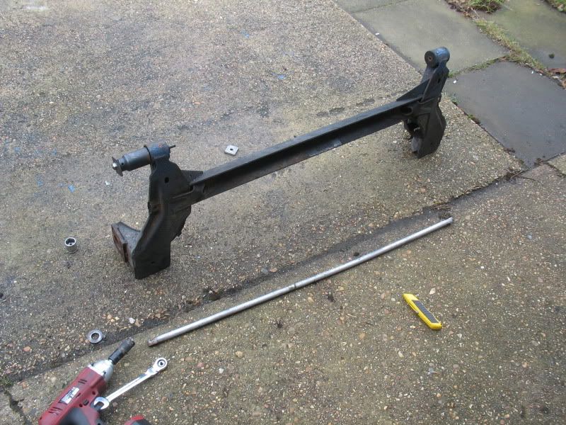

Beam out side so i could beat the ARB out,
http://img.photobucket.com/albums/v3.../beamoff27.jpg

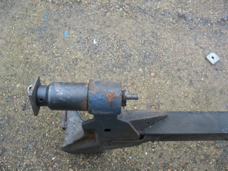

Only one bit stuck.. I cant get the bushes out to replace..
http://img.photobucket.com/albums/v3.../beamoff28.jpg
So i've cut the outer rubber down, so it can all be powder coated and then i'll try and get the bushes out again..

Are these mods just to tackle the toe? The camber looks quite different side to side also?
Also why are the figures for the rear RH wheel different if you haven't touched it at all?
With the bushes if you can't pull them out due to tightness, put the drill through it a few times or heat them up a bit.
Benn if they are original bushes it might be worth trying new ones before you do an machining, it could be just down to the fact the old ones are slightly worn.
I did think about it..lol I'll hack them out or drill as said below..
Cheers dude, a Cav wouldn't fit in mine as its to thin..
Cheers dude, will look better when powder coat and nice.
Yes, mainly to fix the toe, and to give both sides equal and even camber, as a bit of camber is ok. I'm gonna say it's all done to the way the beam was made and welded, it's the only thing it can be.
Never though of drilling them, i'll try that tomoz.
I did talk that thru with my mate, but we didnt think it could be. Yes the are std but they dont look like they've wore to bad..
