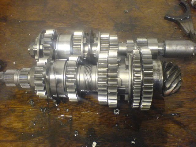

straight cut gears look the boom :)

straight cut gears do sound ace whining away lol
ha its the whining noise that makes me want one.lol anyone know of any f28 straight cut boxes going?b

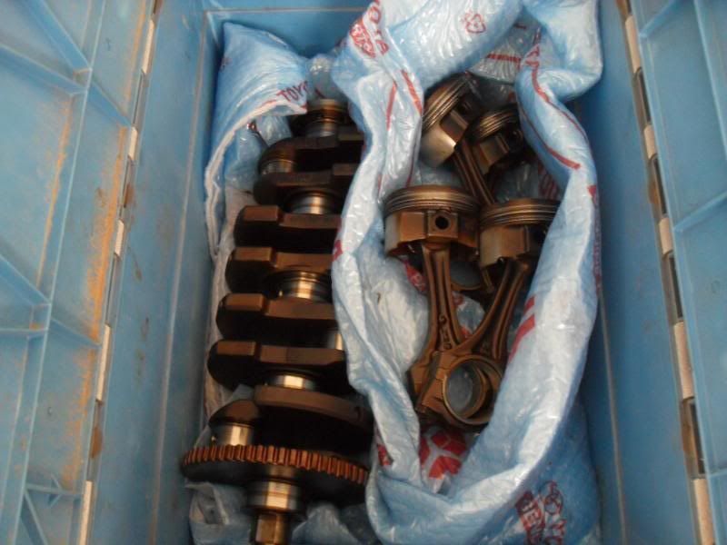

At the same time I also gave him the crank for checking/polishing and the connecting rods to make sure these had no problems either.....
http://i84.photobucket.com/albums/k2...g?t=1299351283

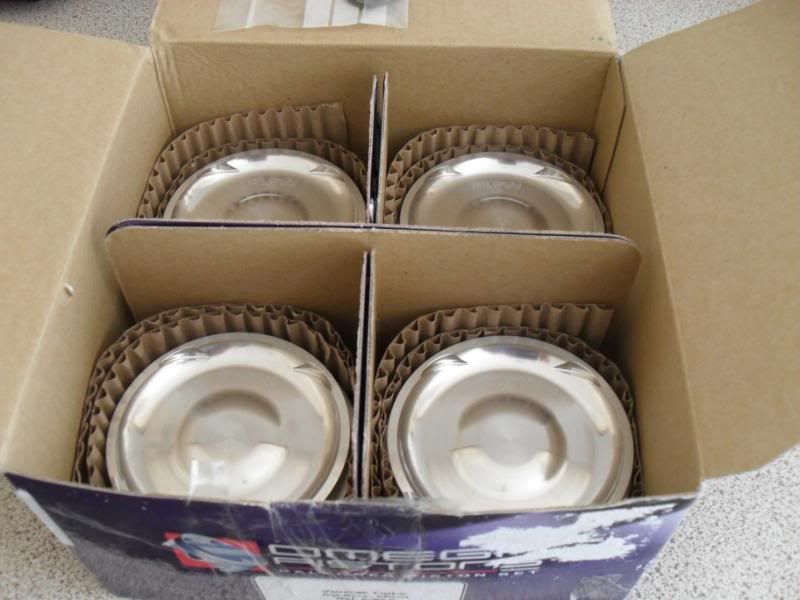

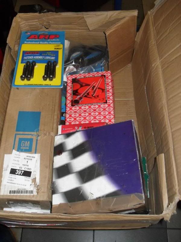

Whilst the block was away a few more parts were arriving. Cue a parcel from spanishfly being a set of David Dixons big block shafts/hubs complete with carriers and new bearings. Unfortunatly Rob had painted them a dodgy looking hammerite grey..........
http://i84.photobucket.com/albums/k2...g?t=1299351402
http://i84.photobucket.com/albums/k2...g?t=1299351954

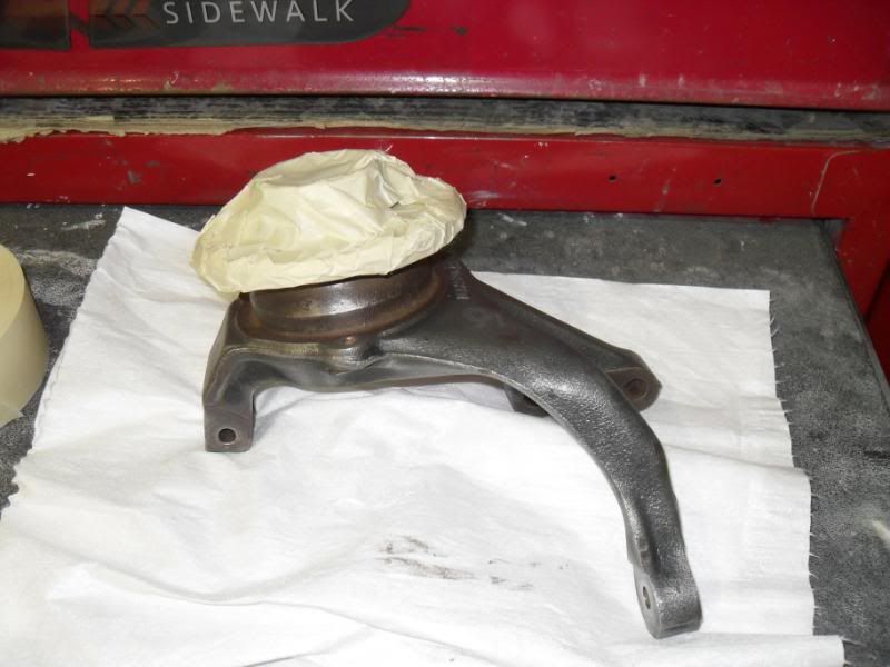

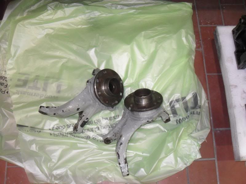

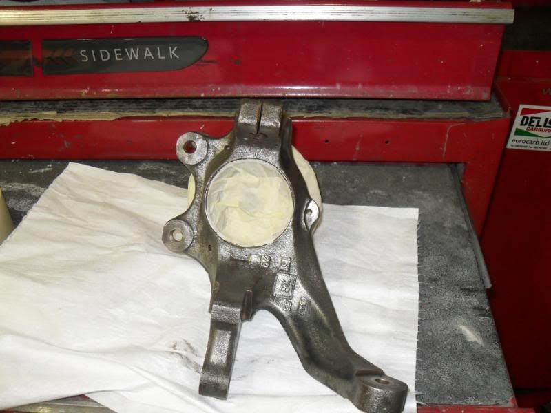

Not really being a fan of the colour I taped up the bearings and brushed on some stripper.....
http://i84.photobucket.com/albums/k2...g?t=1299351752
Once all the paint was off I gave them a quick jetwash to neutralise the stripper and clean them up. Then blew them dry leaving me with these.........
http://i84.photobucket.com/albums/k2...g?t=1299351874

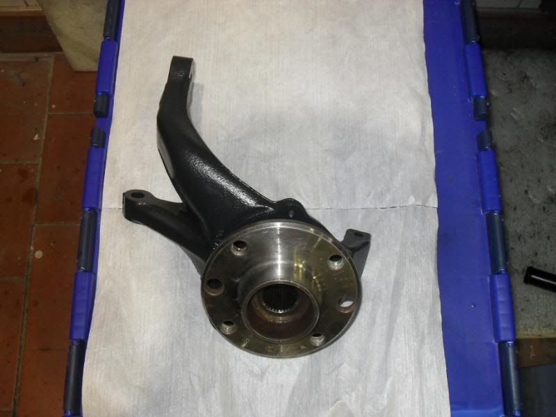

Then after a wirebrush/sanding session I got them taped up ready to paint later with a few other parts........
http://i84.photobucket.com/albums/k2...g?t=1299352222
http://i84.photobucket.com/albums/k2...g?t=1299352249
http://i84.photobucket.com/albums/k2...g?t=1299352275

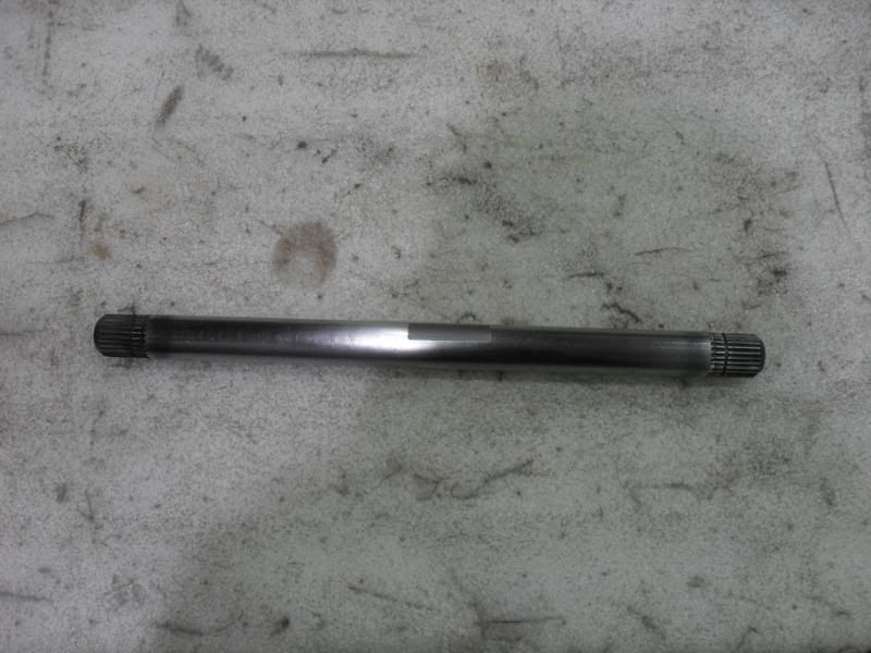

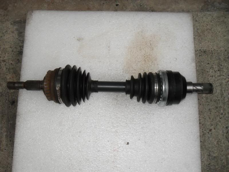

One of Davids equal length shafts bought previously in a groupbuy was also rubbed down ready.......
http://i84.photobucket.com/albums/k2...g?t=1299352554

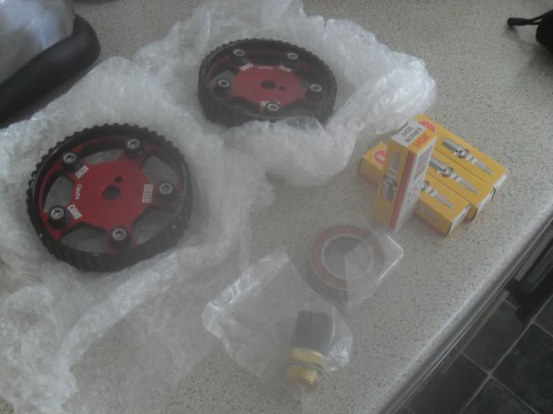

Some verniers from sbd to retard the timing for the xe inlet cam, new Ngk Bcr8es spark plugs, new dummy shaft bearing and fan switch also.......

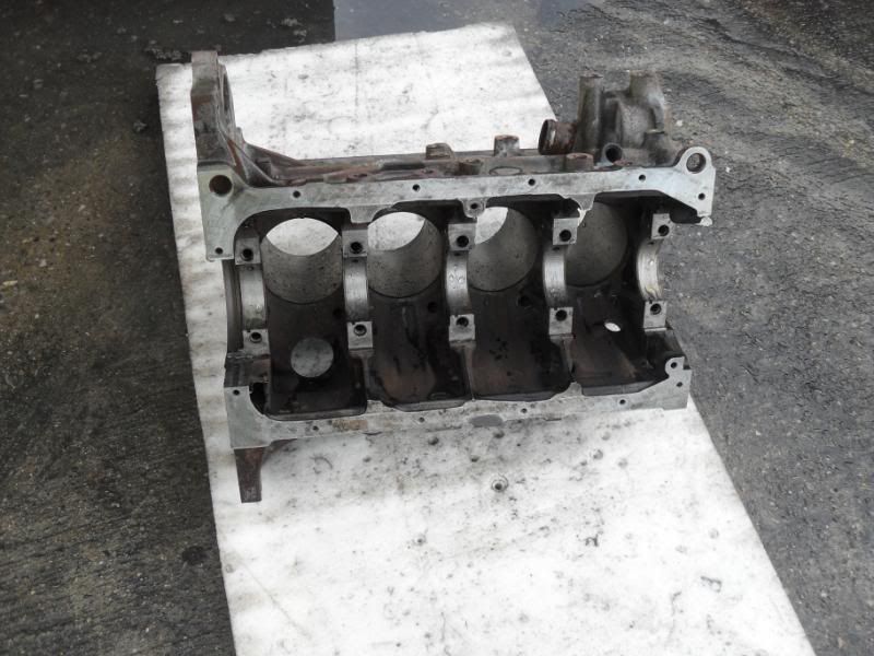

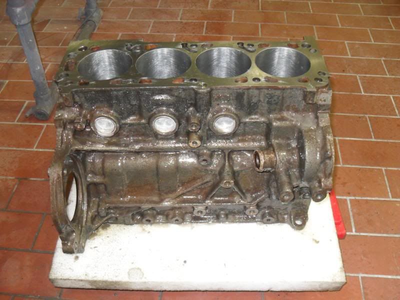

A few weeks later the machine shop called to say the block was ready so I went and collected it and dropped it with my engine builder to check he was happy with the work that had been carried out. He removed the internal oilway bungs and cleaned out the oil ways before giving it to me to clean then prep for paint. Its had a rebore to suit the 87mm omegas and a slight deck also..........
http://i84.photobucket.com/albums/k2...g?t=1299356834

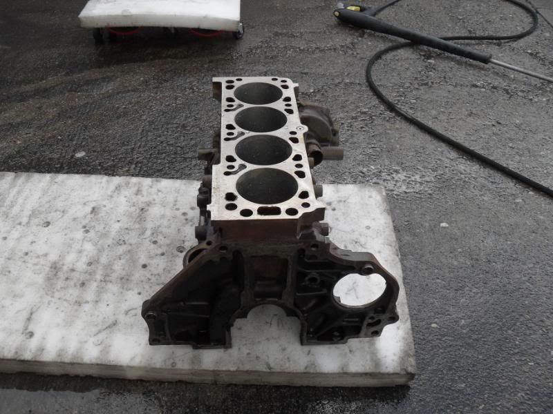

One thing we had noticed was that the block had been paint previously and I didnt know what with or how well the prep had been beforehand so I made the decision to strip it..
Paint stripper brushed on.............
http://i84.photobucket.com/albums/k2...g?t=1299356385
Once the stripper had worked its magic I lifted it onto some makeshift wheels and rolled it outside to give it a cold wash neutralising the stripper and cleaning it........
http://i84.photobucket.com/albums/k2...g?t=1299356542
http://i84.photobucket.com/albums/k2...g?t=1299356574
Once I was happy all the stripper was off I upped the heat and steam cleaned the outside before tipping the block onto its side both ways to clean all the insides out as well.......
http://i84.photobucket.com/albums/k2...g?t=1299356678
Then it was back onto the wheels and inside too be dried out........
http://i84.photobucket.com/albums/k2...g?t=1299356735
My builder had warned me to dry it out thoroughly and re lubricate the bores and face to prevent them flash rusting etc. So I spent sometime using the airline blower drying it all out then re lubed the bores and face before wrapping it up to keep it clean and dry until I got round to prepping for paint etc........

During the course of the following week I used a combination of sanding tools and some wire brush attachments on a drill as well as a fair bit of manual rubbing to remove any flash rusting the block had and to give a good key for the paint to stick to...........
http://i84.photobucket.com/albums/k2...g?t=1299357260
Once I was happy it was as good as I could get it I degreased it thoroughly or more than one occasion! and then we lifted it into the booth ready to mask and paint......
http://i84.photobucket.com/albums/k2...g?t=1299357713
http://i84.photobucket.com/albums/k2...g?t=1299357745

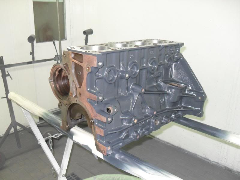

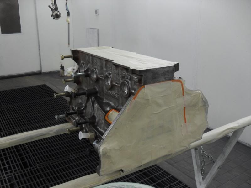

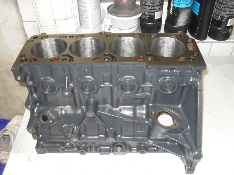

All the areas I was instructed to keep free from paint were masked up then I placed random bolts in all the threads and used a few sealer nozzles to prevent paint from going into other areas too.
Then I applied an acid etch primer followed by colour and then a high temp engine enamel lacqeur which I added a little matting agent to as I wanted the block to follow the same colour scheme as everything else. Once painted I demasked it and heres the outcome.....
http://i84.photobucket.com/albums/k2...g?t=1299358013
It took sometime and effort but the outcome has been worth it! Nearly forgot to mention these were done at the same time too.........

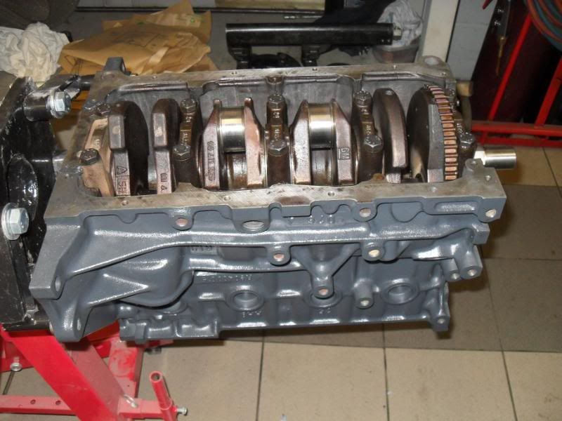

The next morning all dry things were looking real well.....
http://i84.photobucket.com/albums/k2...g?t=1299358676
http://i84.photobucket.com/albums/k2...g?t=1299358704
http://i84.photobucket.com/albums/k2...g?t=1299358738
Shortly after I again re lubricated the bores,face and other mating surfaces ready for the block to go back to the engine builder. More updates tommorow if I get the chance.

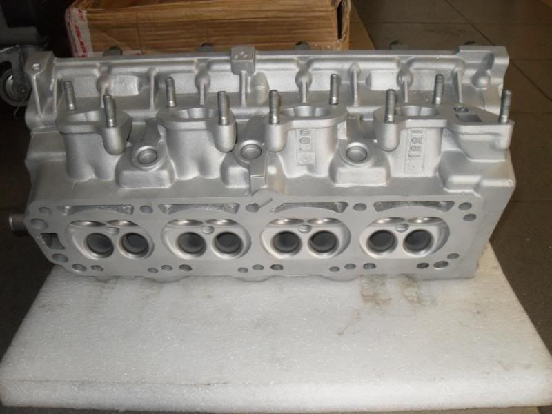

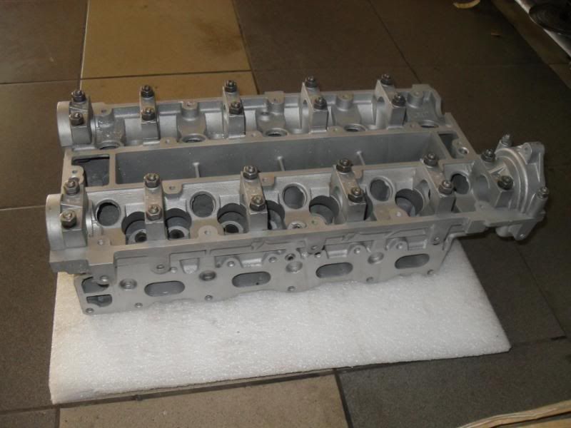

With the rebuild parts also came an original unskimmed coscast head which was in very good condition apart from the exterior looking a little grubby. Once my engine builder had looked it over and was happy with its condition he suggested having it vapour blasted to clean it up. A local company he knew of had the facilities to do this so I went by one day to have a chat with them to see what they could offer. They explained they put the heads through a vapour/aqua blasting procedure followed by a chemical clean and parrafin wash to finish them off. With that I left the head with them and went to collect it a week or so later. Here are the results........
http://i84.photobucket.com/albums/k2...g?t=1299433873
http://i84.photobucket.com/albums/k2...g?t=1299433905
http://i84.photobucket.com/albums/k2...g?t=1299433933
It has come back way better than I expected! By the time its been for a skim at the machine shop the head will be ready for assembly. On to a little more painting then.........

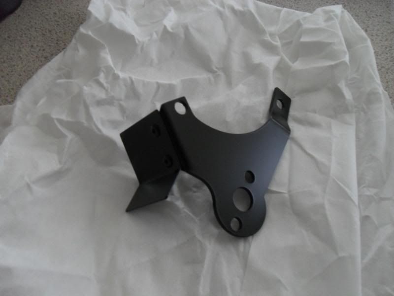

The new actuator bracket if you remember came polished and thats not something I wanted in the engine bay on this build so thats now black with a semi matt finish......

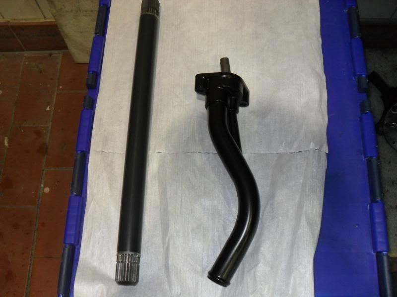

At the same time I had broken down the dummy shaft. The bracket assembly area is all black and the shaft is grey. Looks well now its all back together.......
http://i84.photobucket.com/albums/k2...g?t=1299434324
The Big block short shaft was also degreased and cleaned. Then the boot clips were removed so I could pull the boots back and paint the middle of the shaft without removing cv joints etc........

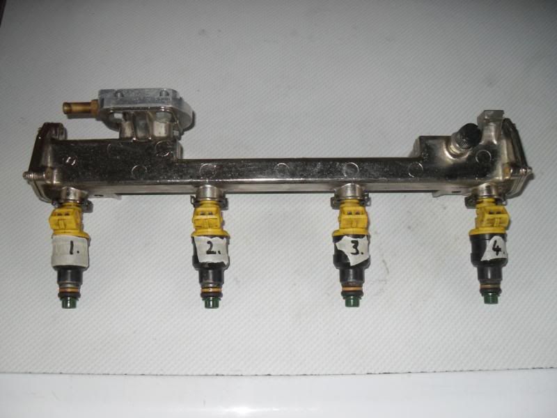

Whilst I was their I collected the fuel rail and labelled up the injectors as these are going to be ultrasonically checked and cleaned next week.......

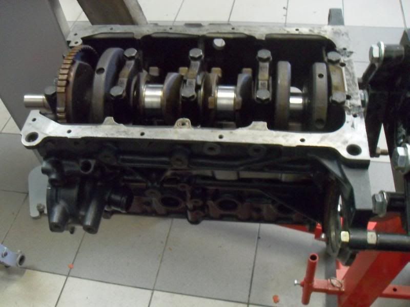

The block is now on the stand and a dry assembly has been started........

Originally Posted by Nick J
The above pics leave me with one question, hopefully you can help me with this.
Last year I restored a motorbike for a mate (1982 Kawasaki Z1000-J2, aircooled), which was nothing special - until it came to repainting the cylinder block and head.
<rant mode>
I first had the lot bead blasted with the finest grit possible. This gave a wonderful grey(ish) and very smooth finish.
I then brought this lot to a place where it was to be resprayed in a 1K heat resistant paint. The end result was horrid - the paint was an inch thick and started shifting as soon as I cleaned the block using a bit of degreaser.
So the lot was bead blasted again and I went to another place for an alledgedly "indestructible, scratch and heat resistant" coating. Too right the coating proved tough as nails, but the imbeciles decided to blast the block and head beforehand using what appeared to be bricks! The coating looks naff compared to the OEM coating on the crankcases. Not only that, but the heat treatment (required for the coating to work) caused the freshly honed cylinder liners to sink through the block (yes really!) and softened the alloy of the cylinder head to the point where ALL the threads had to be helicoiled. Not to mention the block got wet and the bores rusted all nice and brown. GRRR. :mad:
</rant mode>
Long story short: can you please give us the lowdown on the paint you used on your engine block? I'm sure it will be helpful to all of us in choosing the right paint for the job.
Sorry to hijack your thread Nick.
Thanks in advance and keep up the good work,
Niek
Cheers Adam, The head has indeed come back in exceptional condition I really didnt expect it to be anywhere near as good! :)Quote:
Originally Posted by Adam
Kev......... cheers pal!
Niek....... Thanks and Im sorry to hear of your misfortune in the past. Most of the products I used on the block were specific for the job and I havent used them before. Id prefer to make sure I have no future issues before advising people to use the same products if you see were Im coming from. If in six months time everything is fine then I'll gladly offer the information to anyone who wants it.

Hope the head was thoroughy cleaned out after blasting.
Heard some people leaving bits of grit in, and it getting into the oil etc.
Cheers Matt, The head was treated to aqua/vapour blasting so no form of grit was used at all. My engine builder wouldnt have had it any other way! I also spoke to cnc heads and they more or less use exactly the same process and really know their stuff.Quote:
