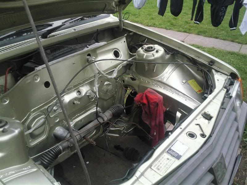

Just had about an hour on the car after work.
Top dollar service from Paints4u.com, cant recommend them enough. They even rang me to discuss the exact colour i needed!!!
And guess what, it even matches :cool:
http://img.photobucket.com/albums/v8...o026Medium.jpg
http://img.photobucket.com/albums/v8...o027Medium.jpg
http://img.photobucket.com/albums/v8...o028Medium.jpg
(ignore the overspray on the steering rack, a brand new one is going on)
The finish looks better in pics than in real life, but it will do me fine for this year, at least the colour is right :)
Might get the engine/box in this weekend :cool:
Very nice! Should have pulled the wiring out tho.
Just msn'ed you a let like.. So sign in.
glad u finally got there!!
Cheers :)
looking good adam.. keep up the good work..:thumb:
told ya :thumb:Quote:
Originally Posted by Adam
its a nice spray aswell :)
Nice work Ad, told you they were spot on mate, quite cheep to if your spraying out the gun too!
Coming on well! I like green :cool:
