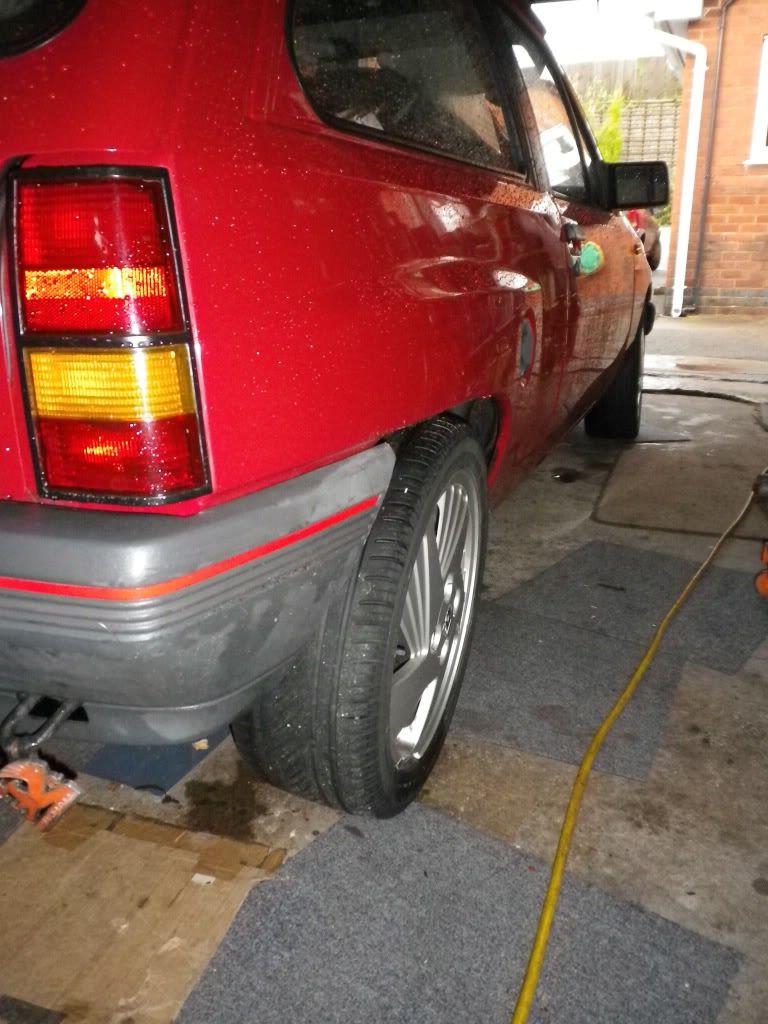

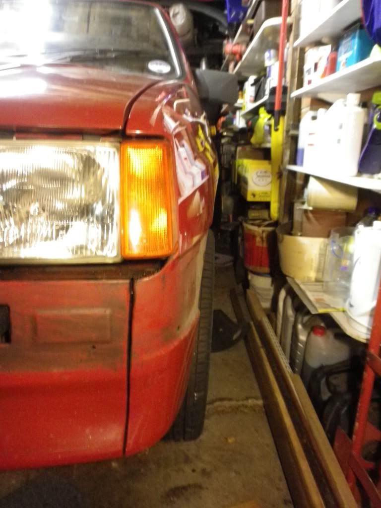

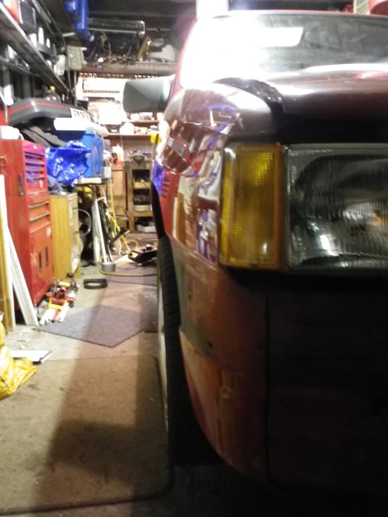

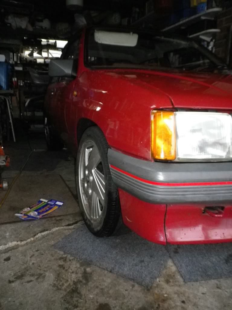

Right, damage, for all you 'soap opera' lot out there....
Bent wheels :cry:
http://i71.photobucket.com/albums/i1...IMGP0827-1.jpg
http://i71.photobucket.com/albums/i1...a/IMGP0829.jpg
http://i71.photobucket.com/albums/i1...a/IMGP0828.jpg

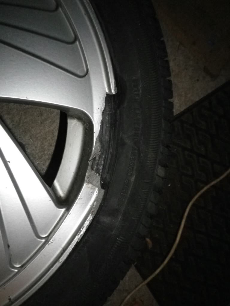

Smashed the alloy - tyre still up tho:
http://i71.photobucket.com/albums/i1...a/IMGP0830.jpg

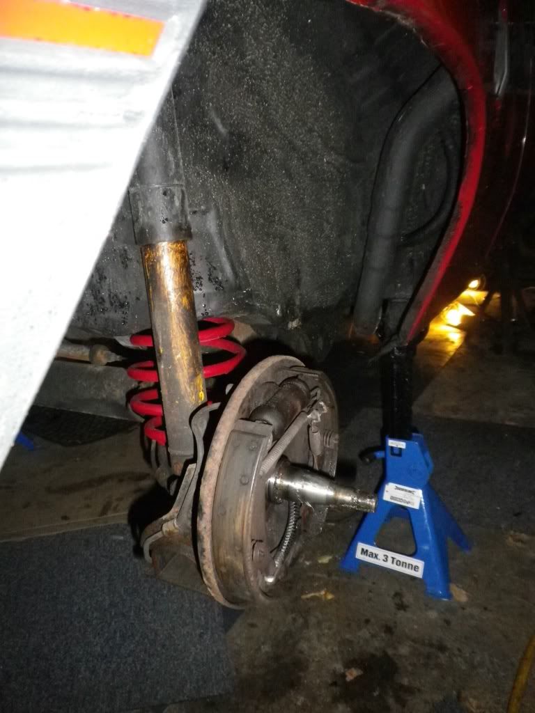

Don't think these are supposed to look like this:
http://i71.photobucket.com/albums/i1...a/IMGP0833.jpg
http://i71.photobucket.com/albums/i1...a/IMGP0834.jpg
http://i71.photobucket.com/albums/i1...a/IMGP0836.jpg

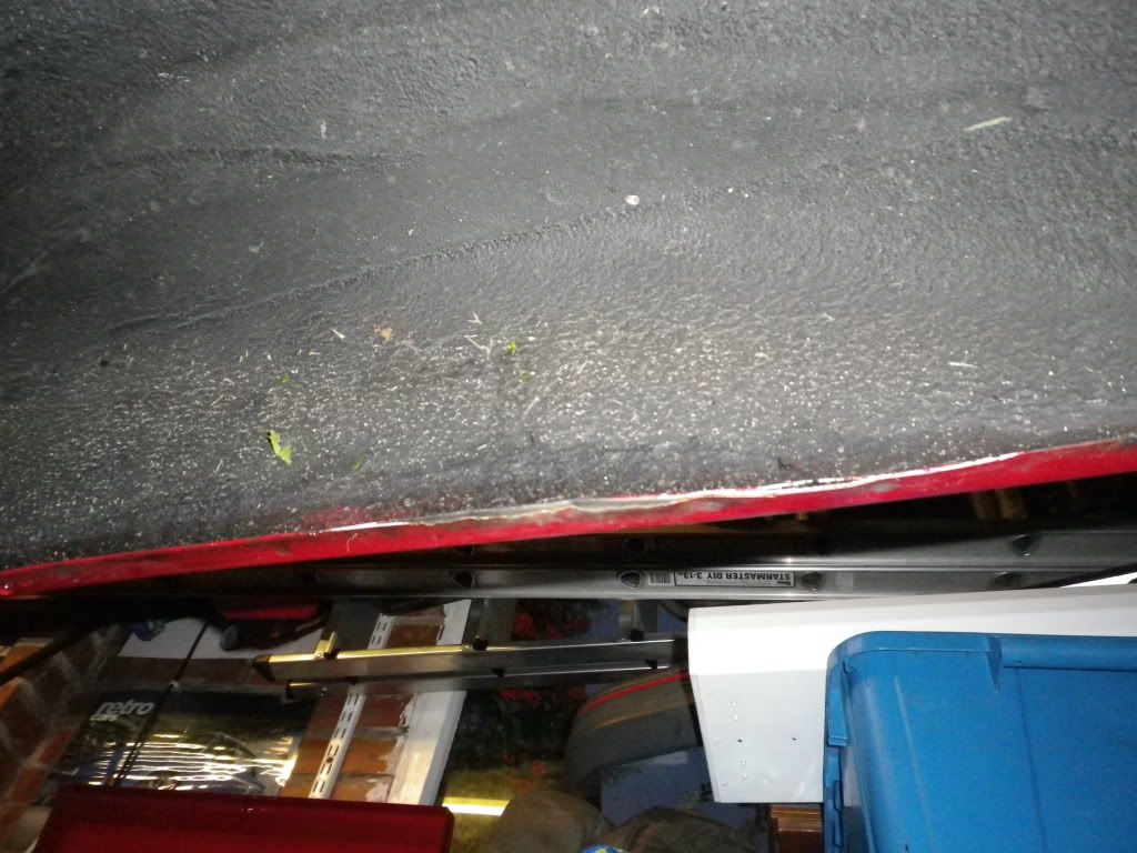

Fortunately the only bodywork damage:
http://i71.photobucket.com/albums/i1...a/IMGP0838.jpg

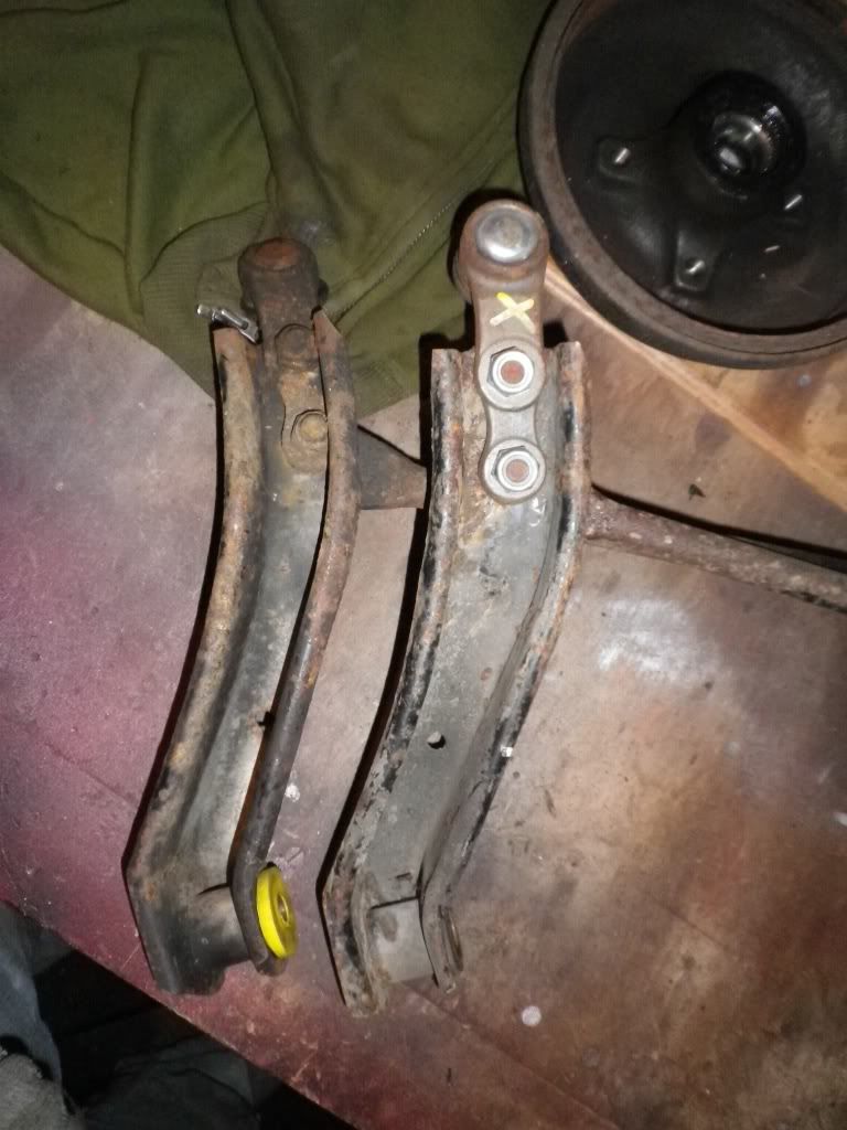

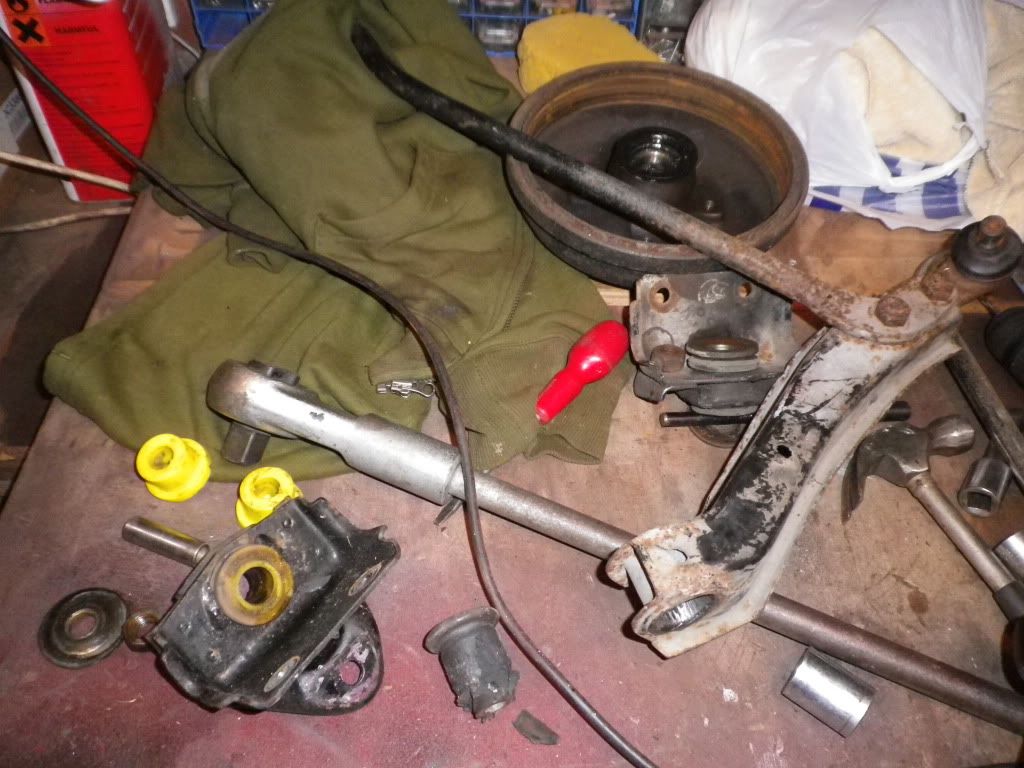

So I picked up some spares from mr draper and had 2 hrs on it last nite.
Spot the difference:
http://i71.photobucket.com/albums/i1...a/IMGP0841.jpg

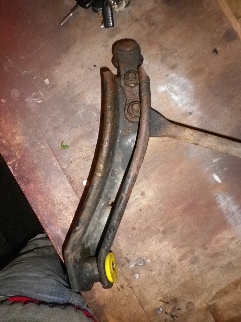

Stripped the polys off the old one, im going to use the whole thing from the new one just incase the old one was bent other than where it's obvious:
http://i71.photobucket.com/albums/i1...a/IMGP0843.jpg

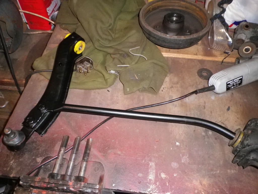

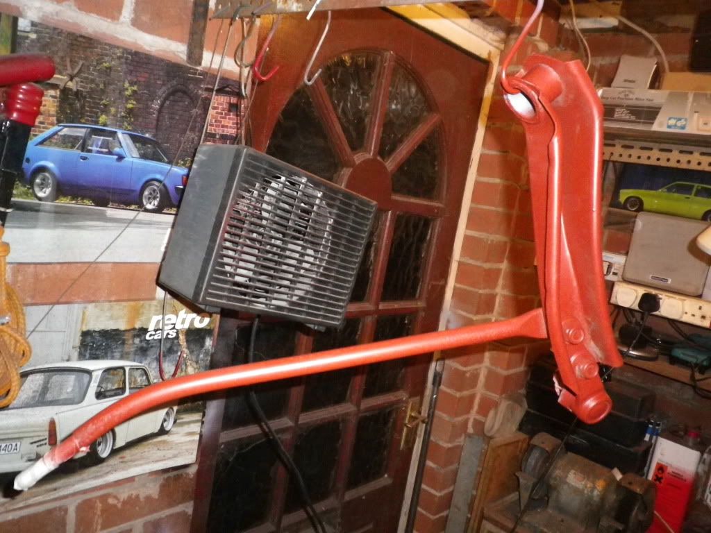

A couple of pics for lionel - a good wire wheel, some etch, red oxide and then satin black:
http://i71.photobucket.com/albums/i1...a/IMGP0844.jpg
http://i71.photobucket.com/albums/i1...a/IMGP0845.jpg

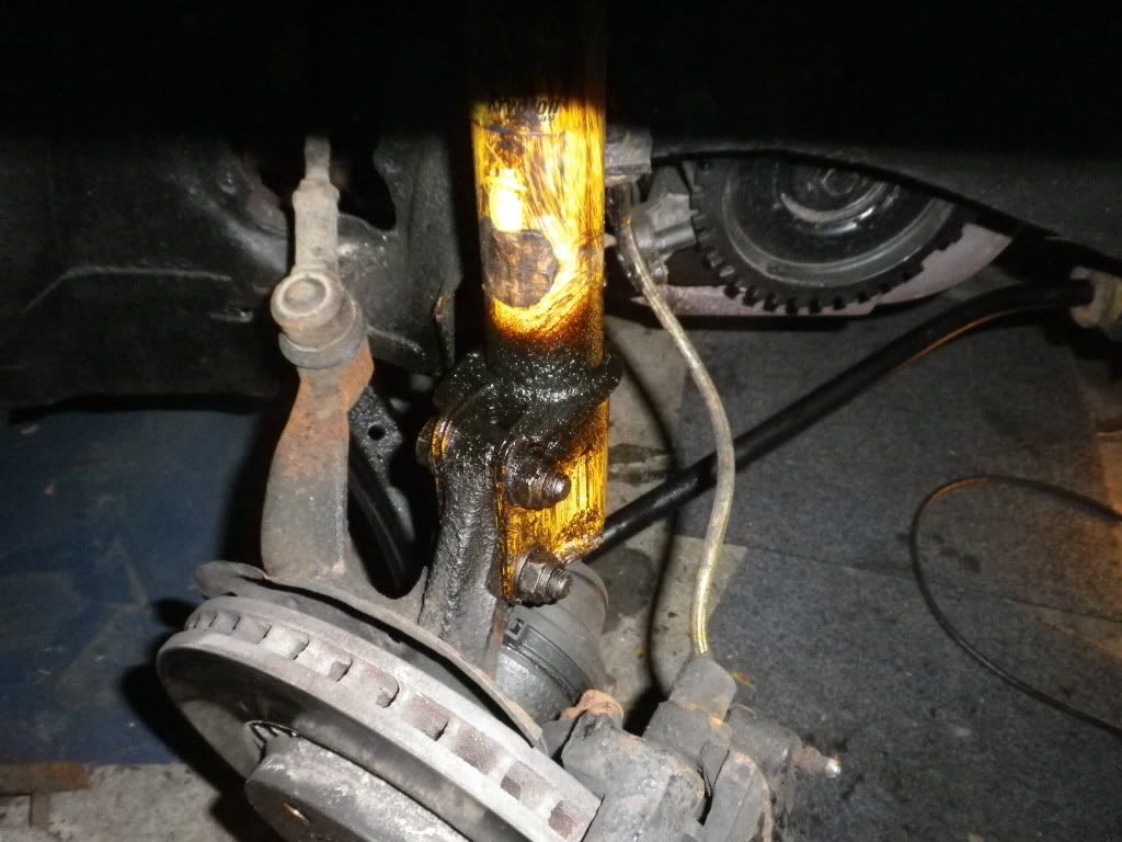

And fitted:
http://i71.photobucket.com/albums/i1...a/IMGP0847.jpg

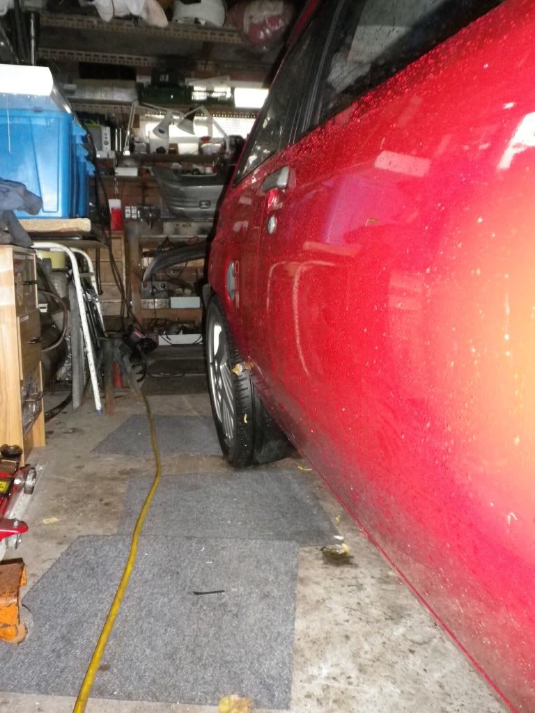

Won't know for sure until i measure it wheel centre fron the back but it looks a lot healthier now:
http://i71.photobucket.com/albums/i1...a/IMGP0851.jpg
http://i71.photobucket.com/albums/i1...a/IMGP0853.jpg

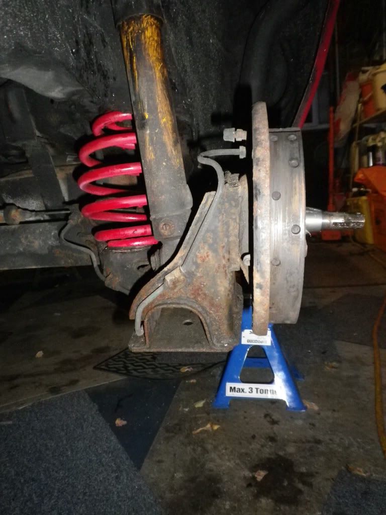

So i spent the next 40 mins or so getting the brake pipes off the beam - ******* job - and stripping the driver side hub - im just going to swap the passenger one straight over if i can get it off when the beam is off. So i left it at that......
