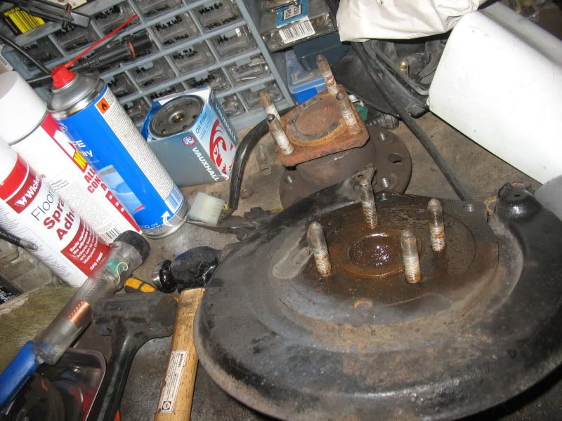

Broke my belt sander. So i thought i'll take them apart and then get them machined so it's a proper job... Then i got the funking dog.
So one side, loosen off the handbrake spinning adjuster, disc wont come off, beat off with beat blow hammer as bit of the handbrake shoes fall out... One shoe is jammed out some a unknown reason.. Needs to be replaced even tho they arn't that low... Stub axle taps out..
Other side, thinking the worse.. Disc comes off easy, tap the axle.. Don't move. 20mins of beating with a proper hammer, its not lose, but wont come off, maybe a burr of metal is holding it on.. Funking dog with it.
http://img.photobucket.com/albums/v3...n/IMG_0492.jpg
You need a bigger hammer son...
dont tap it whack it f lol
