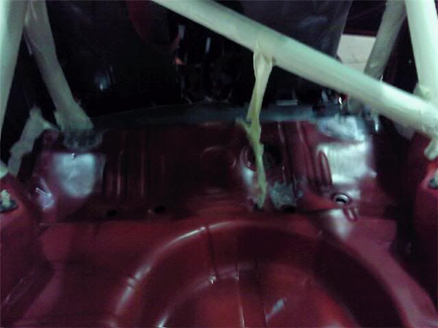

Bracket areas cleaned up and filled (sorry next few are phone photo's and a bit dark!).....
http://i84.photobucket.com/albums/k2...g?t=1241882764
http://i84.photobucket.com/albums/k2...g?t=1241883028

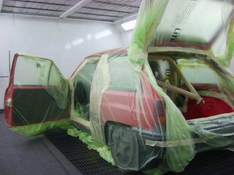

With the bracket areas cleaned up I gave them a quick coat of primer and then a few coats of aerosol red as a body up for saturday morning. Then I pulled the car into the booth and masked the inside off.....
http://i84.photobucket.com/albums/k2...g?t=1241883255
http://i84.photobucket.com/albums/k2...g?t=1241883284
http://i84.photobucket.com/albums/k2...g?t=1241883311

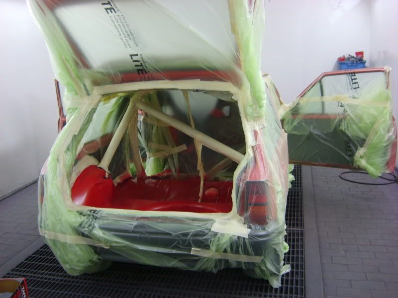

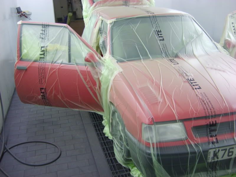

Back in work early saturday I got the rest of the car masked up and just had a quick scotch over the areas that had seen some aerosol action yesterday. (Didnt want any flaky paint later!) Once that was done a good blowgun and tack off and we were almost ready for paint......
http://i84.photobucket.com/albums/k2...g?t=1241884033
http://i84.photobucket.com/albums/k2...g?t=1241884128
http://i84.photobucket.com/albums/k2...g?t=1241884151
http://i84.photobucket.com/albums/k2...g?t=1241884170
http://i84.photobucket.com/albums/k2...g?t=1241884310

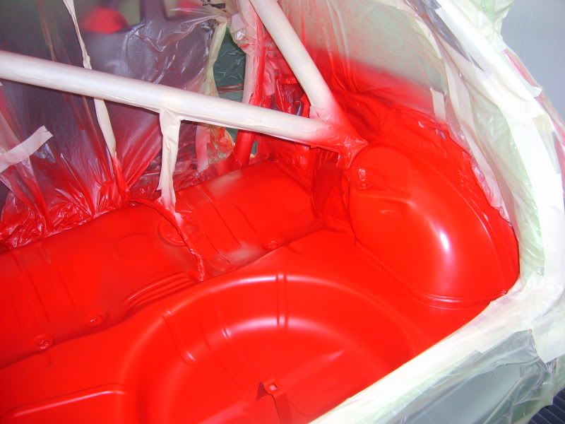

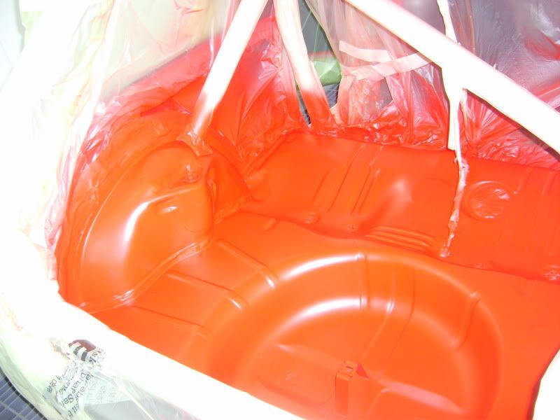

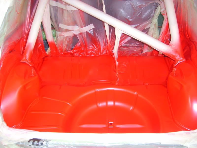

All based up........
http://i84.photobucket.com/albums/k2...g?t=1241884608
http://i84.photobucket.com/albums/k2...g?t=1241884634
http://i84.photobucket.com/albums/k2...g?t=1241884713

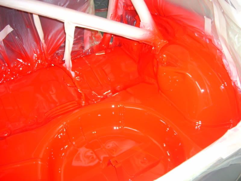

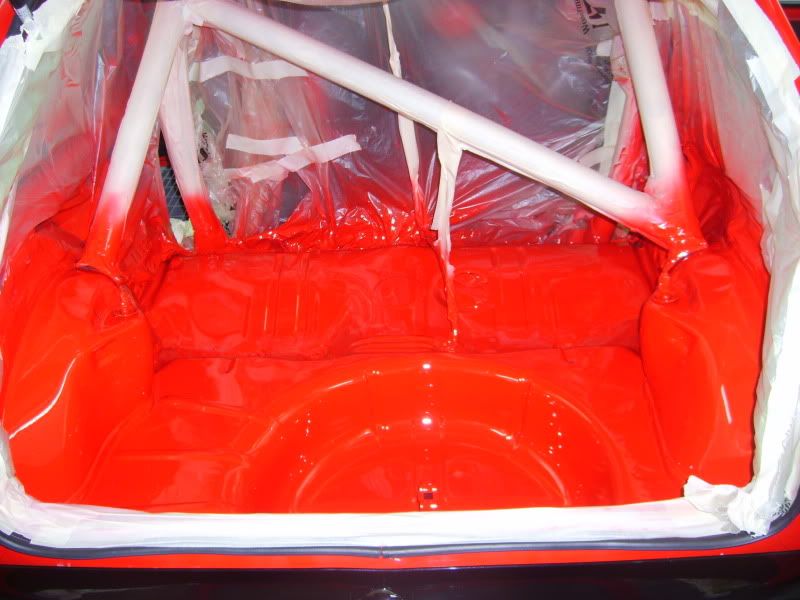

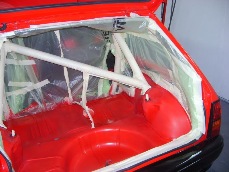

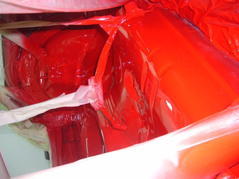

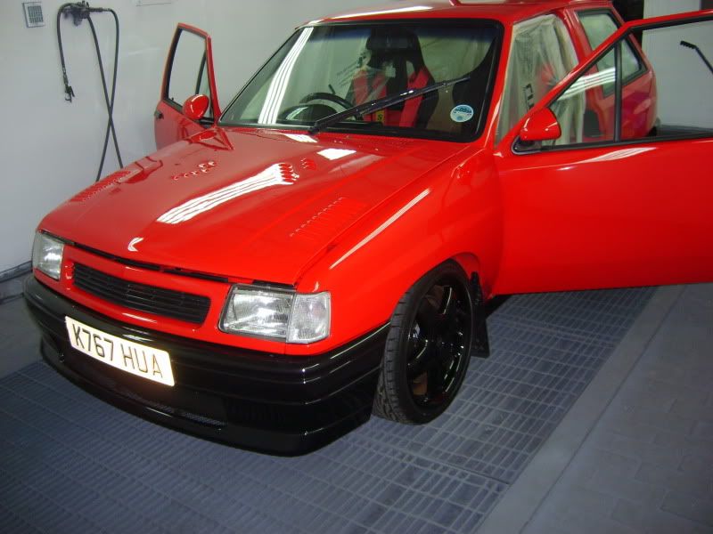

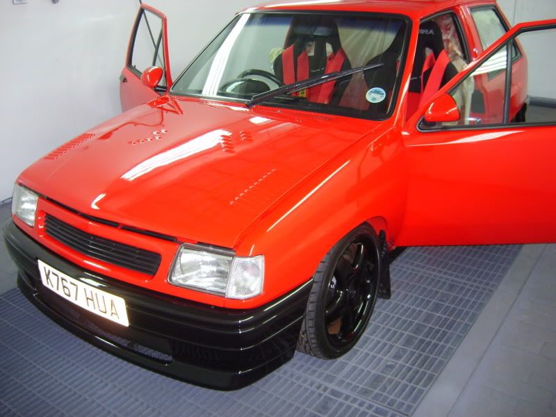

Then the finali being a couple of coats of lacqeur......
http://i84.photobucket.com/albums/k2...g?t=1241884763
http://i84.photobucket.com/albums/k2...g?t=1241884792
http://i84.photobucket.com/albums/k2...g?t=1241884877
http://i84.photobucket.com/albums/k2...g?t=1241884960
Looking uber shiney.......:)

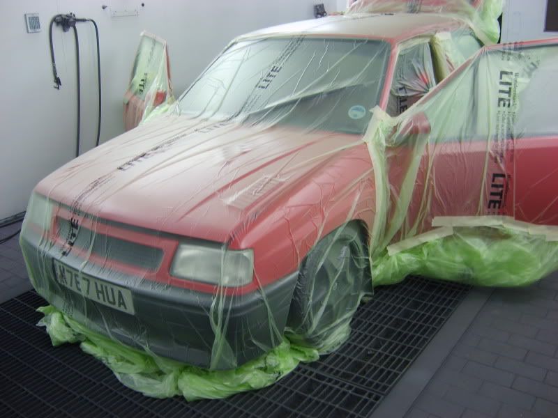

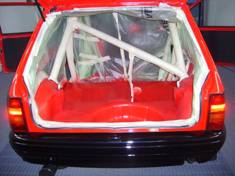

With the inside painted I still had a thought there may be some unwanted moisture behind trims etc so I thought it best to demask the exterior of the car and let it airdry until tommorow when I can demask the inside and get the car home....
http://i84.photobucket.com/albums/k2...g?t=1241885312
And how the car was left until tommorow...
http://i84.photobucket.com/albums/k2...g?t=1241885367
Hope you all like. Its the first time Ive had a nova almost fully stripped and painted on the inside. But I think it looks really well plus I've done a little weight saving! Lets hope I can put up with the noise! lol Thats all for today.
