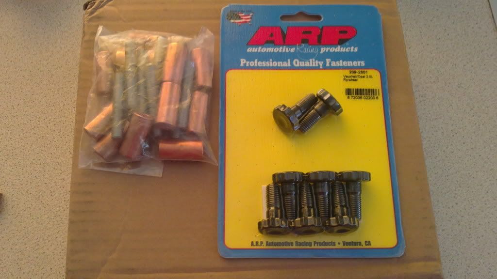

received a few things today, the correct cambelt kit, exhaust stud kit and ARP flywheel bolts.
http://i193.photobucket.com/albums/z...9042011179.jpg

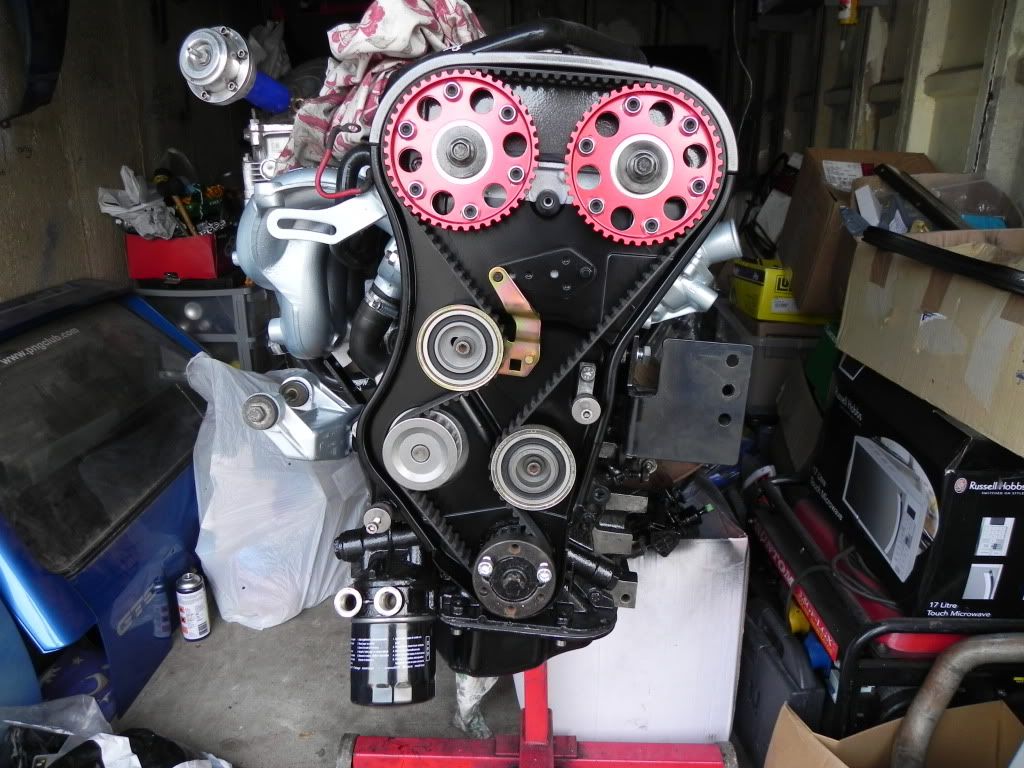

armed with these i went down to my garages. found a problem with the TX autosport vernier pulleys though, they dont have the correct timing marks on them. one didnt have anything and the other had a mark in the wrong tooth.
i made my own marks going by the standard pulleys and set the timing like that. fitted the belt, tensioner and guide pulley.
http://i193.photobucket.com/albums/z...8/DSCN3047.jpg
have got the XE inlet cam on standard markings for now, when i have it dyno'd i can get them to play around for max power. still getting a gain from it being on standard timing.

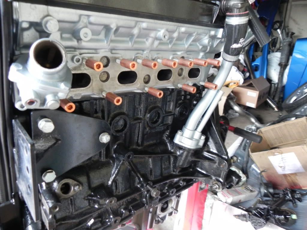

after that i fitted the exhaust stud kit. rather tasty.
http://i193.photobucket.com/albums/z...8/DSCN3052.jpg

Ahhhhh have been looking for that exhaust stud kit, where from? lol
a guy over on mig. ordered yesterday and came today.
http://www.migweb.co.uk/forums/items...arts-more.html
50pound is alot of money but it looks good and my head was off a XE so didnt have the correct studs.
You're right it is a lot of money lol Shall check on eBay see if I can find some, maybe even go to Vaux and ask there see what it is with trade discount.
Either that or some copper effect paint lol
i rang vaux before i bough it. was like 1.28 per stud and 2.24 per copper dude.
if you only need the copper nuts then should work out cheaper. you'll need twelve in total.
That's £42.24 from what you said, is that with trade discount? Pretty sure the studs are ok but I'll need to double check.
£50.68 with vat. ;)
i presume so, i rang up and said bruce from saint martins motor services, i am after....
