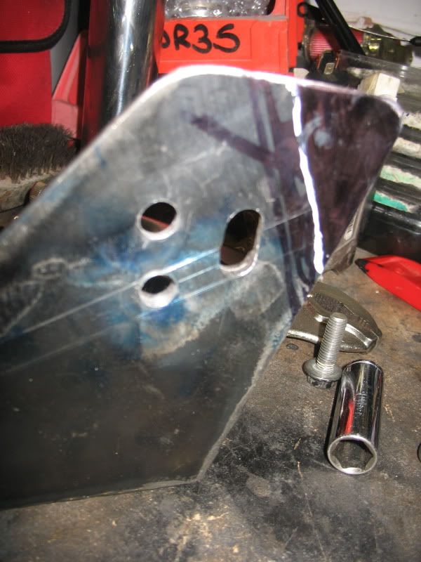

Working out where the holes where was a lil tricky..
http://img.photobucket.com/albums/v3...n/IMG_0396.jpg

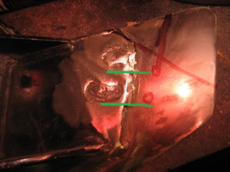

Did it, drilled holes, found out i got the angle wrong so had to re-drill one and slot the other a bit. Green lines are cause i was a little worried the holes where lower than before, but that's cause i have jacked the box up a bit higher too.

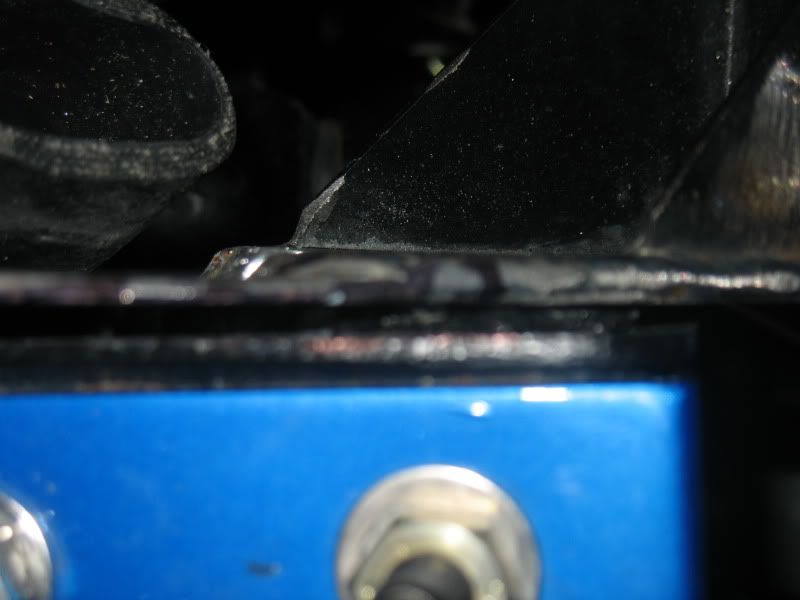

Now because i way over speced the mount there was a bit of trimming need.
http://img.photobucket.com/albums/v3...n/IMG_0399.jpg
But that is good, as i can use the excess as a shoulder for the top hole, as the hole it right center on the weld to the metal is two different heights. (welding it on tomoz in place of the washers)

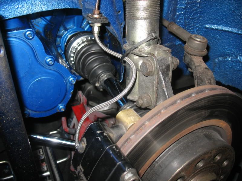

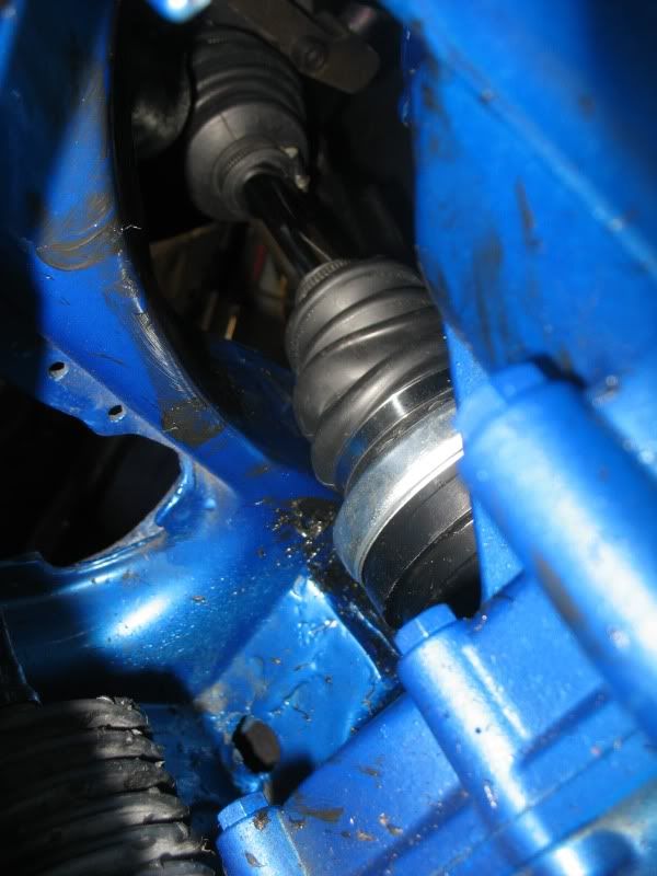

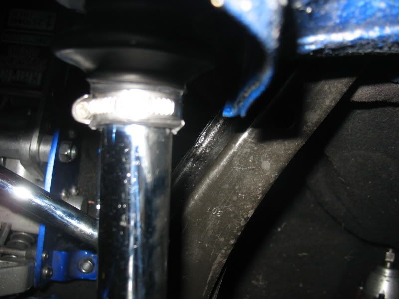

Now with the mount on, the shaft is... Straight.

Hard to see i know, boot has a kink too which i need to adjust.

Nice shaft.
