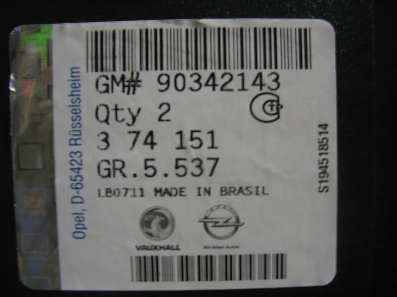

Ordered a new oil seal (£22 from gm all in, £11 from ebay... Well i have a spare)
Fitted
http://img.photobucket.com/albums/v3...n/IMG_0367.jpg
Part number of the seal.

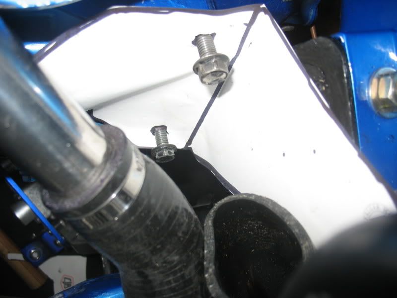

Got the shaft back in,Fitted my PAD mount..
http://img.photobucket.com/albums/v3...n/IMG_0369.jpg
http://img.photobucket.com/albums/v3...n/IMG_0370.jpg
Worked out when it should fit too..
Got a scissor jack in between the box and the cross member, starting winding it till...
http://img.photobucket.com/albums/v3...n/IMG_0377.jpg
http://img.photobucket.com/albums/v3...n/IMG_0372.jpg
Will go a bit more, but happy with that. With a bit of adjustment in the mount i should get it 100% straight... So i can drop the mount off tomoz.

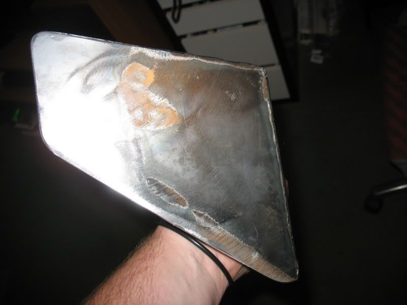

Picked the mount up, dropped it off at 11ish, picked it up at 2. After talking to the fab man, about getting a mount made up. He said tbh plating the side that needs extending will be just as strong. Same we adding on the fines. As 70% will will be on the main body of the mount it wouldn't be needed. Knowing he knows what he's doing i left him too it.
The mount.. Had the holes welded up for strength and so it looks better.
http://img.photobucket.com/albums/v3...n/IMG_0381.jpg
http://img.photobucket.com/albums/v3...n/IMG_0382.jpg
Nice welding, lots of penetration
http://img.photobucket.com/albums/v3...n/IMG_0383.jpg
http://img.photobucket.com/albums/v3...n/IMG_0384.jpg
Gonna refit tomoz and work out where to drill the new holes.
