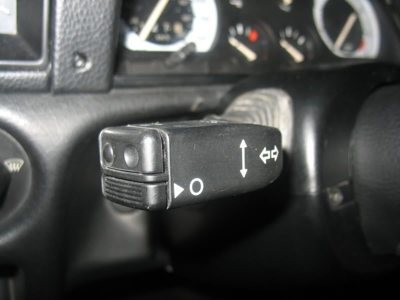

But Billing came to the rescue and i got a brand new stalk can side, with the added bonus of these...
http://img.photobucket.com/albums/v3...n/IMG_0165.jpg
Bit of hiding and fiddling to get the other end in and finished yet tho.

What's the extra buttons on the stalk?
Bumper looks fine, maybe a bit of mesh in it? I reckon you should tart it up and paint it so it still looks pretty on track!
Oh sorry, its for cruise. Not meshing it, if i can get another i will, so all the holes match.

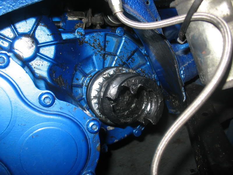

So set about remove the knackered cv today..
Said damage.
http://img.photobucket.com/albums/v3...n/IMG_0356.jpg
Ah see where this is going...
http://img.photobucket.com/albums/v3...n/IMG_0357.jpg
This became a *******.
http://img.photobucket.com/albums/v3...n/IMG_0358.jpg

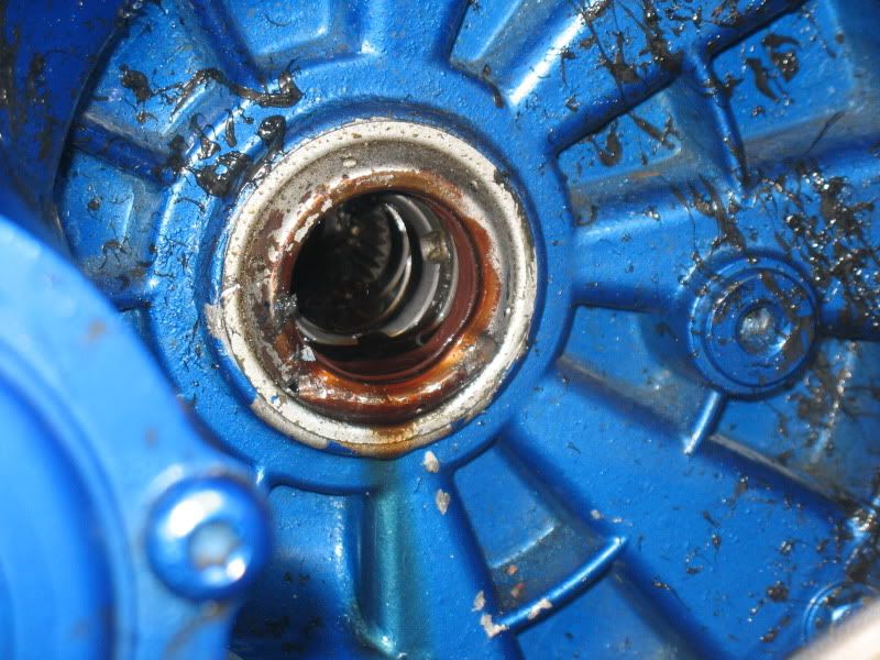

Had to use a crowbar to get it out, as the cv was new the curclip was very strong, so doing that i've damaged the oil seal. Bugger.
http://img.photobucket.com/albums/v3...n/IMG_0362.jpg
Ordered one from Ebay, and will order two at Vauxhall tomoz. As you can see that one was 2nd hand and so is the other side.

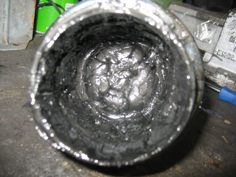

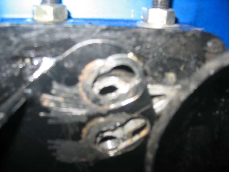

Boot off...
http://img.photobucket.com/albums/v3...n/IMG_0360.jpg
Ah, i see what's happened...
http://img.photobucket.com/albums/v3...n/IMG_0359.jpg
Cage gone, bearings gone, grease... All over my frigging engine bay.

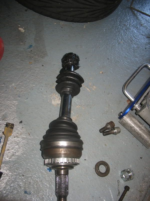

Via work i got two more cvs in, one to go on the car the other just to keep as a spare.
Built the shaft back up.
http://img.photobucket.com/albums/v3...n/IMG_0361.jpg

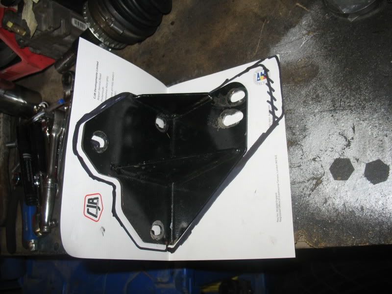

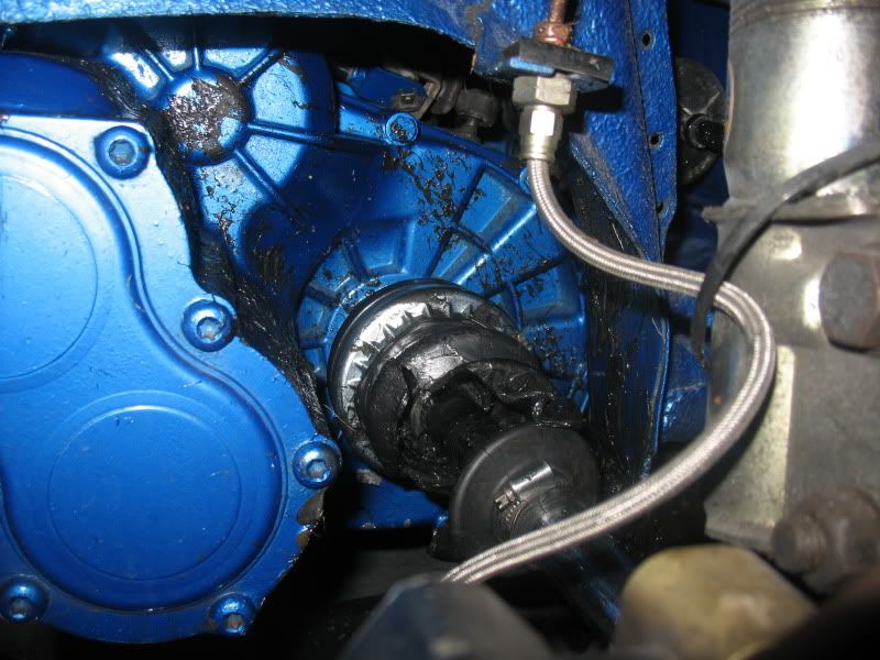

From there i moved to the gearbox mount issues. Boost pipes off, unto bolts mount to car...
http://img.photobucket.com/albums/v3...n/IMG_0363.jpg
Doesn't look to far out... This with with a jack holding the box up, the rear mount lose, with a bar in thru the hub to the gear box (will do it correctly with the shaft when i've replaced the seal)

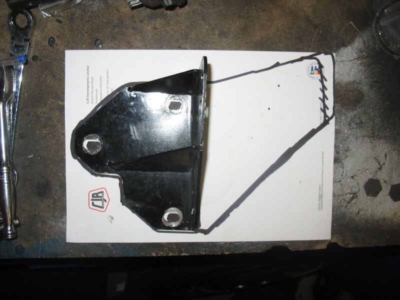

So measure, remove mount, make template for new mount to be made up.
http://img.photobucket.com/albums/v3...n/IMG_0365.jpg
Extra metal added in to move box back..
http://img.photobucket.com/albums/v3...n/IMG_0364.jpg
Template made,
http://img.photobucket.com/albums/v3...n/IMG_0366.jpg
Gonna take this to the guy that does metal fab tomoz, to get him to build me a new mount.

f28 and cv joints love snapping no matter what you do!! and as for the engine mount, i had the same problem with mine! make sure you take at least 4 cvs when you next go out on tracklol
