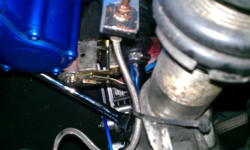

But felt in the mood today, so jacked it up and replaced the Inner CV boot that was leaking, while in there i had a thought on my shaft angle/mount probs.
Undid the rear mount of the box (did it off the car before) this allowed me to move the box more on the slotted front mount. Moved it back as much as i could with just a ratchet strap. Got about an inch of move ment, which has taken quite alot of angle out of the shaft which is good.
Pics arn't the best, this one looks alot worth than it is.
http://img.photobucket.com/albums/v3...haftangel1.jpg
Better than before.
http://img.photobucket.com/albums/v3...haftangel5.jpg
http://img.photobucket.com/albums/v3...haftangel2.jpg

benn,regarding the gearbox,
can you space the front mount form the box slightly to give it a little more to the rear, reason is i did this on the xe cabriolet when i fitted solid mounts as the cam cover was itting the chassis mount worked treat for me,i spaced mine with 2 washers on each bolt,maybe worth a trip to bapps for some uprated bolts too though with 2 mounts taking the torque i think spaced with longer bolts may be the answer
