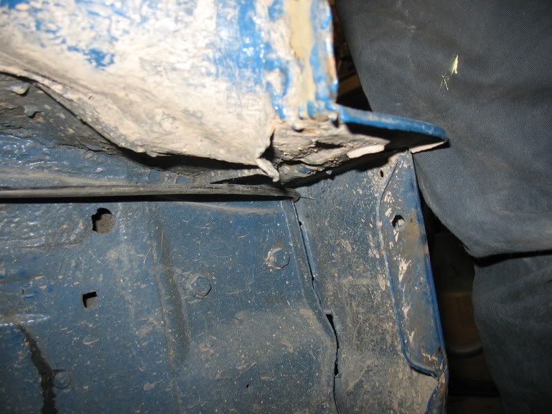

Spent the day getting the system off.. What a c**t. Cause of the size of the tubing i've had to jack the car up with the beam dropped down and undo the shocks to make cleanace.
Then i could drop the tank down.
Found of why it was leaking fuel...lol and why there was a smell of fuel in the car...
http://img.photobucket.com/albums/v3...tes/day210.jpg
Found some of the fuel hose i got from work.. Funking stuffs a tiny bit to small. So am gonna have to buy some.. GGrrrr
This came to day, nice fast delivery. We sell Fuel parts stuff at work, the pump is £150ish pounds.. Got this off ebay for £49.99. On the site its a own brand pump, but is right for a 2lt Cav, Cally, Astra and a few Bwms too. So the prices wasn't bad for a own brand one, but a bargain for a fuel parts pump.

my over fill hose has done that on my tank, how do you get it off, as it goes through the body work doesnt it.
and is it a tank out jobby?
Yeah tank needs dropping down.
The filler neck breather passes through a plastic gromet in the chassis leg visible through the arch. The main issue with that pipe is that it is moulded with a 90deg at the end where it comes off the tank. If you are just using plain replacement fuel hose, it will kink & not breathe. :thumb:Quote:
