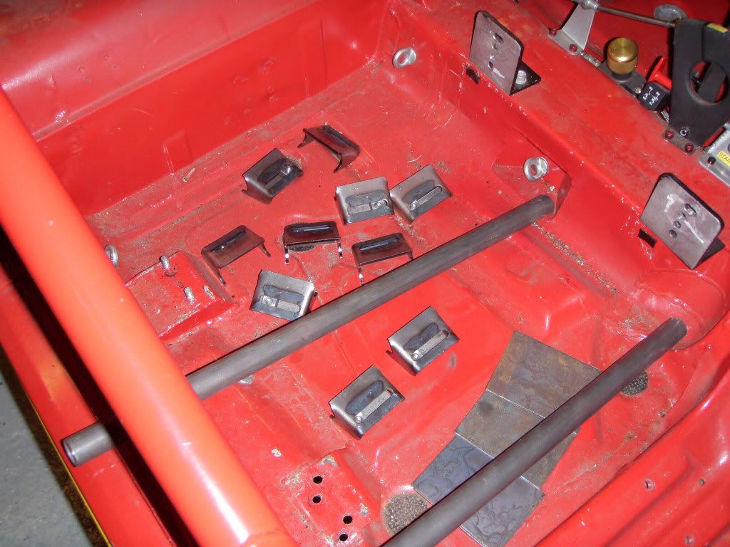

No actual progress at all in the last few days, but the new seat rails are now with me and ready to be cut to size and welded in place;

Really must get on with it as it's meant to be going off to have all the paint stripped soon, and clearly al the metalwork needs to be done by then.

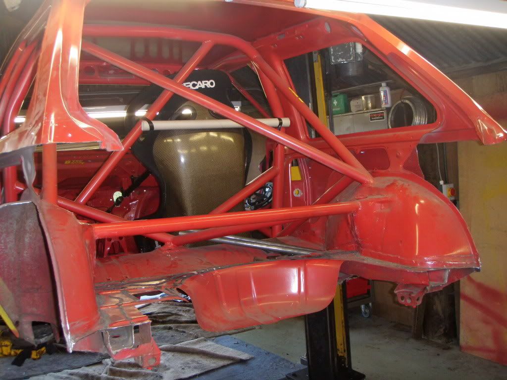

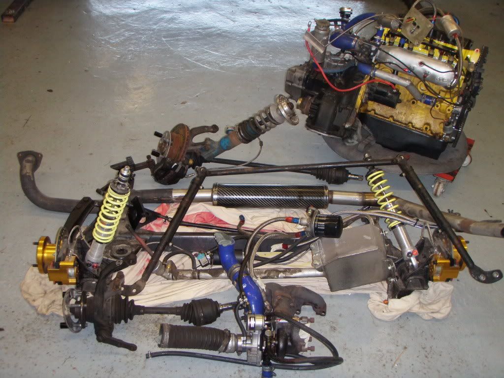

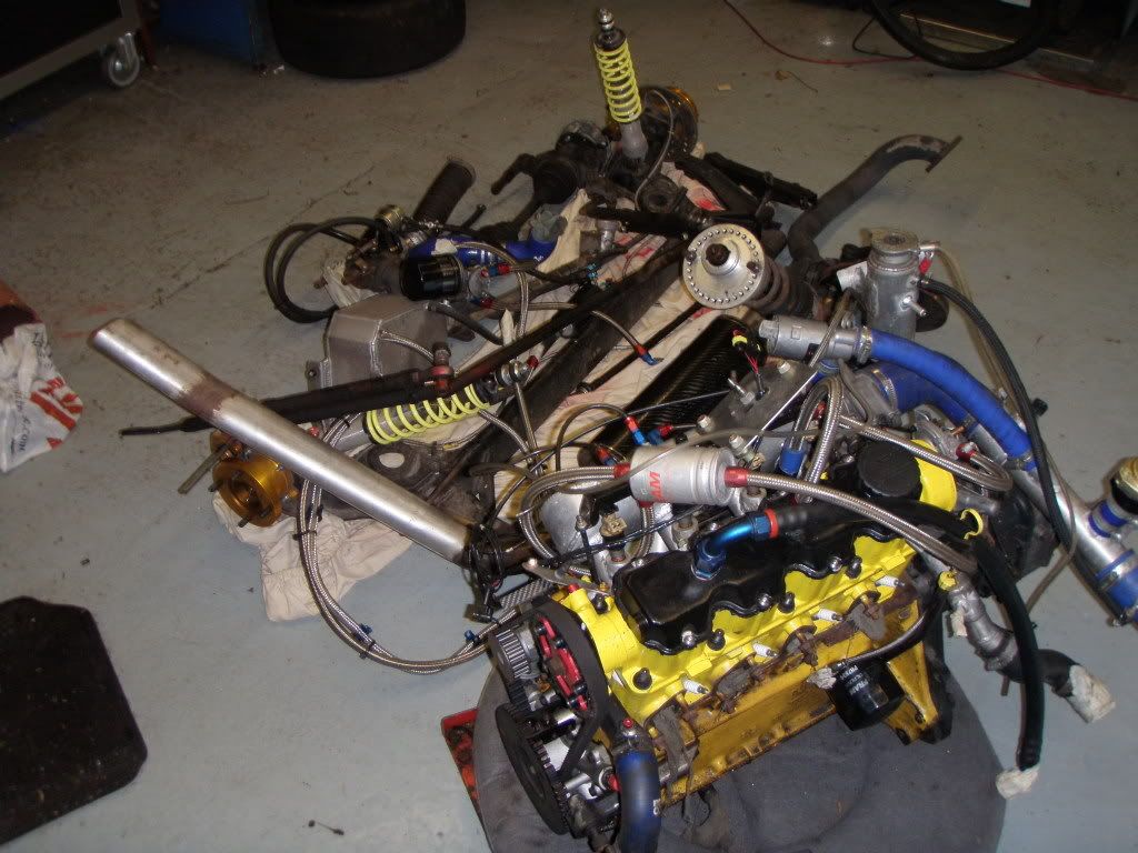

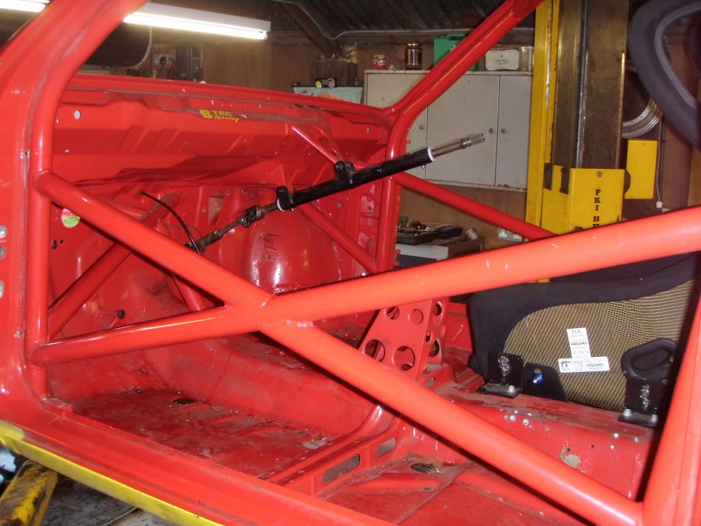

No going back now........I've spent the weekend stripping the car down to the bare bones;

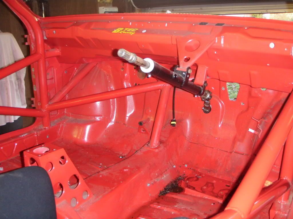

Various bits of cutting and welding to do now, including fitting the new seat rails and fittings for the harness.
There's also some tidying up to do of various bits I cut away previously, and I'm debating whether to weld up all the 'bung' holes in the floorpan. Previously I had covered them with bits of carbon fibre sheet and tape, but it's not very resilient to attack from stones/weather etc. Only problem is the weight of the steel circles I'd have to weld in instead.

I've also been tinkering around with the pedal box, fitting an AP 'short' cylinder for the clutch, and I've modified the F1 carbon fibre pedal to be the new clutch pedal;

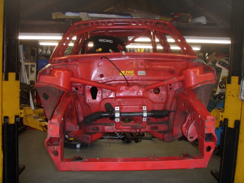

It was a good suggestion to weigh the bare shell, thanks.
The answer is................184kg.
That is totally stripped of every last nut and bolt, literally the only thing left in it is the steering column (which is only in there so I can get the positioning of the seat rails correct).
