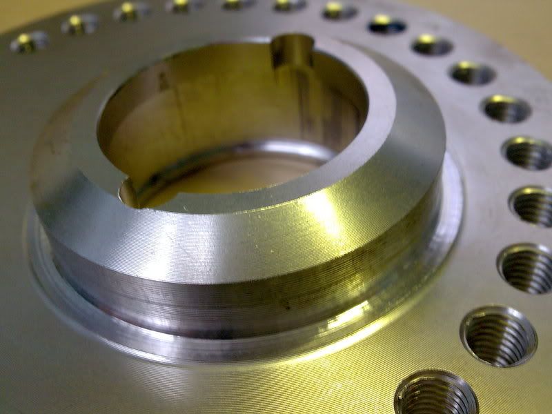

I've had my Topmounts machined down by 3.5mm to get a bit more camber
http://img.photobucket.com/albums/v3...Image050-2.jpg

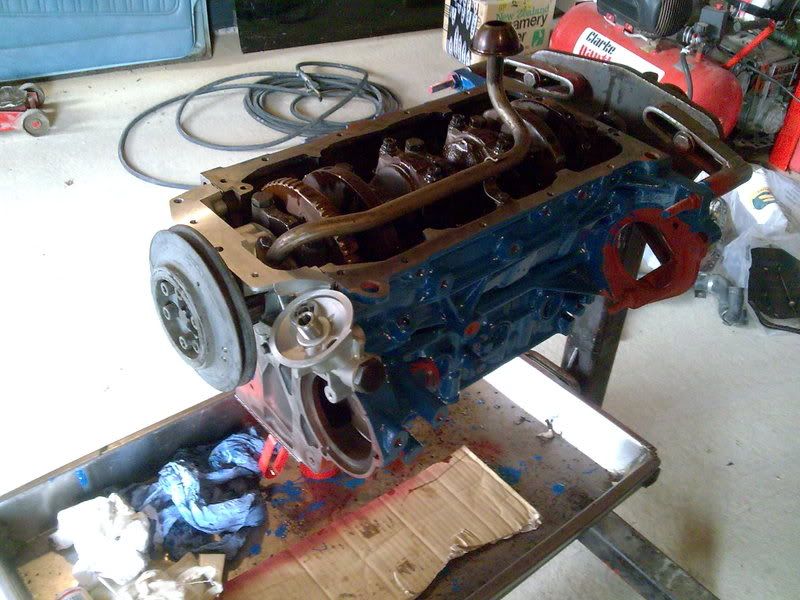

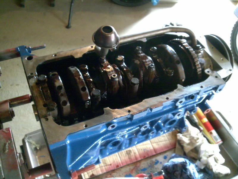

Couple of pics of the bottom end in progress
http://img.photobucket.com/albums/v3...a/Image051.jpg
http://img.photobucket.com/albums/v3...Image052-2.jpg
Balanced bottom end with ARP rod bolts. Now has sump on, cambelt backplate and pulleys. Then started on matching the inlet manifold and head ports. Didn't get any pics though, sorry :(

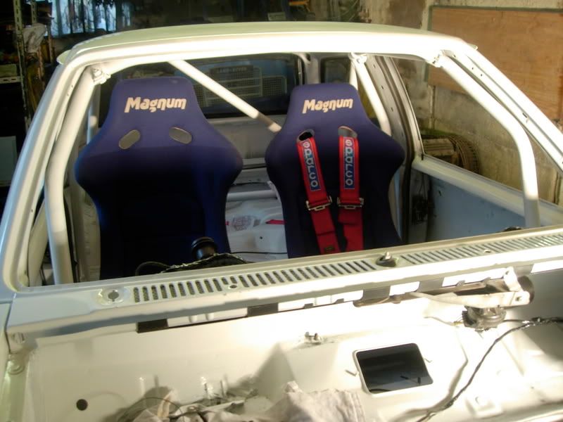

Drivers seats in and harness's all sorted
Left the harness's out though as the seats come back out for easier access!

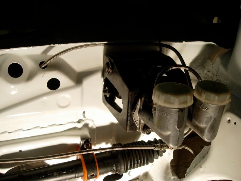

Internal brake line route into cabin
Need to get a grommet for the hole too
http://img.photobucket.com/albums/v3...a/DSCN2390.jpg

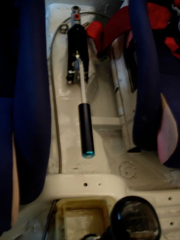

Handbrake in place
http://img.photobucket.com/albums/v3...a/DSCN2394.jpg
