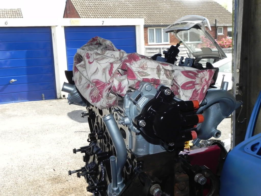

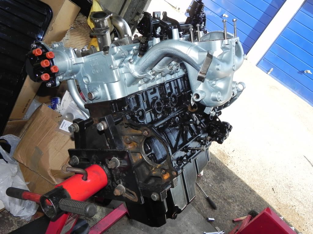

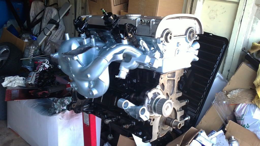

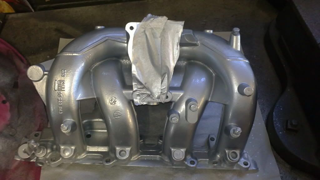

last week saw more engine work take place. wire wheeled the inlet manifold ready for paint, wasnt to badly corroded.
http://i193.photobucket.com/albums/z...6042011162.jpg
after a prime and paint...
http://i193.photobucket.com/albums/z...6042011163.jpg
also painted the fuel rail and accelerator cable bracket black. im awaiting injectors so couldnt fit that down. got the inlet on tho.
http://i193.photobucket.com/albums/z...7042011167.jpg
http://i193.photobucket.com/albums/z...8/DSCN2511.jpg

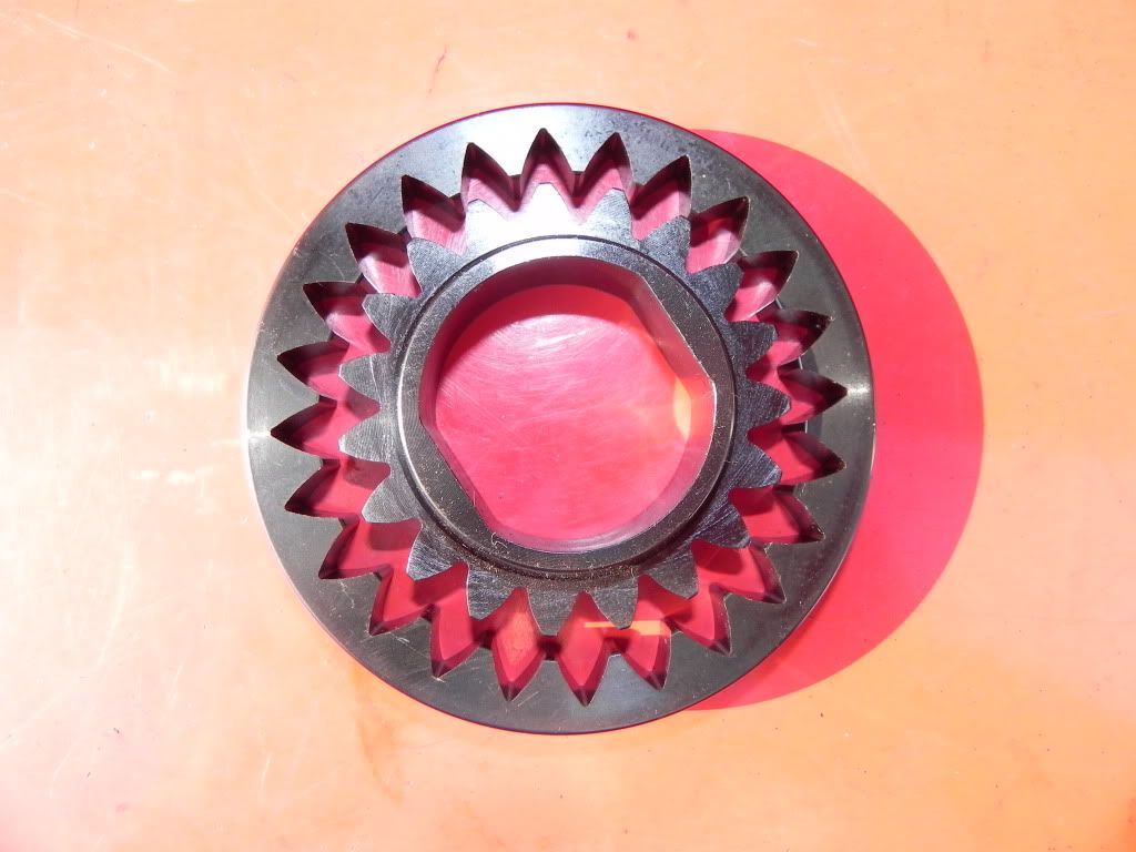

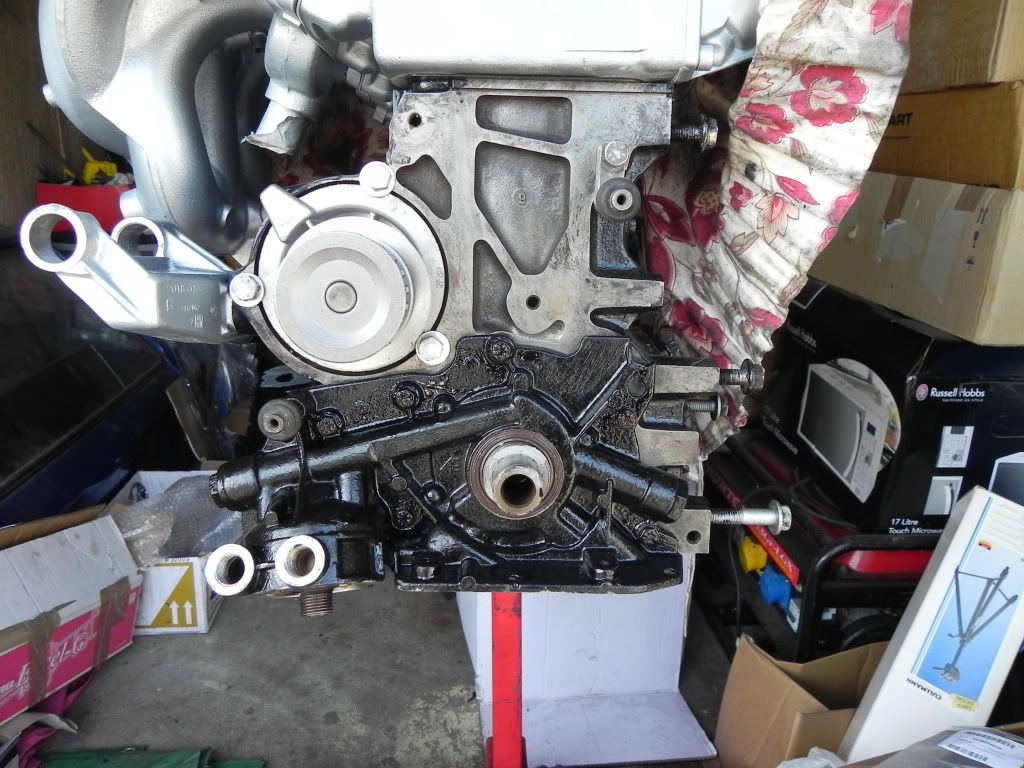

the steel oil pump gears arrived from phillip off here, got them fitted in the pump with a new front seal.
http://i193.photobucket.com/albums/z...8/DSCN2498.jpg
http://i193.photobucket.com/albums/z...8/DSCN2499.jpg
dizzy cap painted black and attached with stainless cap head bolts.
http://i193.photobucket.com/albums/z...8/DSCN2503.jpg
i have also painted the sump but i forgot to take pics of the progress, but with that painted i could move on with fitting it.
so, i bent back the appropriate tag on the 8valve baffle/sump gasket.
http://i193.photobucket.com/albums/z...8/DSCN2504.jpg

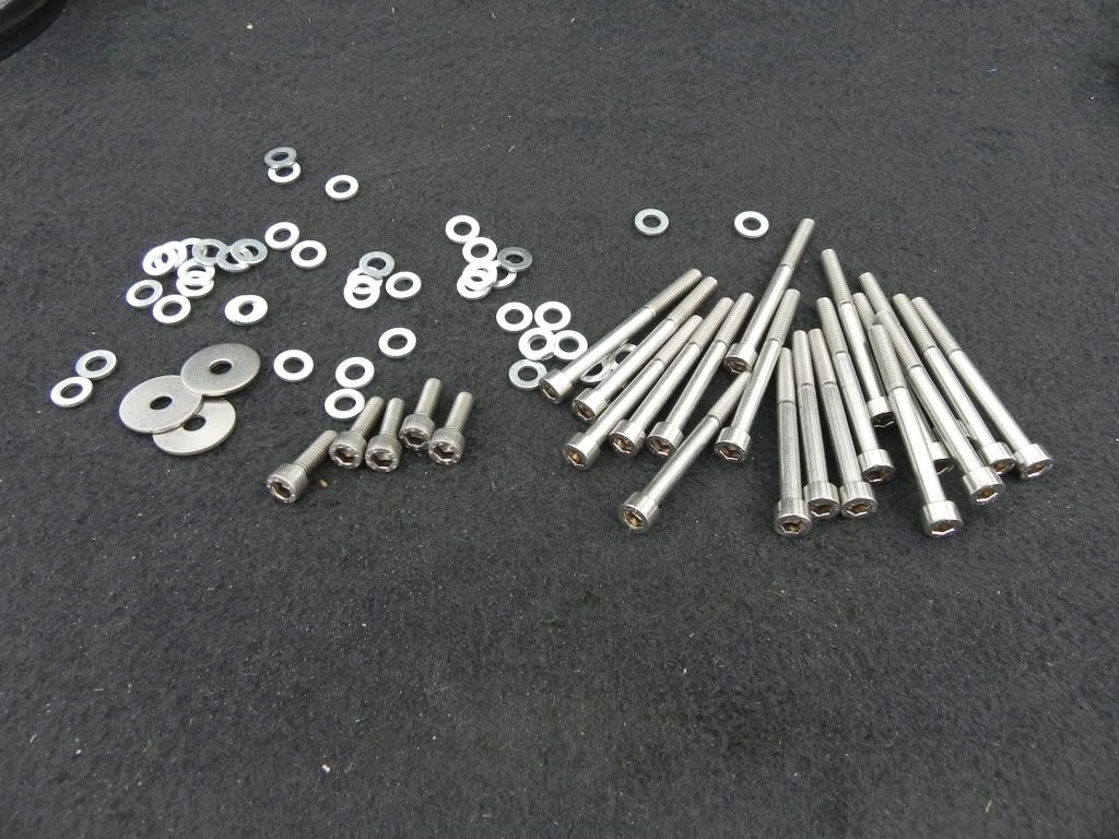

fitted the sump and cambelt back plate on, still awaiting on my cambelt kit to come from LUK. bought all the stainless sump bolts for a quid from a company we deal with at work.
http://i193.photobucket.com/albums/z...8/DSCN2505.jpg
http://i193.photobucket.com/albums/z...8/DSCN2506.jpg

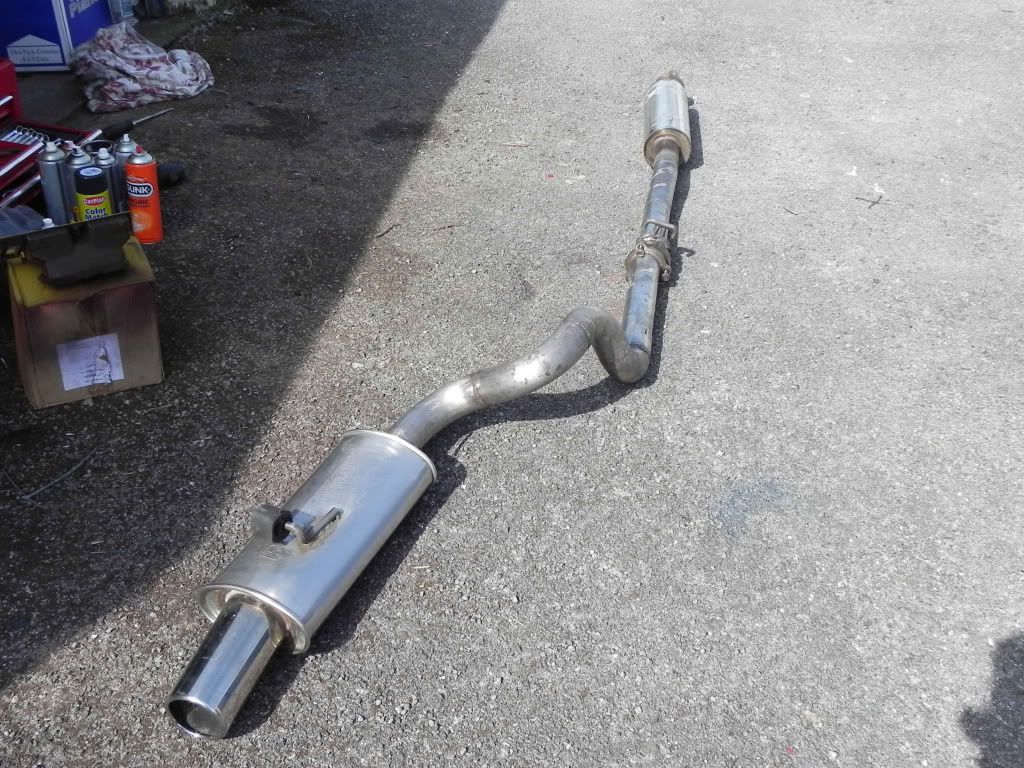

received this from tony k, big thanks to him
http://i193.photobucket.com/albums/z...8/DSCN2512.jpg
a 2.5 inch system made by powerflow, going to need to be modified to attach my 3 inch tx downpipe. be best to modify the downpipe as that needs sorting to fit a nova anywho.

Very nice dude, liking it a lot. Where did you get the baffle plate from? I'm after an 8v one myself, think I saw one in TV magazine.
You gotta love VHT silver paint on the inlet, works a treat ;)

Glad your happy with the exhaust mate,engine is looking good,some good work going on there,how much was the steel gears off Phillip ppme if
You want
Cheers
Tony
pm sent.

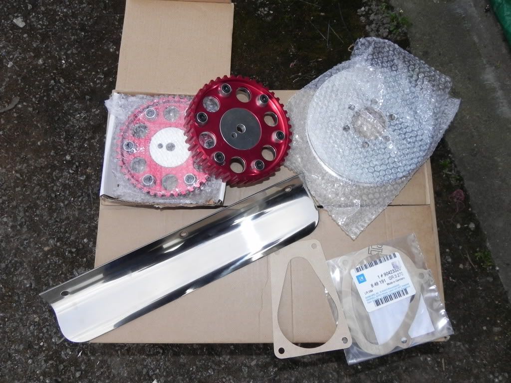

my order from jbi motorsport eventually turned up, thank god. got 2 vernier pulleys, bottom pulley and a heat shield. all very nice and shiney. also got the throttle body and top hat gaskets from vauxhall

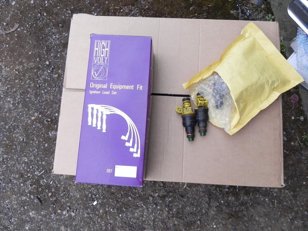

spoke to a local motor factors and got my self a set of ht leads, plugs and a magic marley mahle oil filter. my injectors arrived also that i won on ebay. need to get them cleaned and checked for operation.
http://i193.photobucket.com/albums/z...8/DSCN2996.jpg

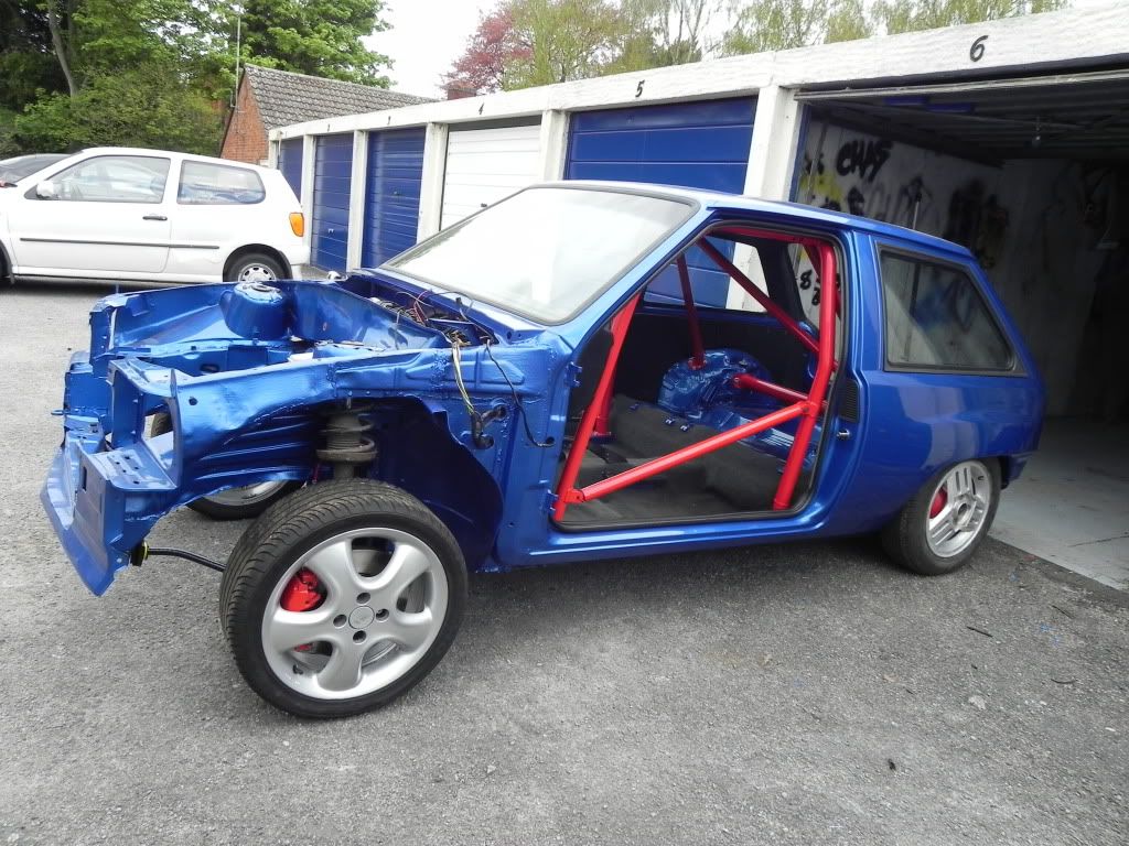

today i went and picked up the front section of the roll cage from the powder coaters.
http://i193.photobucket.com/albums/z...8/DSCN2999.jpg

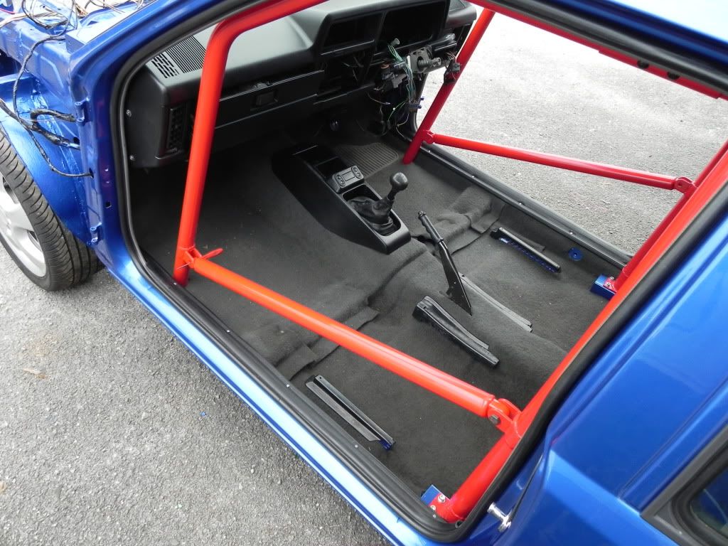

fitted it all in, trimmed the carpet to suit and then secured the sill trims in place

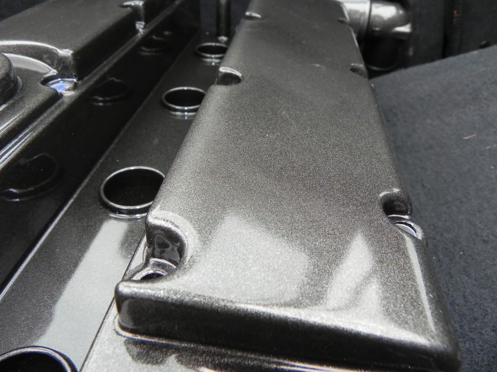

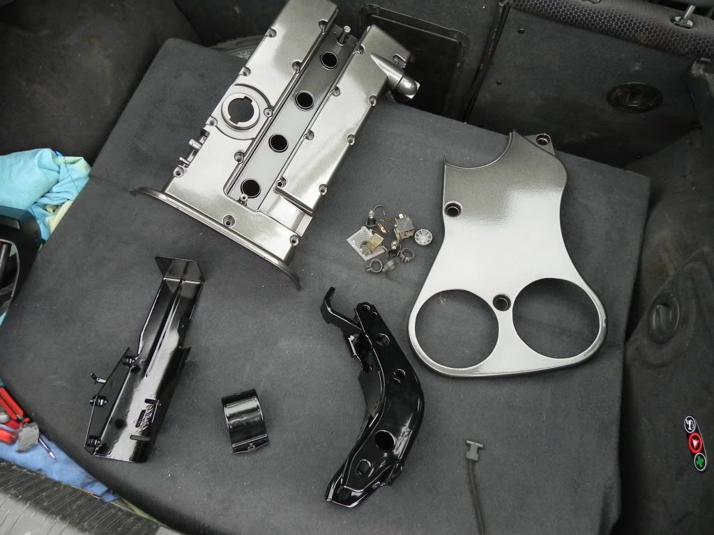

made a second trip down to the powder coaters to pick up cam cover, belt cover, rear gearbox mount and fuel pump mount.
http://i193.photobucket.com/albums/z...8/DSCN3017.jpg
http://i193.photobucket.com/albums/z...8/DSCN3019.jpg

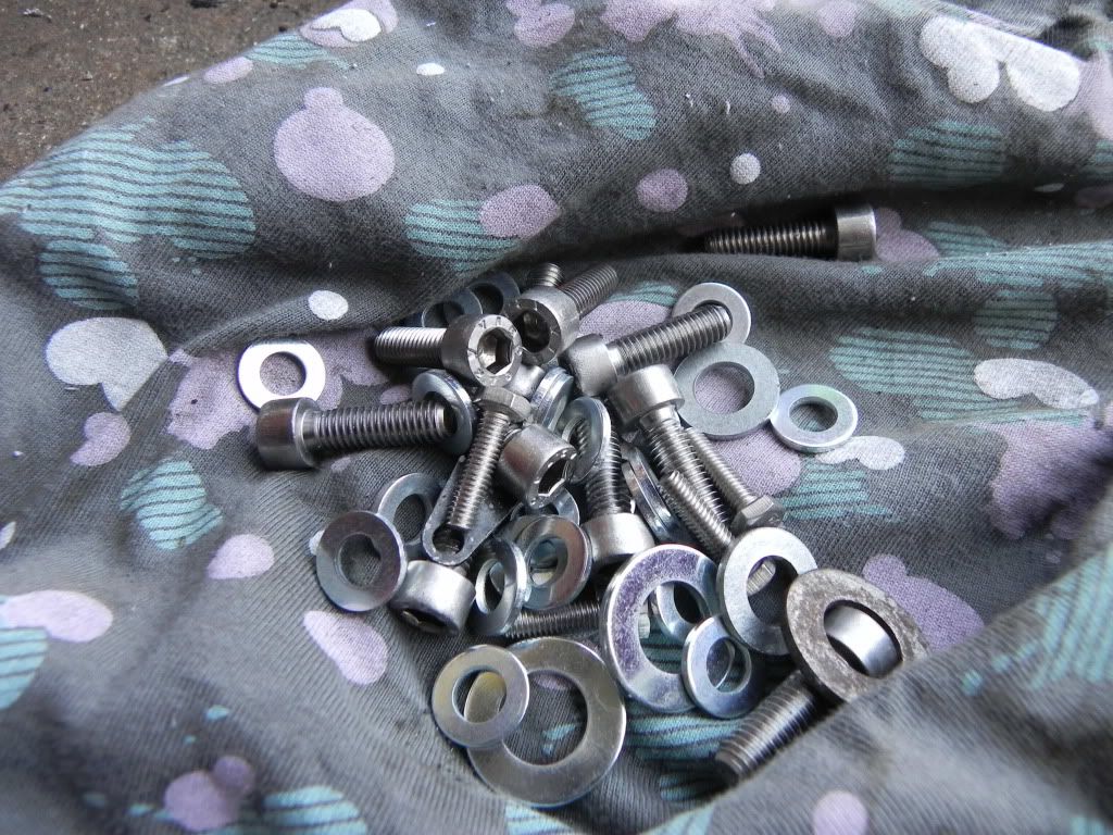

during the week i went down to fastening suppliers and picked up all the bolts for cam cover and belt cover. the bolts are A4 stainless but only charged me A2 stainless price. also got over sized washers for the belt cover but are too big. whats the correct size for them? these are 25mm wide.
http://i193.photobucket.com/albums/z...8/DSCN3020.jpg

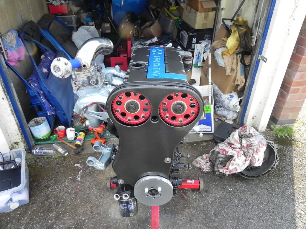

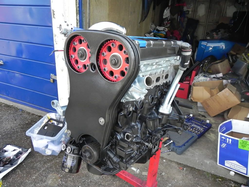

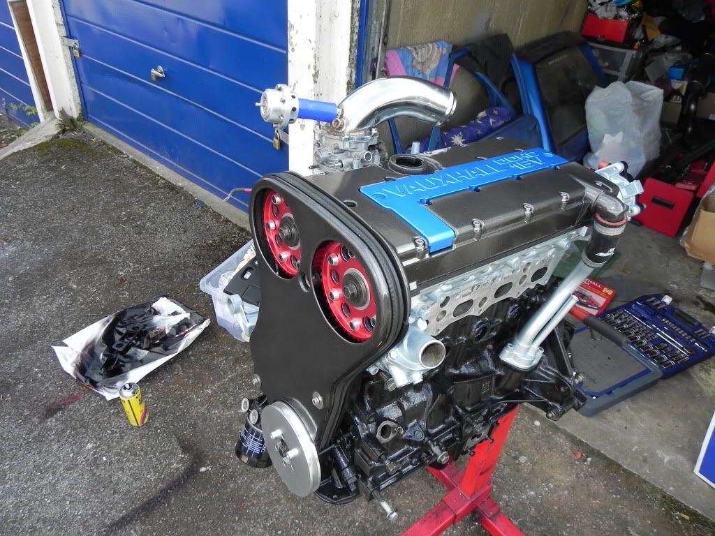

got the majority of everything bolted on and it turned out like this..
http://i193.photobucket.com/albums/z...8/DSCN3032.jpg
http://i193.photobucket.com/albums/z...8/DSCN3030.jpg
http://i193.photobucket.com/albums/z...8/DSCN3033.jpg
http://i193.photobucket.com/albums/z...8/DSCN3035.jpg
http://i193.photobucket.com/albums/z...8/DSCN3037.jpg
the plug covers the wrong shade of blue, the cap on the can was darker than what came out. will re-do it when i get a chance
ill hopefully get the cambelt on monday eve and take my injectors to be cleaned. going to have to sort the gearbox out ready to be painted.
surely missed something out, but thanks for looking
