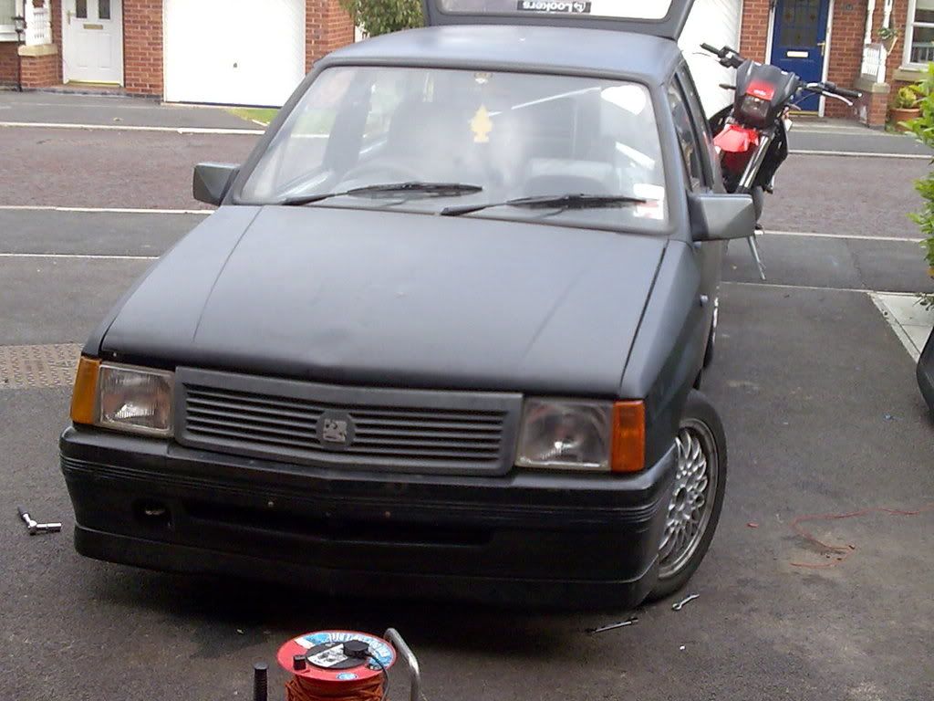

Quick update well have managed to do quite a lot really
first of all loosely fitted my gte bumper

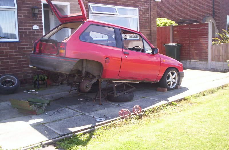

Next set about lowering the rear by 60mm
http://i215.photobucket.com/albums/c...xledropped.jpg

Looking good in all its matt black glory! lol
Only keeping it matt black until i know that it runs fine and is worknig spot on then will sort the outside, and also when funds allow lolQuote:

Nah keep it, much more of a sleeper. :thumb:
Nice wheels ;)

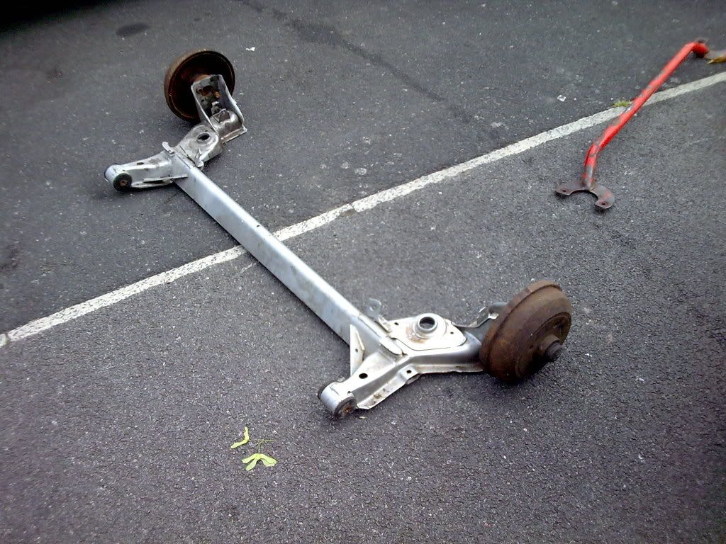

Just a quick update got a refurbished rear axle for free so set about changing my old rusty one! lol
http://i215.photobucket.com/albums/c...4/Image043.jpg
http://i215.photobucket.com/albums/c...4/Image046.jpg
Had to leave it without an axle as am changing the handbrake cable and brake lines
http://i215.photobucket.com/albums/c...4/Image050.jpg
aaahhh rust, haha lol. how the hell is that back box held on?
get a pic of the back panel!!
my car was like that for about 2 days when i bent my rear beam.

Yes its held on with zip ties! lol thats just while the back axle is off as am making a new bracket for the back box,Quote:

bit of rod bent at 90 degrees is all it needs.Quote:

Changed the back axle all now just needs bleeding up, had major issues with the rusted brake pipes!!
