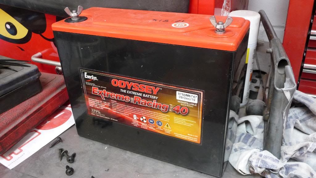

One battery - same spec a redtop varley - quite heavy but better then sat on the start line unable to start the engine

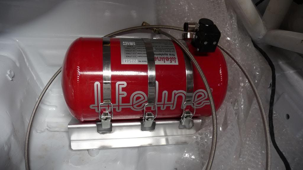

Extinguisher - ready to plumb in

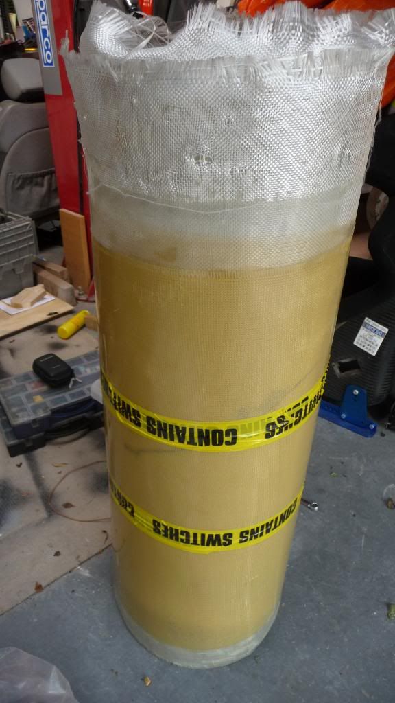

A roll of Composite Fibre ready to fabricate arch liners

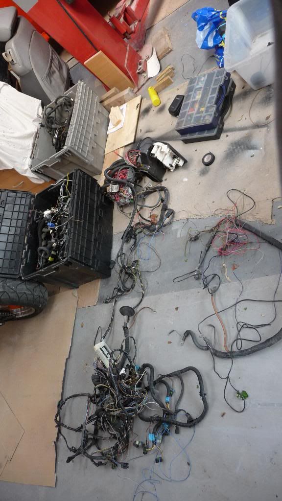

Lots of surplus wiring looms - just need to create one for the Corsa C

Then the mamoth task of creating and fitting the wiring harness
Seeing as the Corsa C uses a canbus wiring system - things get rather restricted with modifications to instrumentation and the removal of unneccessary comforts (Airbags/Electric windows/Central locking etc)
The rally car only needs simple lights and wipers - Engine will be taken care of with its own MBE loom, and the aftermarket Dash runs off it's own loom
So we binned the extremely heavy and complex Corsa C loom and went back to basics with a simple modified Corsa B loom, using parts of C loom where appropriate
Relocated and simplified the fuse box - and extended the harness where neccessary
I'm very happy with the results - very light loom and really easy to diagnose faults if they occur
