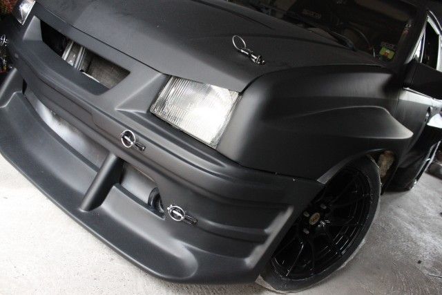

Heres a picture of whats going on at the moment and what it looks like ;)
http://i260.photobucket.com/albums/i...ps5e3c4bbe.jpg
mmmmmmm liking the front end.
That looks mental... Love it ;)
Awesome! Will keep an eye out for more updates
The front looks evil! Awesome work as usual
car looks awesome mate, ive just read through it all
I love the look of the front end
Evil looking front end... Like it.
Matt-black evil? :)

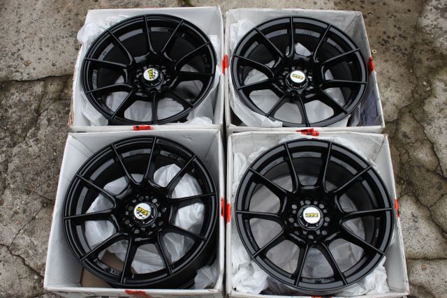

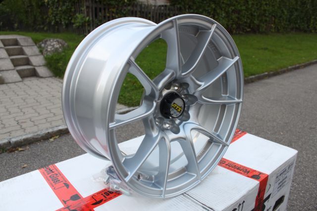

first of all, i got myself some new lightweight alloy wheels: ATS DTC 8x15 ET20
http://i260.photobucket.com/albums/i...MG_8325b-1.jpg
and had them painted matt black
http://i260.photobucket.com/albums/i...psbb7781d9.jpg

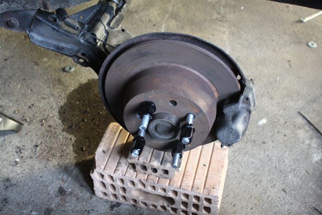

fitted Astra GSi brakes at the rear
http://i260.photobucket.com/albums/i.../IMG_8465d.jpg

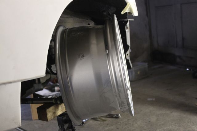

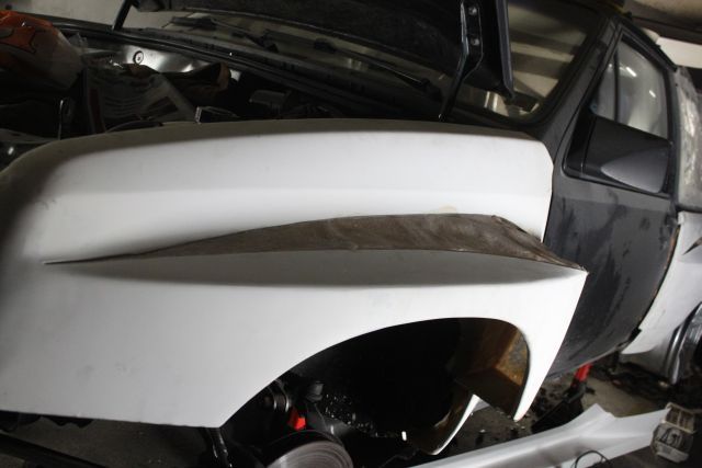

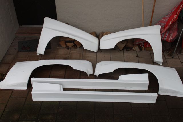

ordered the protec motorsport wide arch kit
http://i260.photobucket.com/albums/i.../IMG_8526d.jpg
and made it even wider :d
http://i260.photobucket.com/albums/i.../IMG_8672d.jpg
same at the back with new inner arch
http://i260.photobucket.com/albums/i.../IMG_8627d.jpg
wide enough i think lol
http://i260.photobucket.com/albums/i.../IMG_8725d.jpg

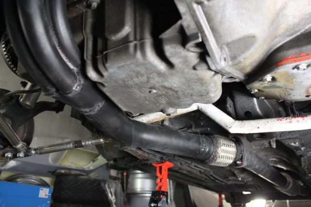

De-cat the exhaust
http://i260.photobucket.com/albums/i.../IMG_8803d.jpg

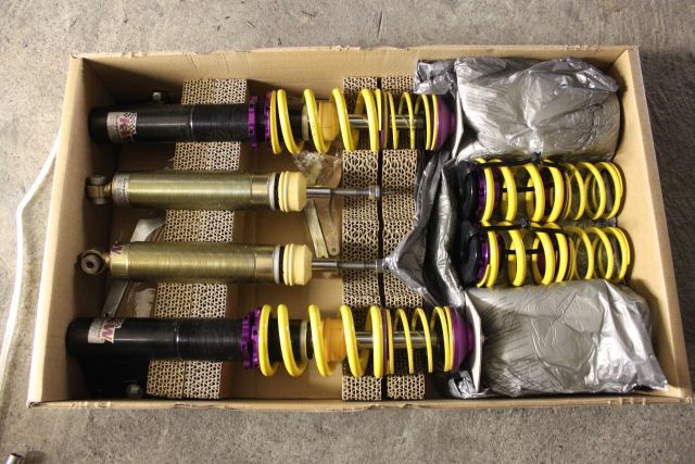

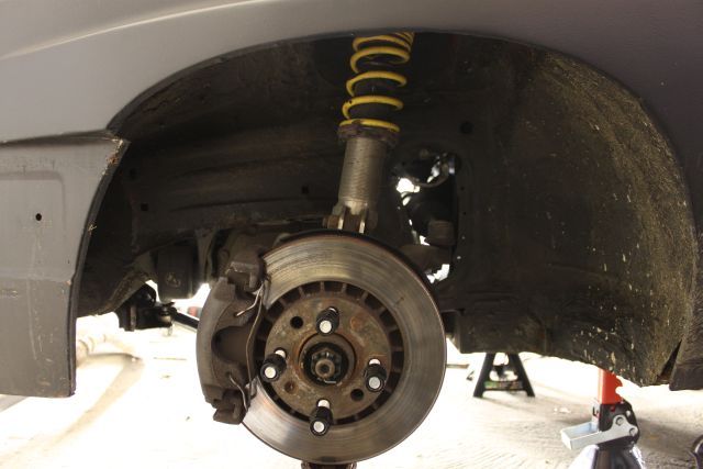

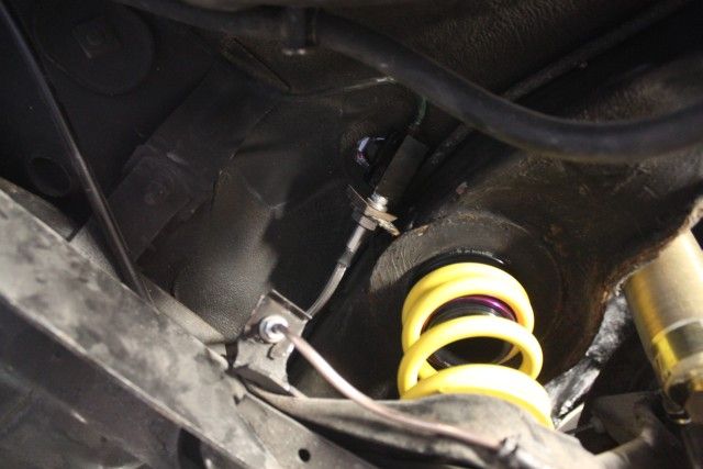

New Competiton coilovers by KW Automotive
http://i260.photobucket.com/albums/i.../IMG_8807d.jpg

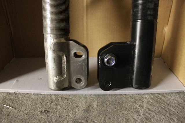

specially made for me: 3cm wider than original
http://i260.photobucket.com/albums/i.../IMG_8834d.jpg

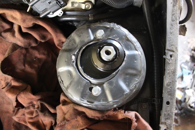

modified the top mounting points 2cm to the outside to gain a wider track in addition with the new coilovers.
http://i260.photobucket.com/albums/i.../IMG_8498d.jpg
caster can also be adjusted. I'm aiming for 3-4°
http://i260.photobucket.com/albums/i.../IMG_8521d.jpg

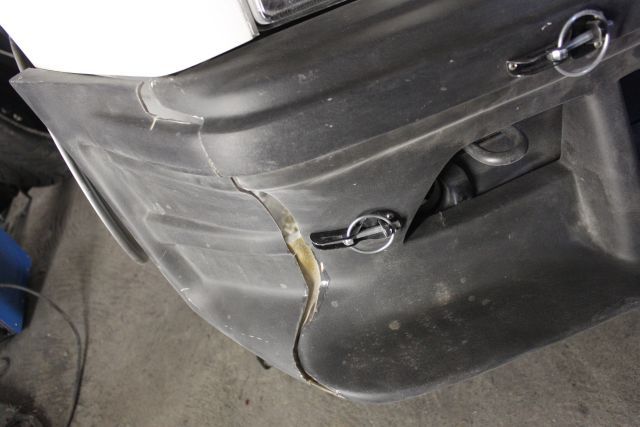

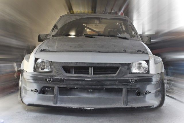

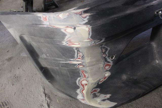

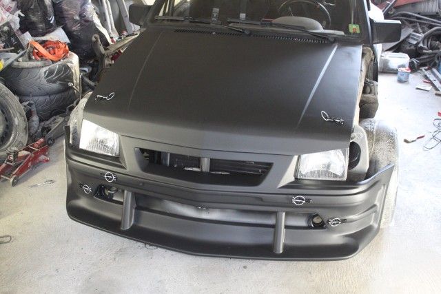

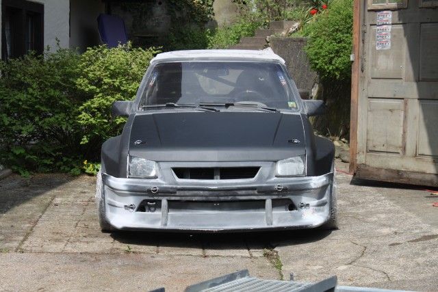

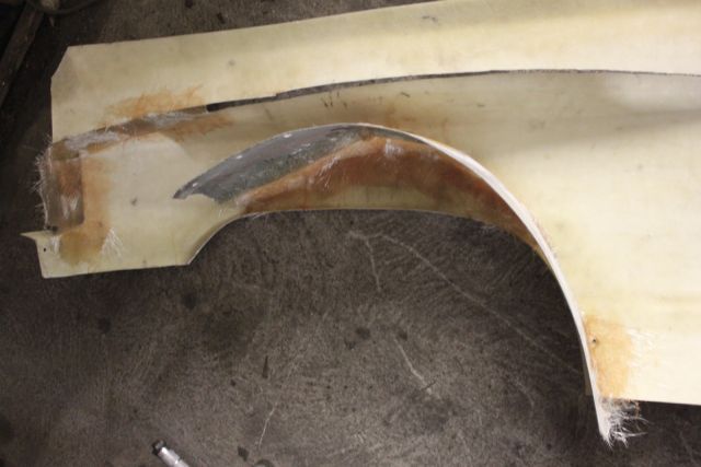

because of the wider front arches i had to cut apart the mattig bumper and do some fiderglass work :)
http://i260.photobucket.com/albums/i.../IMG_8876d.jpg
http://i260.photobucket.com/albums/i...psc35f6d58.jpg

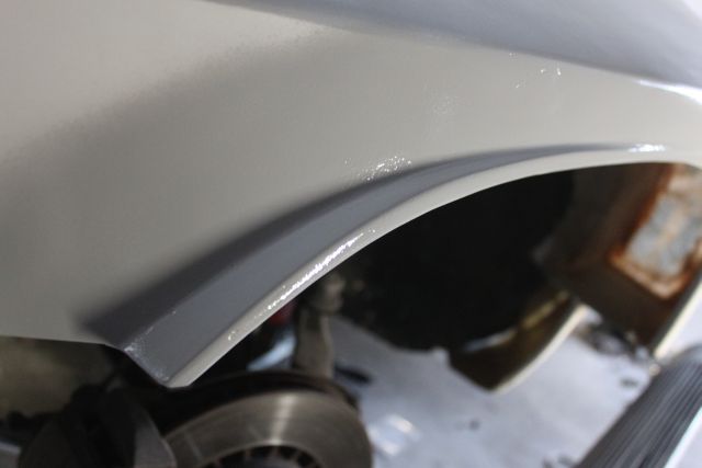

and made a matching lip on the front arches
http://i260.photobucket.com/albums/i...ps446f81e6.jpg

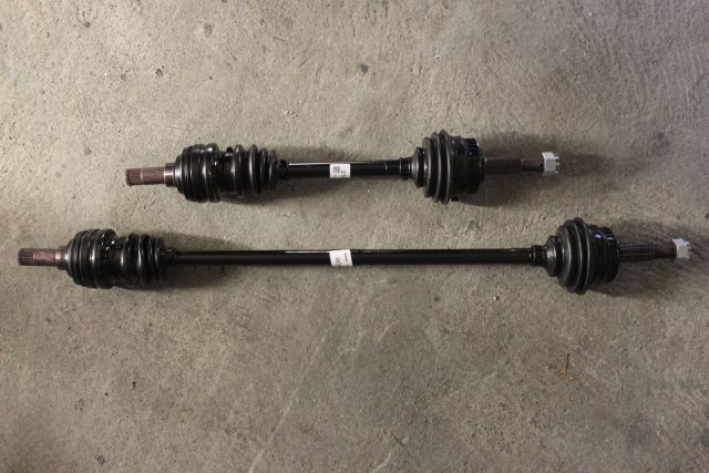

new smallblock-astra driveshafts
http://i260.photobucket.com/albums/i...ps5679b05f.jpg

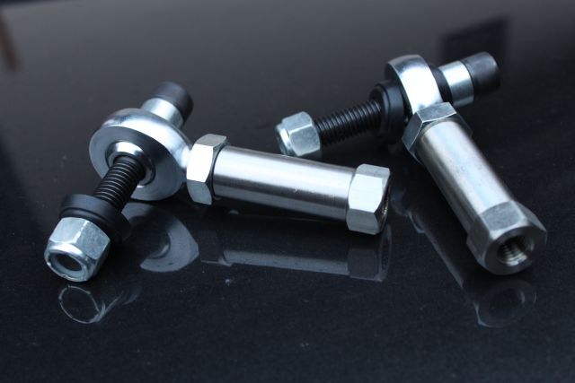

to complete the wide track conversion i bought track rod ends from compbrake
http://i260.photobucket.com/albums/i...ps621ed635.jpg
and mounted them under the pick-up point
http://i260.photobucket.com/albums/i...ps123b54b0.jpg

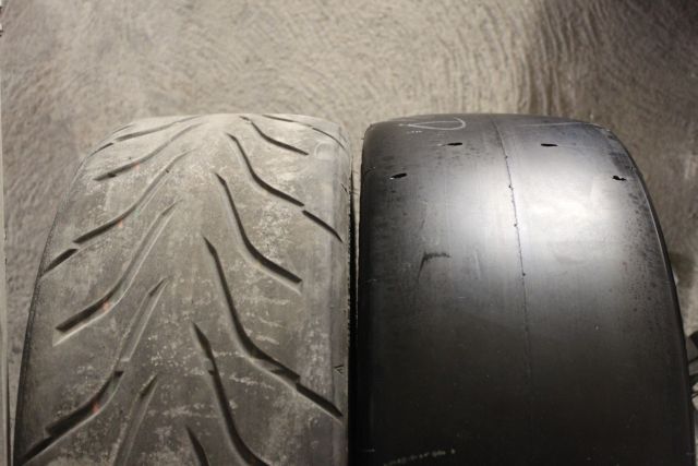

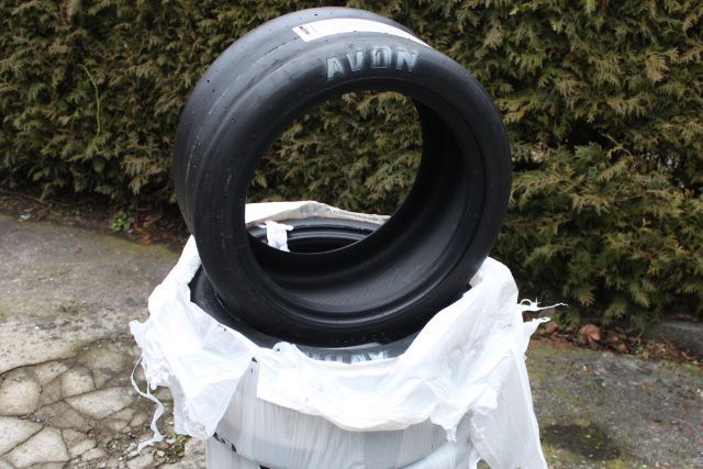

Avon Slicks 8.0x21.5-15 Soft and very Soft form slalom events
http://i260.photobucket.com/albums/i...ps274a26db.jpg
Dunlop 200/580 R15 Slicks Medium Compund for Trackdays compared to the Toyo R888 205/50 R15
http://i260.photobucket.com/albums/i...ps4aa2e2e5.jpg

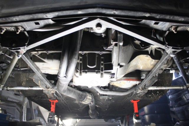

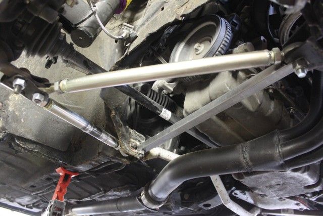

made a subframe to support the chassis
http://i260.photobucket.com/albums/i...ps5fc0e6df.jpg
complete subframe :cool:
http://i260.photobucket.com/albums/i...ps857c093d.jpg

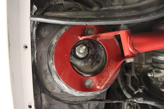

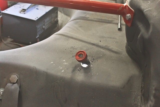

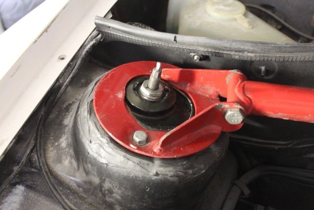

had to modify the strutbrace because there was no way to mount it after my conversion
http://i260.photobucket.com/albums/i...psce772edf.jpg
a few hours, some drilling and grinding later there was a way :d
http://i260.photobucket.com/albums/i...psc76d9f17.jpg

looks great, have the compbrake track rod ends got a tapered insert that sits in the original hole on the knuckle?
look amazing
i want it lol
Thanks guys :thumb:
No, is a standard 12mm bolt. I had to drill the axle knuckle to fit, but was easily done with a hand drill.Quote:

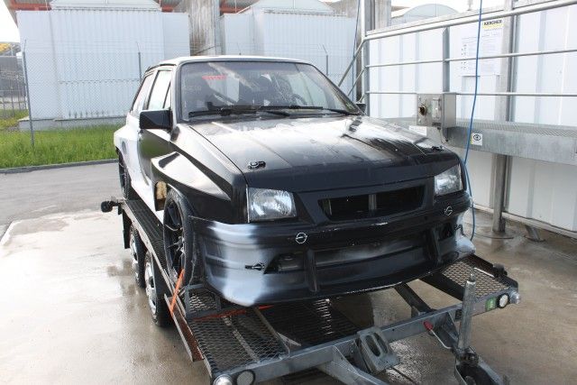

Here are some brand new pictures of my beast :d
http://i260.photobucket.com/albums/i...ps423a19b2.jpg
http://i260.photobucket.com/albums/i...ps195d9b40.jpg
http://i260.photobucket.com/albums/i...ps08c2791b.jpg
http://i260.photobucket.com/albums/i...ps20f1123f.jpg
http://i260.photobucket.com/albums/i...ps1055f42e.jpg
http://i260.photobucket.com/albums/i...ps8bbf07d5.jpg
http://i260.photobucket.com/albums/i...ps094ef34a.jpg
:cool::cool::cool::cool::cool::cool::cool::cool::c ool::cool::cool::cool::cool:
Woah! The arches are frigging huge!
that is sweeeeeet :)
WOW!! Looks so evil, love it!
Well least your username now matches your car!
Or maybe you should get it changed to '' TheMostEpicTrackNovaEver! '' Lol
Love this car mate, amazing progress.
Loving this! Big fan of the wheels.
oh my god that is so nice love it :wisewood::wisewood::wisewood::wisewood::thumb::th umb::thumb:
Doing the rounds on Facebook today these pics :-) awesome machine fella!
Lovely beast! :thumb:
awesome car mate those arches are MASSIVE!!!!!
