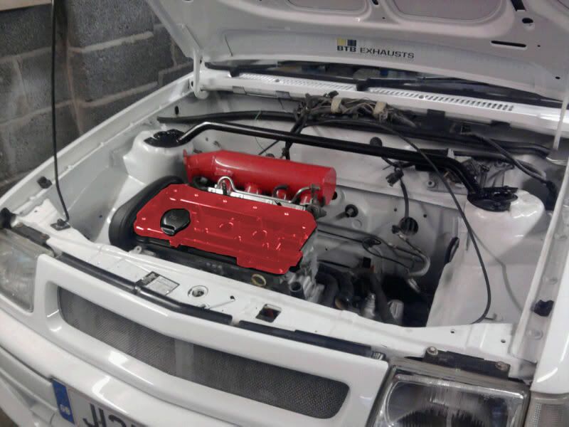

Been a while since i posted but had a productive day today. Was hoping to have her running today, but you can't rush these things. was having issues with the wiring to the alternatior and the oil pressure sensor. it was a no go without wiring these in as the loom had been butchered by the previous owner!
Inlet manifold is sorted, was bit of a pain but i'm relatively happy with the finished result.

looking good mate, inlet manifold looks good i need to wire my 16xe up and and get something similar.
Good project youve got there, whats the wiring like to do as im putting a c16xe in mine and im not looking forward to the wiring side of things, Phil.
