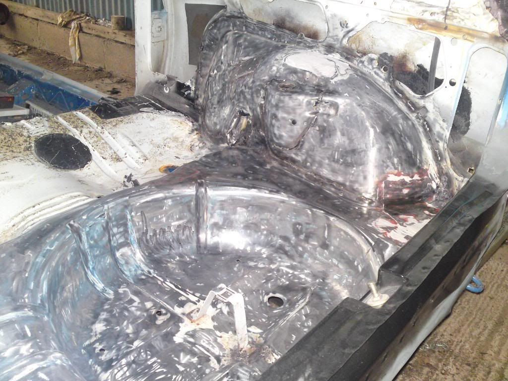

then proceeded with stripping off the soundeadening from inside the car. came up easy with a heat gun.
http://i193.photobucket.com/albums/z...8/DSC02657.jpg

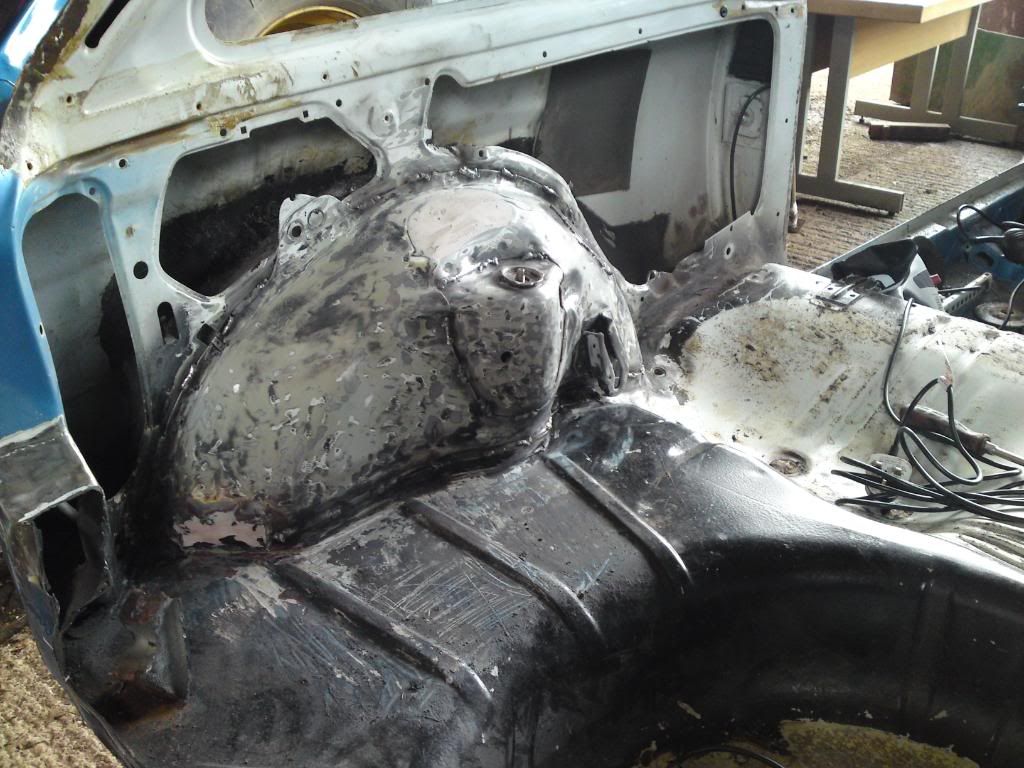

started back on the engine bay. got as much as i could done. have run out of sanding discs so couldnt do any more. have got the main lines of the filler sorted on the inner wings. will have to get some finishing filler to sort the imperfections. gave it a bit of primer to give it a more uniform look, even though it will be coming off again to finish it all.
http://i193.photobucket.com/albums/z...8/DSC02671.jpg
http://i193.photobucket.com/albums/z...8/DSC02670.jpg
http://i193.photobucket.com/albums/z...8/DSC02672.jpg

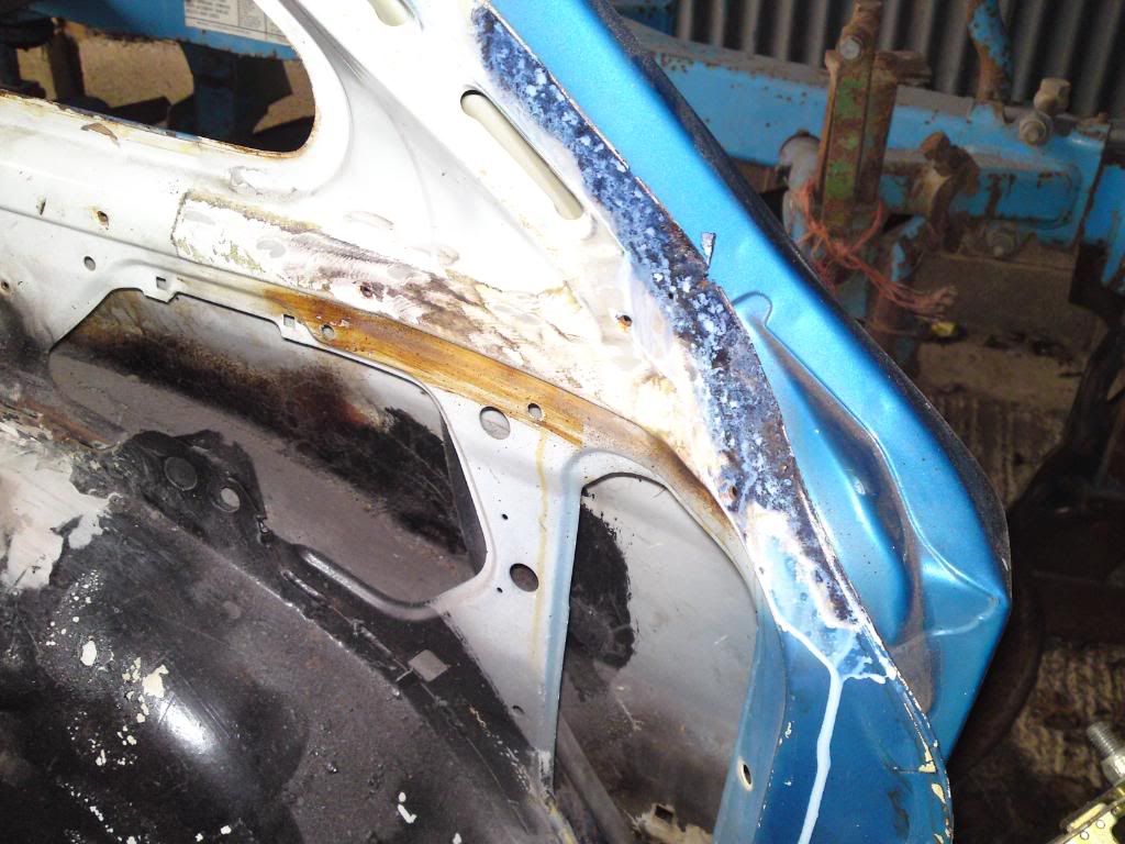

ive decided that ill strip all the paint off the inside of the car to save rubbing it down as that could take hours to get it smooth with it having many layers of paint on it. i started using nitromors as i presumed this would be the best stuff, it just takes so long to work and doesnt always strip all the paint off. only other stuff i could find in halfords was cellulose thinners and doesnt say it would strip paint off. so will have to hunt around for some stripper/thinner that will aid me in a quicker strip.
http://i193.photobucket.com/albums/z...8/DSC02714.jpg

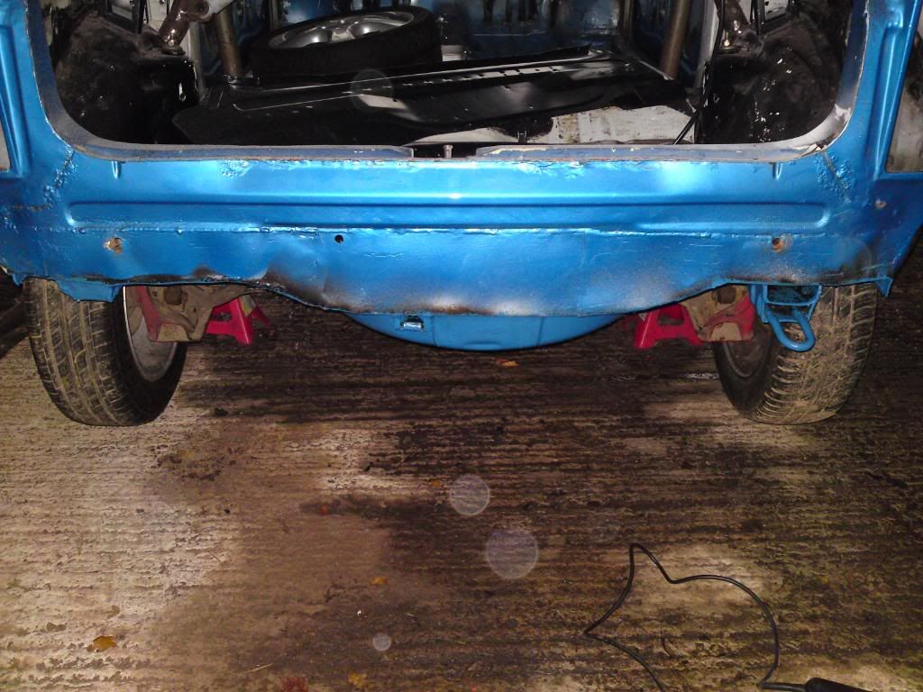

decided to have a go at fitting my new rear panel, was getting fed up with it lying around and the fact it would cost me to get it fitted. reason im fitting a new one is because it doesnt look good how it is so want it to look tidyer.
this is how it started off, somebody had previously replaced the rear panel with a piece of sheet metal. whoever did the job didnt want it to come off, ever!
http://i193.photobucket.com/albums/z...8/DSC02667.jpg
went and got my mates 9inch grinder and cut the majority of the old panel out, i then tidyd it up using my 4inch cutter. some of the metal was a bit worse for ware so i cut it out.
http://i193.photobucket.com/albums/z...8/DSC02732.jpg
this is the new panel, its a pattern part but fit doesnt look too bad.
http://i193.photobucket.com/albums/z...8/DSC02734.jpg
placed it up there to get the idea of how it fitted and to see what id have to modify to fit it.
http://i193.photobucket.com/albums/z...DSC02744-1.jpg
after a while i got it somewhere near, fitted the tailgate back on to make sure its in line with the catch.
http://i193.photobucket.com/albums/z...8/DSC02756.jpg
offered up the rear bumper to ensure that lined up nicely aswell.
http://i193.photobucket.com/albums/z...8/DSC02749.jpg
once all was ok i welded on the panel, i then ground down the welds and started smoothing out the panel. still got to sand the filler down.
i had made one error though, i only ever checked that the tailgate closed on the first click of the catch and not the second. when i came to close the boot it would butt out on the c pillars. to get around this i got a block of wood on the inside of the panel and used my trusty hammer to massage it outwards. the boot now closes perfect.

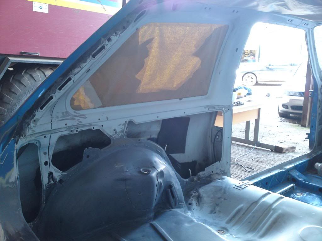

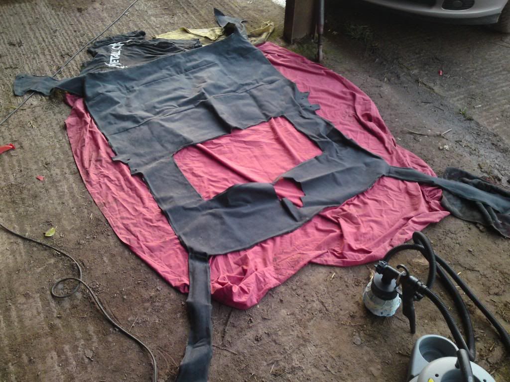

my headlining from wilson_sri had eventually turned up. loving the feel of it and cant wait to get it in the car. should go well with my leather interior.:d
http://i193.photobucket.com/albums/z...8/DSC02825.jpg
http://i193.photobucket.com/albums/z...8/DSC02826.jpg

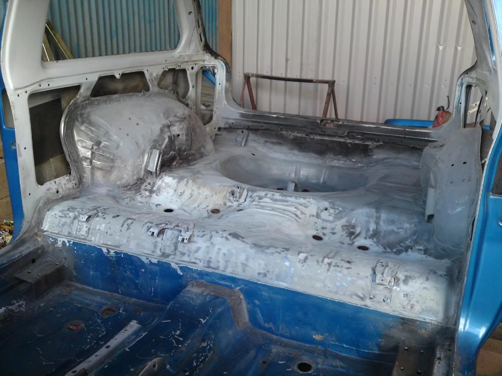

onto the work ive done on the car. finished off preping the inside ready for primer. as the rear of the car will be on show when its all finished i paid great attention to getting it smooooooooth.
http://i193.photobucket.com/albums/z...8/DSC02804.jpg

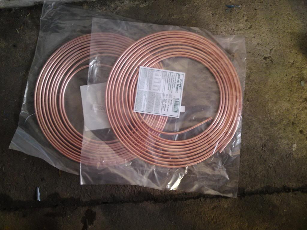

Nice update Brucer. Where did you get the copper pipes from?

got it from a local motor factors. was 6.50 a roll.Quote:

B&Q wants £24 for 10m of 8mm copper pipe. Funk that!
25ft. you want brake pipe? its 3/16th you want. the 8mm or 5/16th is for fuel lines.
fuel lines is what I want. brake pipes are already new and copper.

ahh ok. i think thats fairly cheap tbh. my motor factors wanted 45quid!! cheapest ive found on ebay is 2.15 a metre iirc. i only need like 6metres max for my fuel lines so will be around 12/13 pound plus postage. search for copper gas/water pipe. should come up.Quote:
