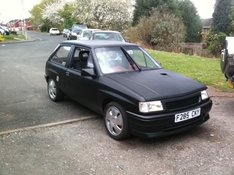

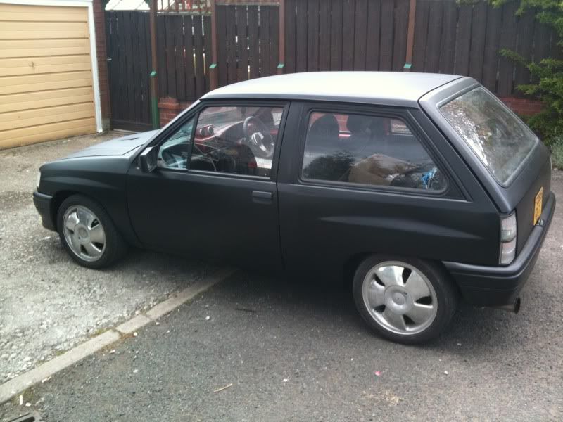

ok heres the finished (temp) spray job, i think its turned out ok see for yourselves:

burgo black no2 lol
looks a ok job that buddy!!

Looks good fella! Hope the rr goes good! What power you hoping for??
Between 230 and 250
pmsl matt black nova with polished cav wheels
+ rep :thumb:
But in all seriousness looks like you done a good job with those cans
and it does make sense, roughly how many cans did it take you to do the whole car?
18 cans matey, I've got an account at maccess, the paint was only 1.30 a can trade lol!
well thats cheap enough then dude!! and hoep you get what you want on the rollers!!
