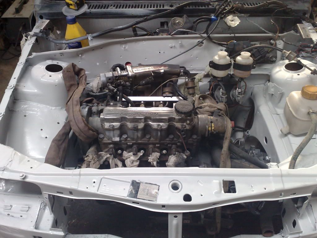

had a spare 10 mins earlier so thought id do this quickly
http://i46.photobucket.com/albums/f1...y/enginein.jpg
now the fun begins, gear linkage, remember where all electrics go etc etc :( help?

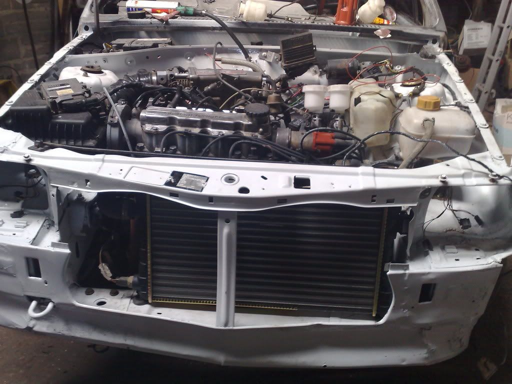

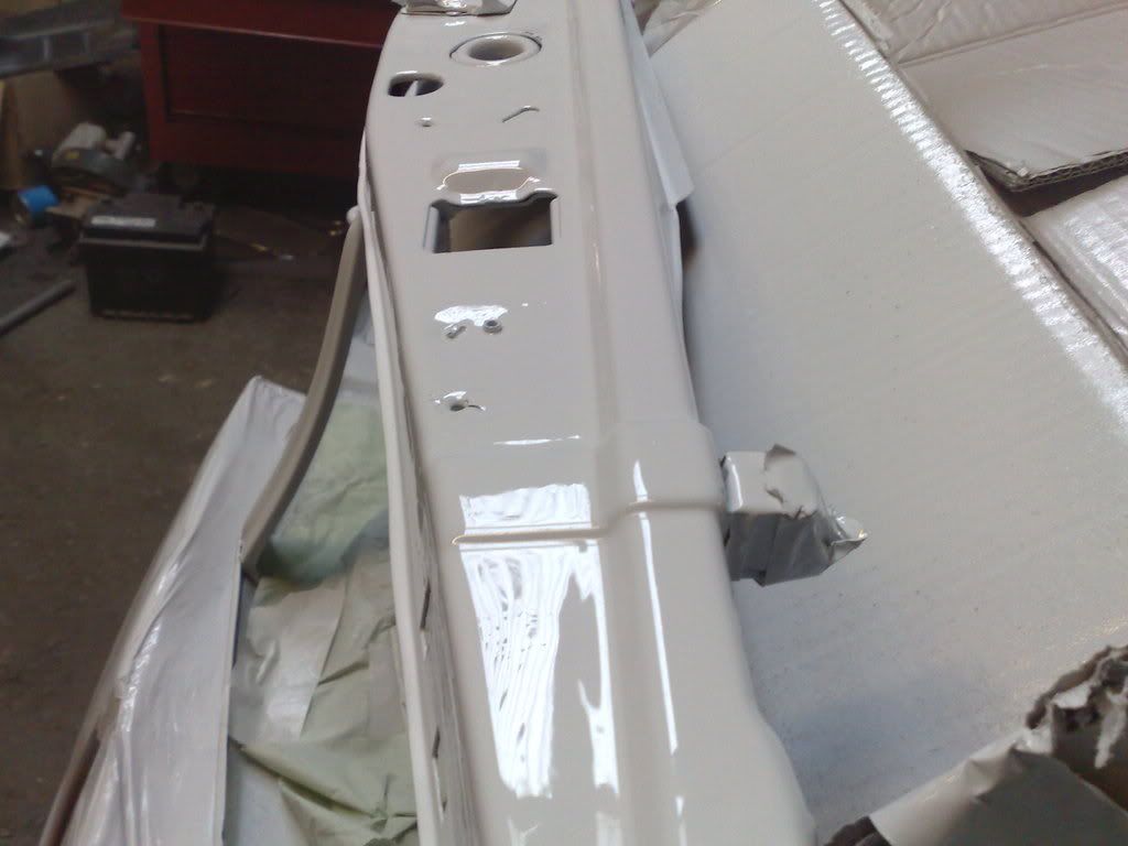

few more pics, not alot happened lately, got all engine bay built back up
http://i46.photobucket.com/albums/f1...y/allwhite.jpg
http://i46.photobucket.com/albums/f1...0Rally/Rad.jpg
http://i46.photobucket.com/albums/f1...frontshine.jpg

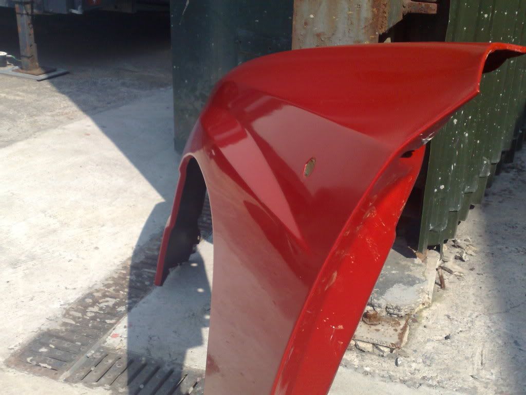

but bloody thing not running yet, sparks and everything but got a leaky fuel tank and dodgy wiring going to fuel pump, so trying to sort all that out at the moment, but painted up a front wing other day to see what body colour was going to look like and was happy with outcome
http://i46.photobucket.com/albums/f1...0Rally/Red.jpg

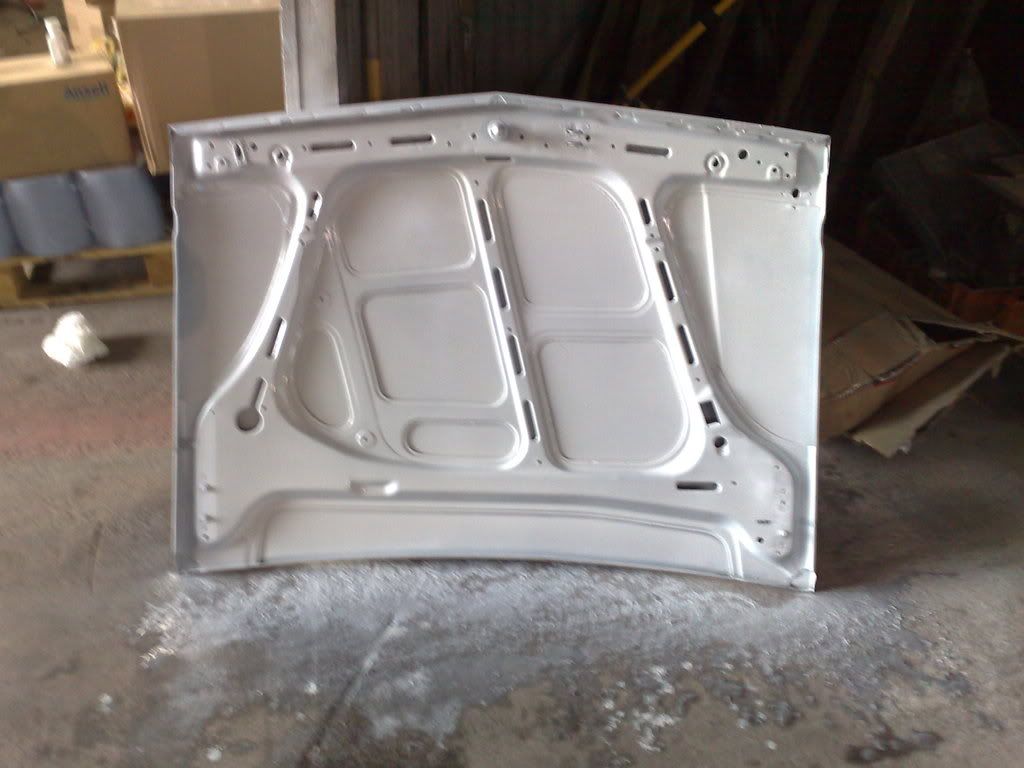

and sprayed up underside of bonet http://i46.photobucket.com/albums/f1...underbonet.jpg
