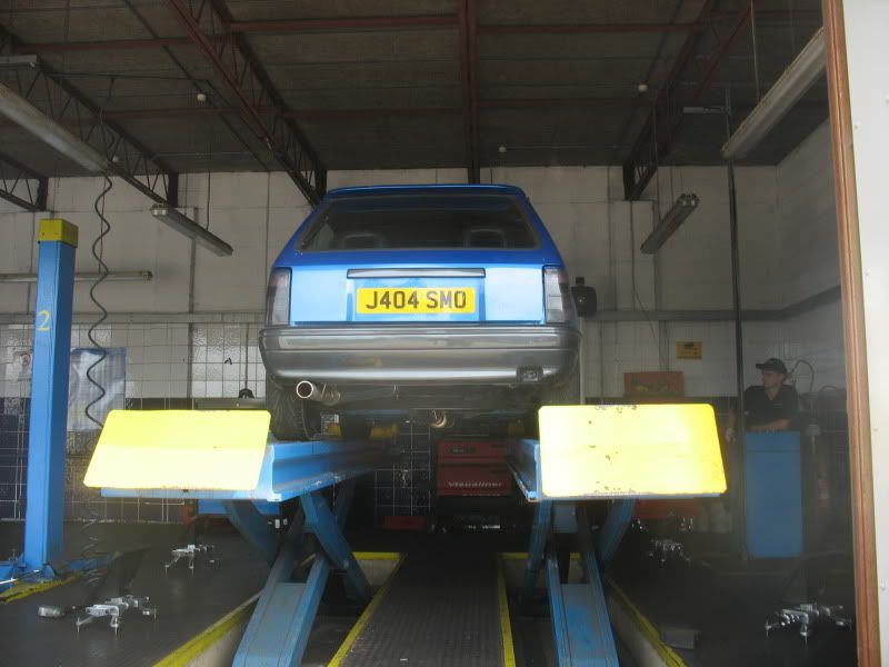

		Started the day off with a bit of tracking. As i've found the car pulls to the right, last night on a quiet motorway in the inside lane i found if i even gently sped up the car would drive across to the outside lane..
Popped to the Local ProTyre. Only place i trust. Big thanks to Paul, Jim and Kenny.

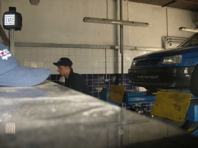

Oooo lazors..
http://img.photobucket.com/albums/v3.../tracking4.jpg
Kenny getting all the book settings up,

Toe was miles out, now set with a bit pointing in. Camber isnt to bad. But i have bad toe on the rear both wheels to the left.. Which isn't good...

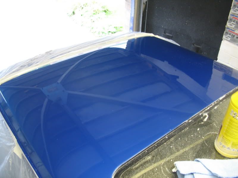

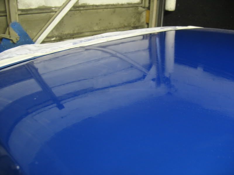

Re wrapped the car up with the plastic sheet to save polishing splatter.. Set about with 1500 then 2000 grit finishing paper..
Before,
http://img.photobucket.com/albums/v3...ffinished9.jpg
You can see the orange peel in the reflection, no where near as bad as it used to be. Cause the body shop have a all now £25k oven and the new painter is really good.
After,
http://img.photobucket.com/albums/v3...ffinished4.jpg
http://img.photobucket.com/albums/v3...ffinished2.jpg
Quite flat..

		good work, the roof looks perfect now!
		mmmm glass finnish paintwork! lovely! :D
