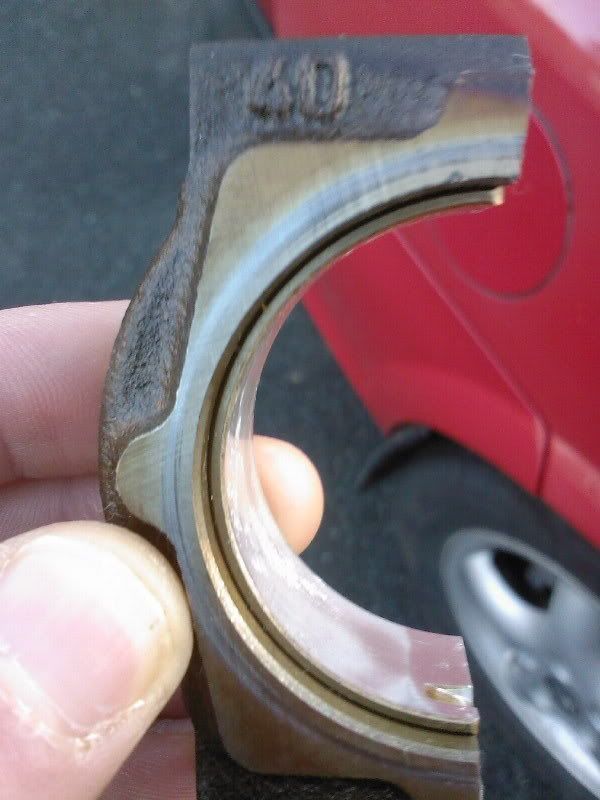

just checked the rod ends; cant see any dots; on one side each have a two digit number; one says 40, another 53, another 59 and the last 60...?
theres another number on the opposite face side, hard to make out..
40 one says 151, 53 one says 151, 59 one says 161, last 60 one says 161..

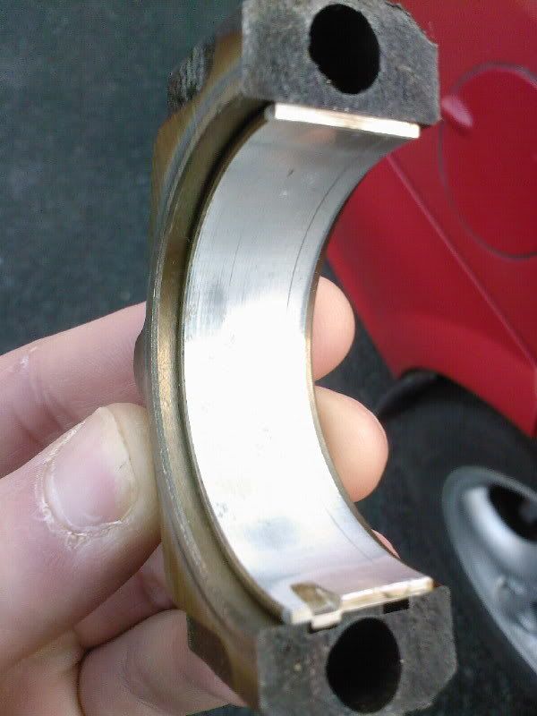

well here is a pic of a cap on a rod end with hopefully at the bottom, the fracture u speak of..

they are marked from the factory tho:
this one says 40
http://img.photobucket.com/albums/v1...r/SP_A1517.jpg
the others say 53 59 and 60, as mentioned in the thread earlier..
We had a look today and we think it just goes in assending order; piston 1 = 40, piston 2 = 53, pist 3 = 59 and 4 = 60..
dunno lol.
fraid not, thats a batching number, just a coincidence they were in ascending numerical value
main thing is you can get them back in the right pairings now, not so easy with flat cut types!

Previously; The rod ends indeed arent numbered arent in any order - they do fracture when you remove them- so each one is unique.
It was these fractures being unique that helped us piece together how they went back.
But non the less- Top Tip: Number them before hand. lol.
So we matched up each one back to its other half - fitting the arp's.. finally.

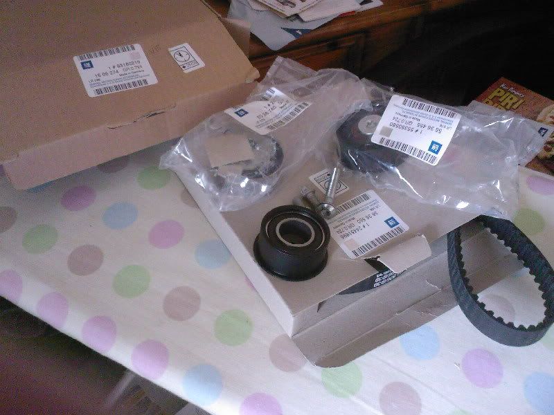

Next job CamBelt Kit. Picked this genuine new 'kit up for £50. Ace.
More again soon.
