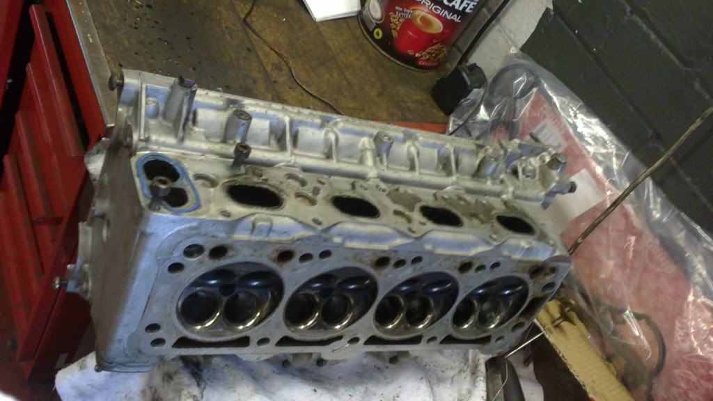

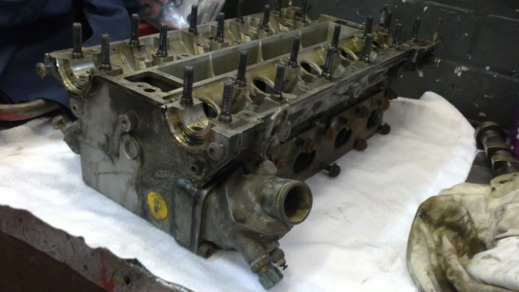

as mentioned from my saturday post i took the head to work for the strip down.
http://i193.photobucket.com/albums/z...8032011129.jpg

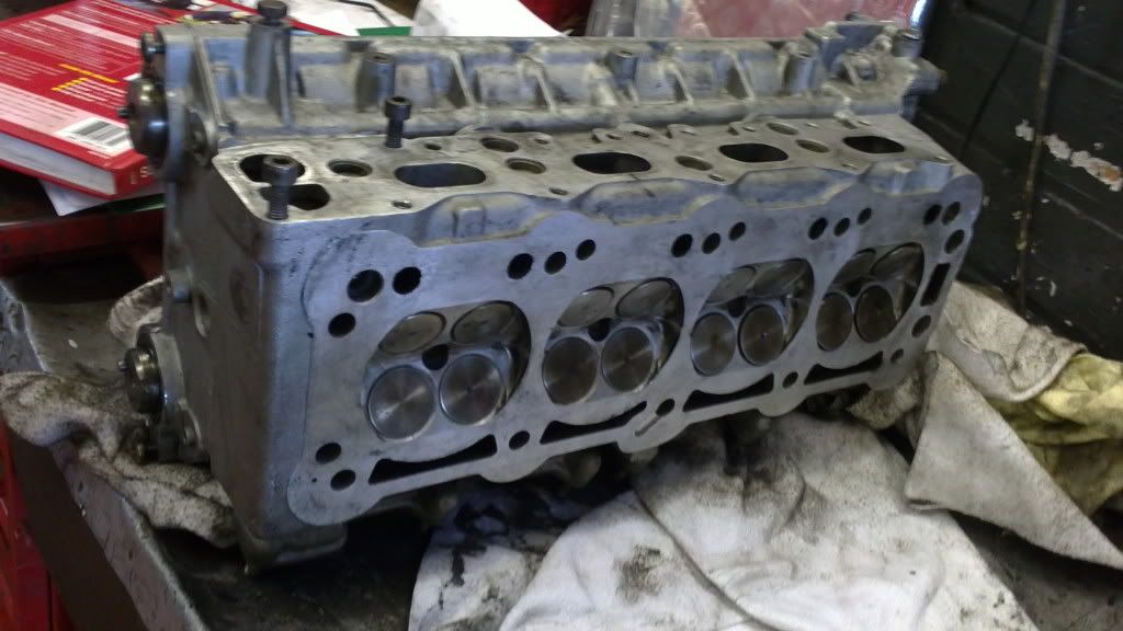

rather grubby you may think, well its what i thought aswell.

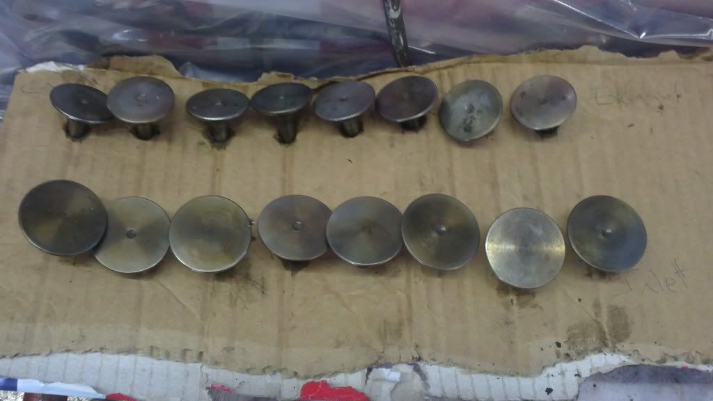

removed the valves and set them up in some sort of order, gave them a wire wheeling ready to be lapped in.

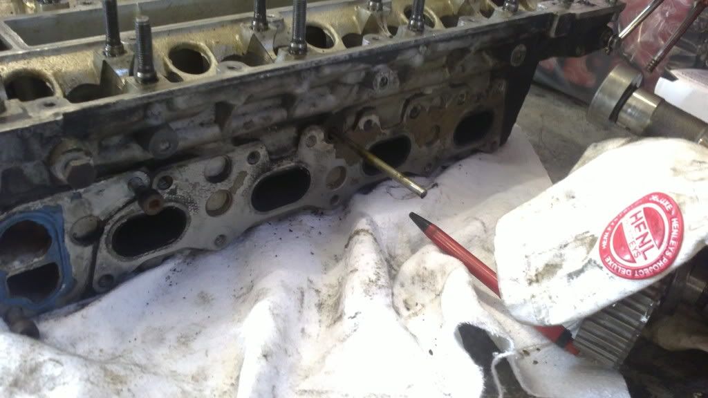

eventually found a 5.5mm allen key (7/32nd tbh) and undone the grub screws so i can eventually attempt the porous head mod. the head hasnt gone porous yet but id rather it didnt. passed a rod through it all it make sure it was clear.

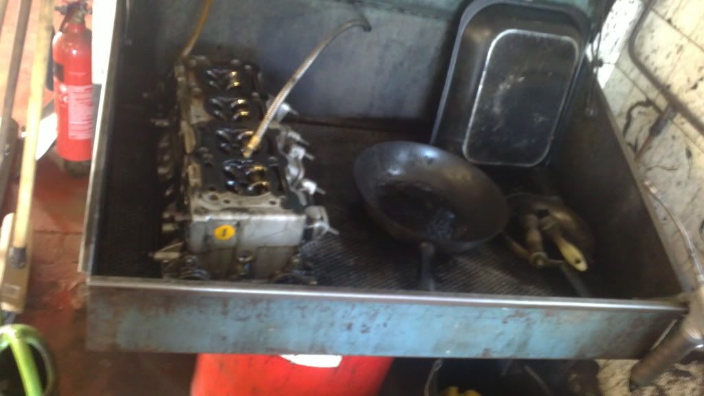

placed it in the washing off tank and scrubbed it clean
http://i193.photobucket.com/albums/z...8032011135.jpg

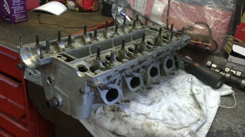

washed it off with the hose and air lined it dry. came out rather well.
http://i193.photobucket.com/albums/z...8032011136.jpg
http://i193.photobucket.com/albums/z...8032011137.jpg

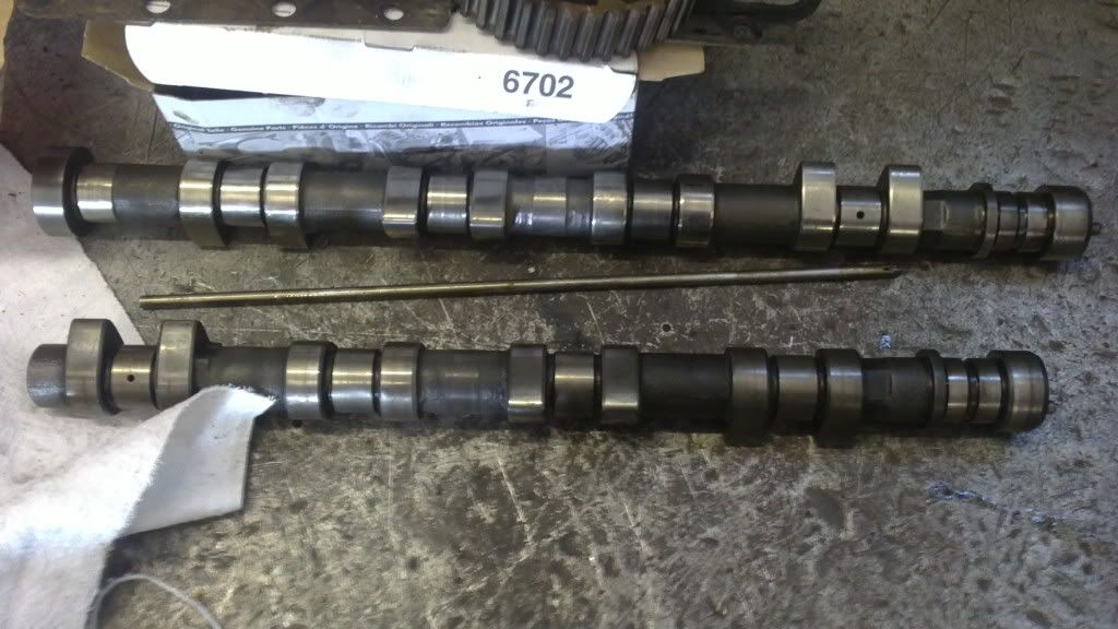

cleaned up the xe cam and the let cam also.
http://i193.photobucket.com/albums/z...8032011134.jpg

continued on with the head, got all valves lapped in and assembled.

got the XE inlet cam and LET exhaust cam bolted down and torqued correctly
http://i193.photobucket.com/albums/z...0032011138.jpg

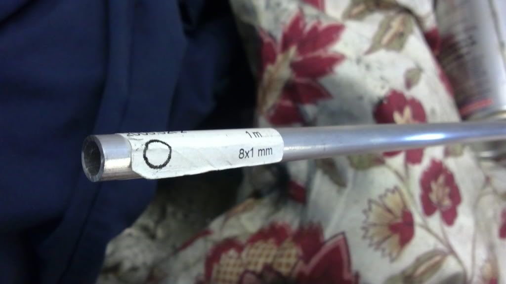

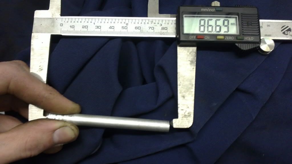

on with the porous head mod, went to b and q to buy the 8mm diameter aluminium tube.
http://i193.photobucket.com/albums/z...1032011140.jpg
cut a section down to near to 87mm as i could and tidied the end up.
http://i193.photobucket.com/albums/z...1032011143.jpg
went to trial fit the tube in the head to see how much tapping it will need to go in, only to hear myself go DOH!!!!

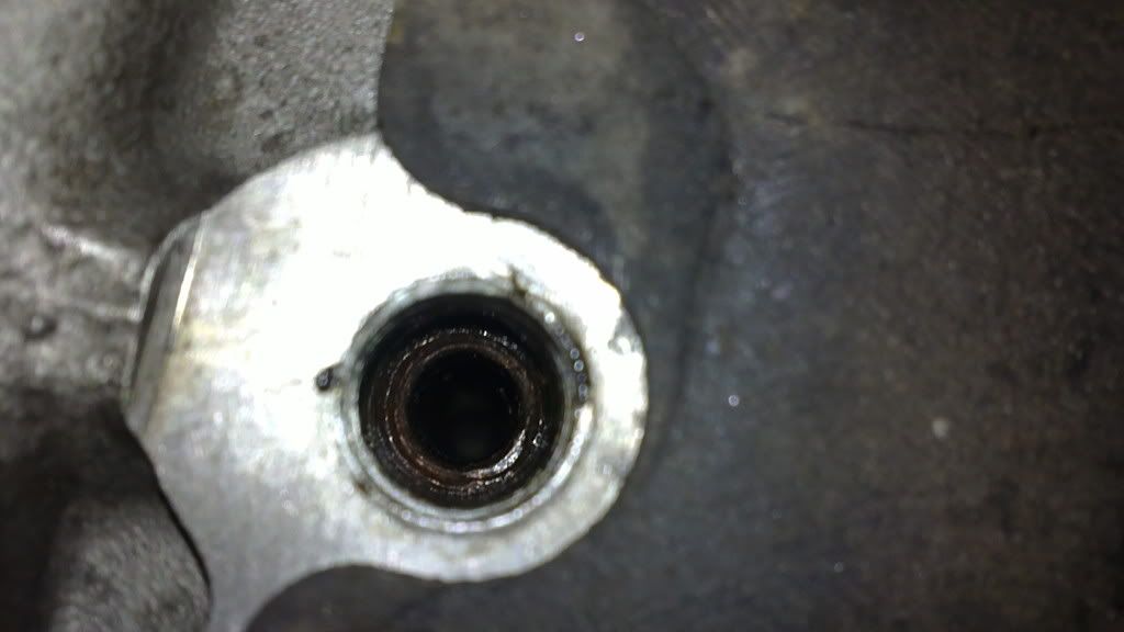

the head has already been repaired before. i had noticed when i removed the head there was a warranty void sticker which i could barely make out. presumabley it was a re-con head.
http://i193.photobucket.com/albums/z...1032011144.jpg
not to worry, i returned the tube to b and q for a refund, even with a minor bit missing. lol also gave the head a paint of silver to spruce it up.

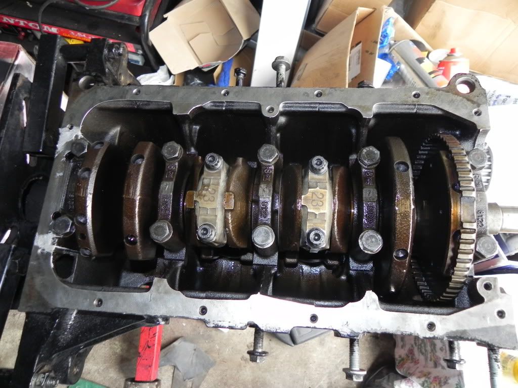

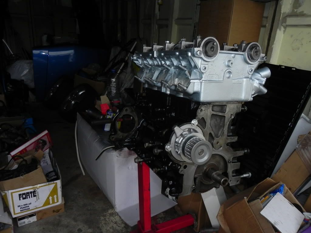

down my garages today to bolt the head on to the block, first i had to fit the arp rod bolts. had the conrod caps countersunk by a machine shop to accomodate the bolts. torqued them down using the supplied lube.
http://i193.photobucket.com/albums/z...8/DSCN2483.jpg
after that i drilled out the relavent rivets off the Z20LET head gasket and fitted it to the block.
http://i193.photobucket.com/albums/z...8/DSCN2482.jpg

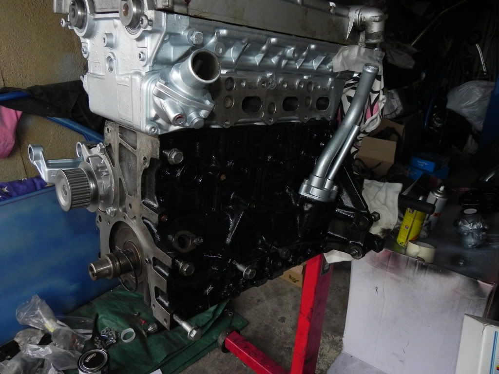

got the head on and torqued down
http://i193.photobucket.com/albums/z...8/DSCN2488.jpg
http://i193.photobucket.com/albums/z...8/DSCN2486.jpg
after that i concetrated on other bits that needed painting, dipstick tube and alternator bracket.
http://i193.photobucket.com/albums/z...8/DSCN2490.jpg

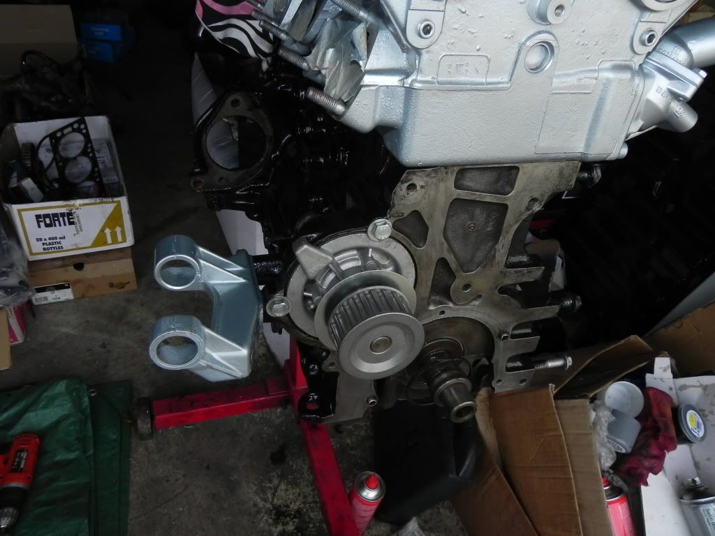

dizzy and cambelt back plate
http://i193.photobucket.com/albums/z...8/DSCN2493.jpg
http://i193.photobucket.com/albums/z...8/DSCN2497.jpg

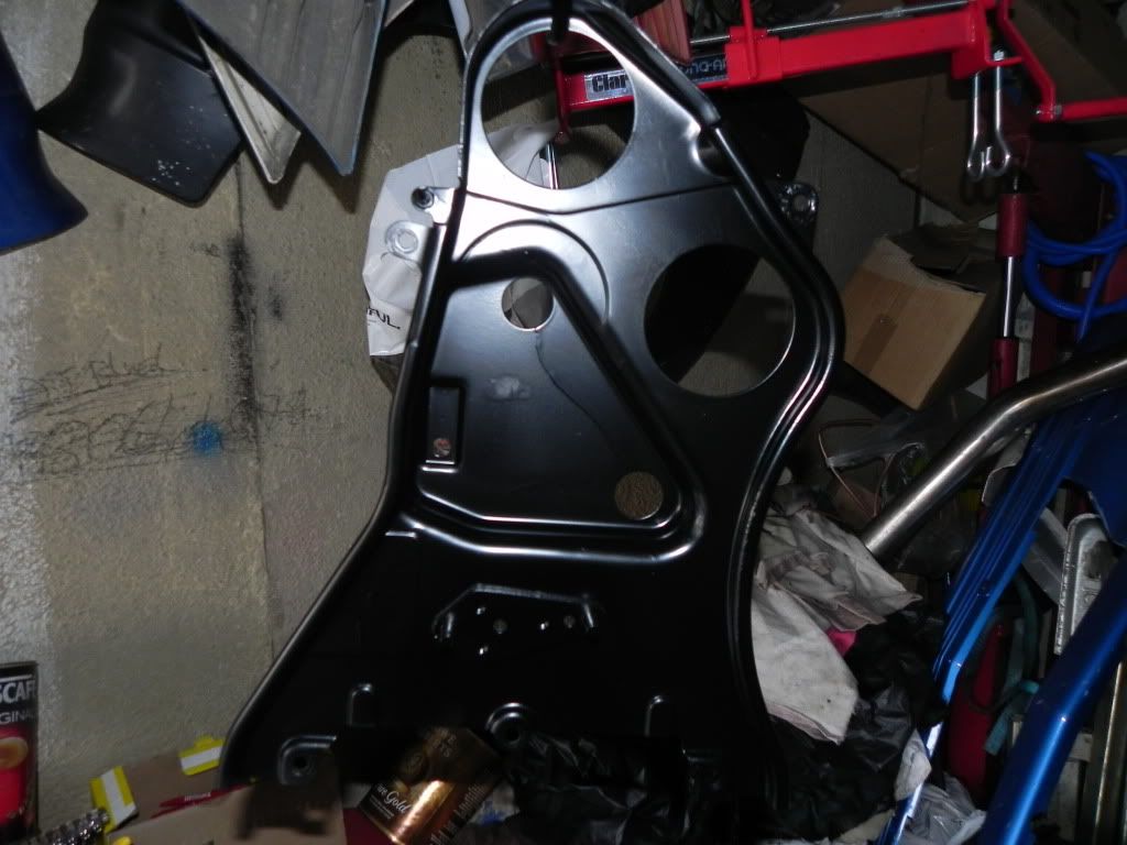

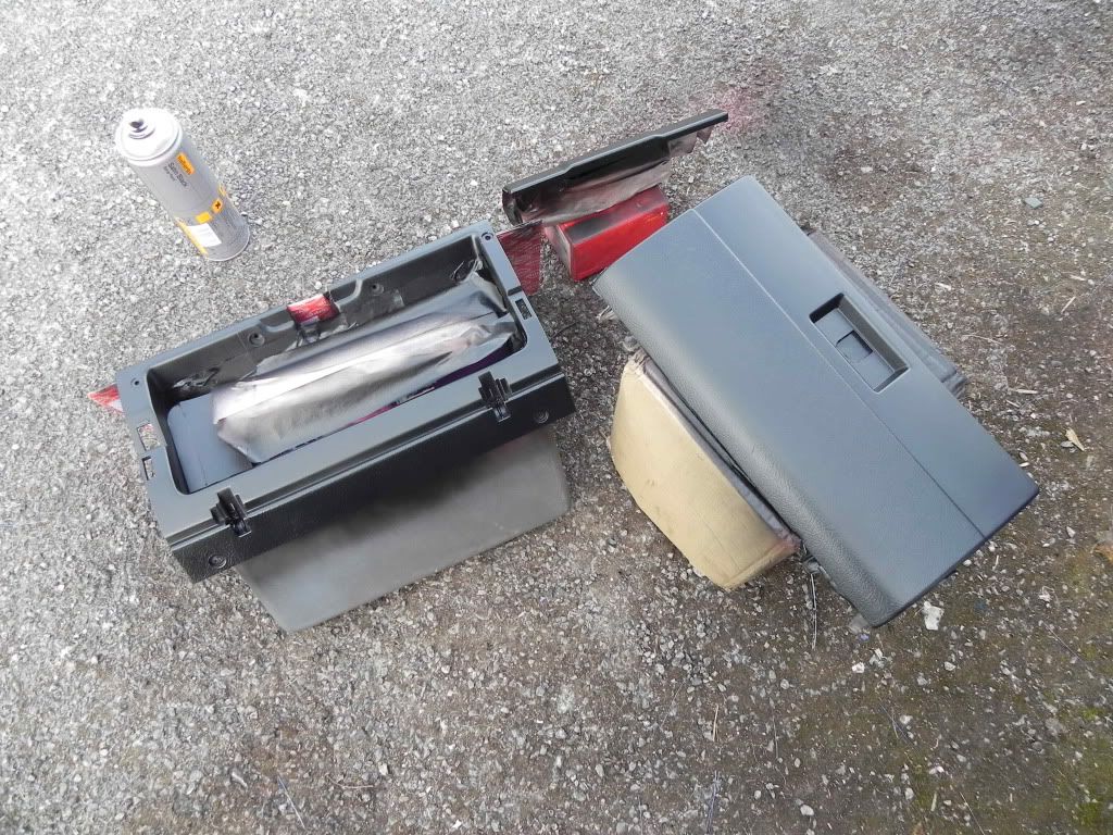

majority of dash parts painted satin black
http://i193.photobucket.com/albums/z...8/DSCN2494.jpg

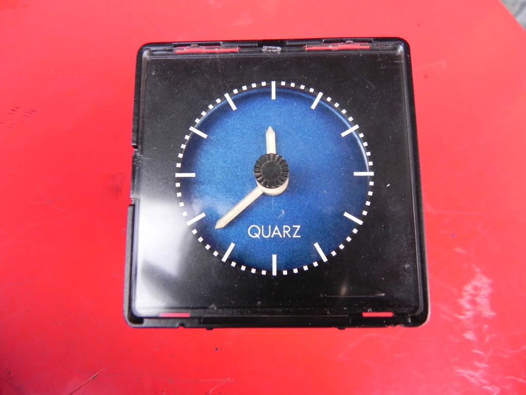

there are more than whats pictured, stripped down the clock and painted it
http://i193.photobucket.com/albums/z...8/DSCN2496.jpg

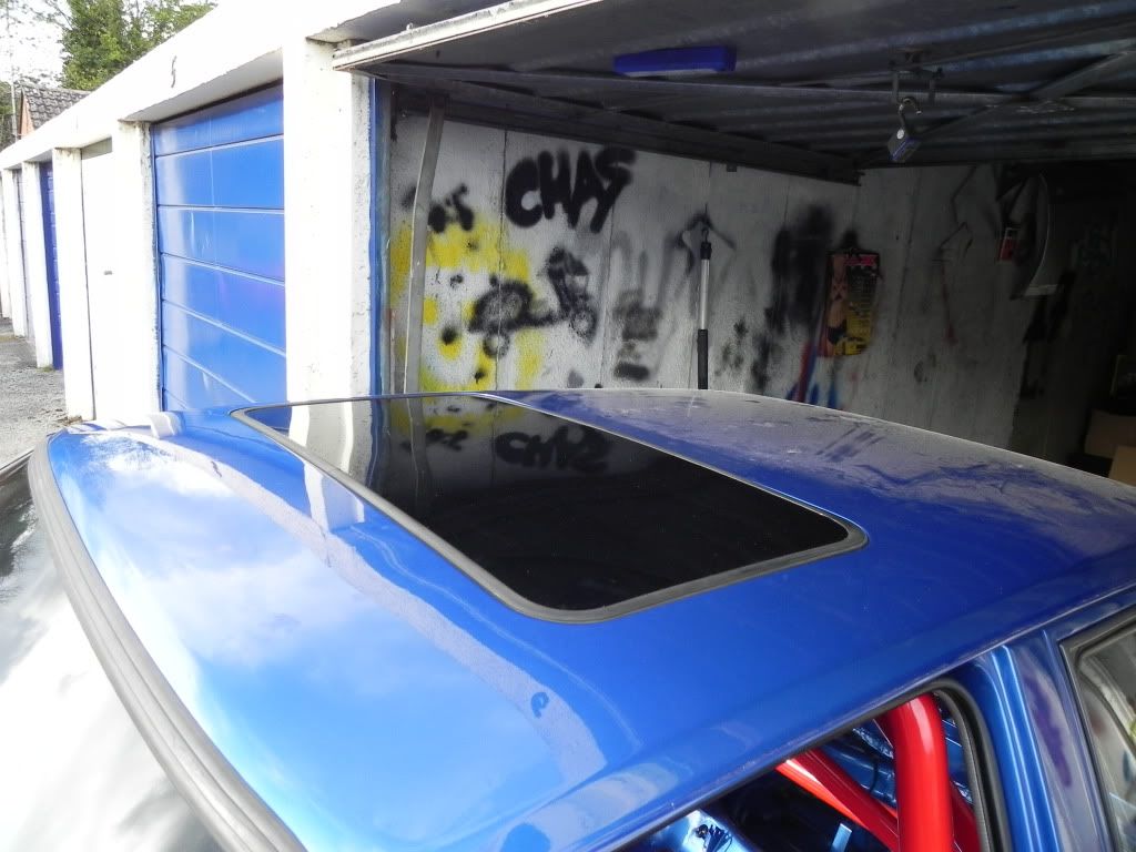

also got the sunroof finally fitted, still all works with the electric motor.
http://i193.photobucket.com/albums/z...8/DSCN2489.jpg
