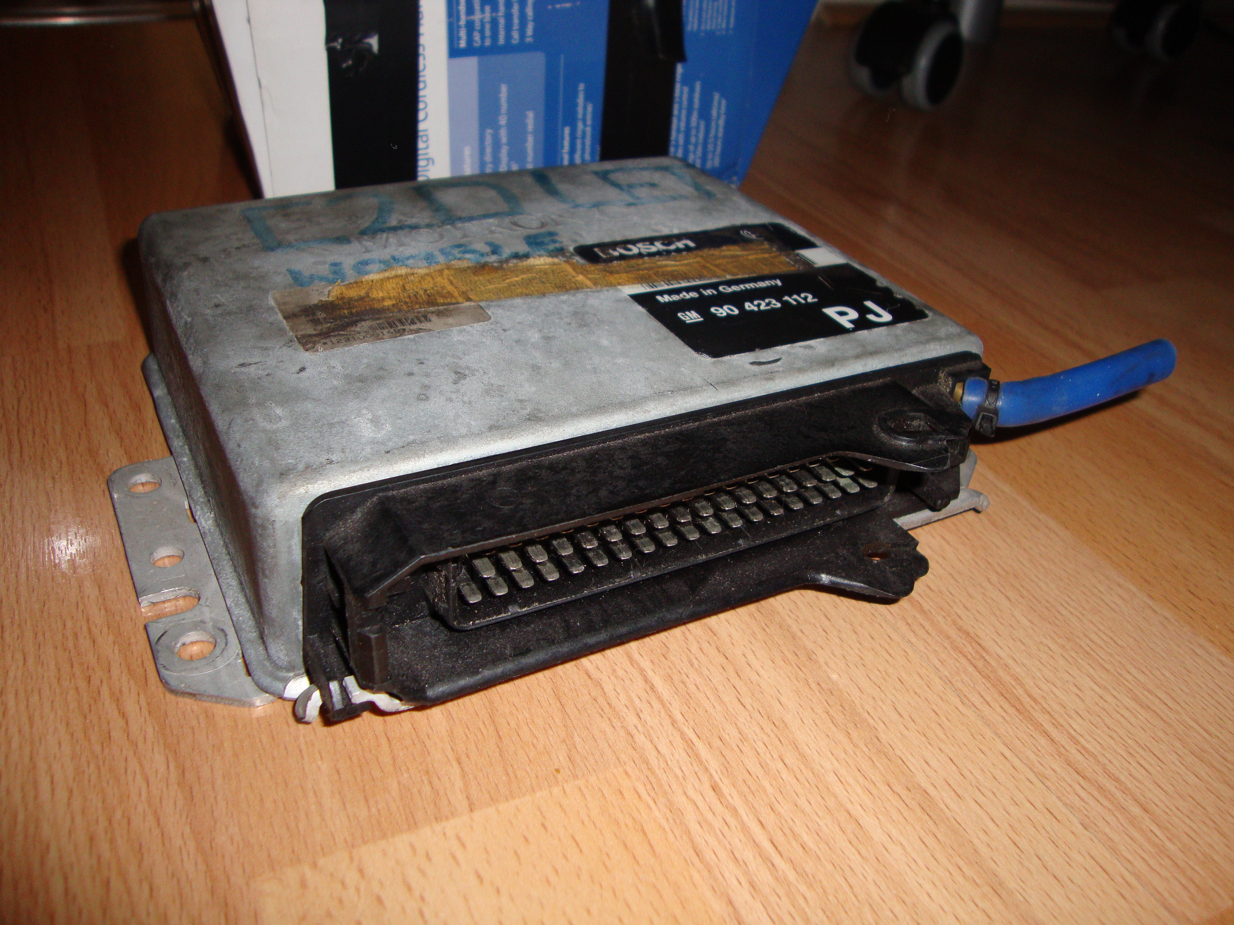

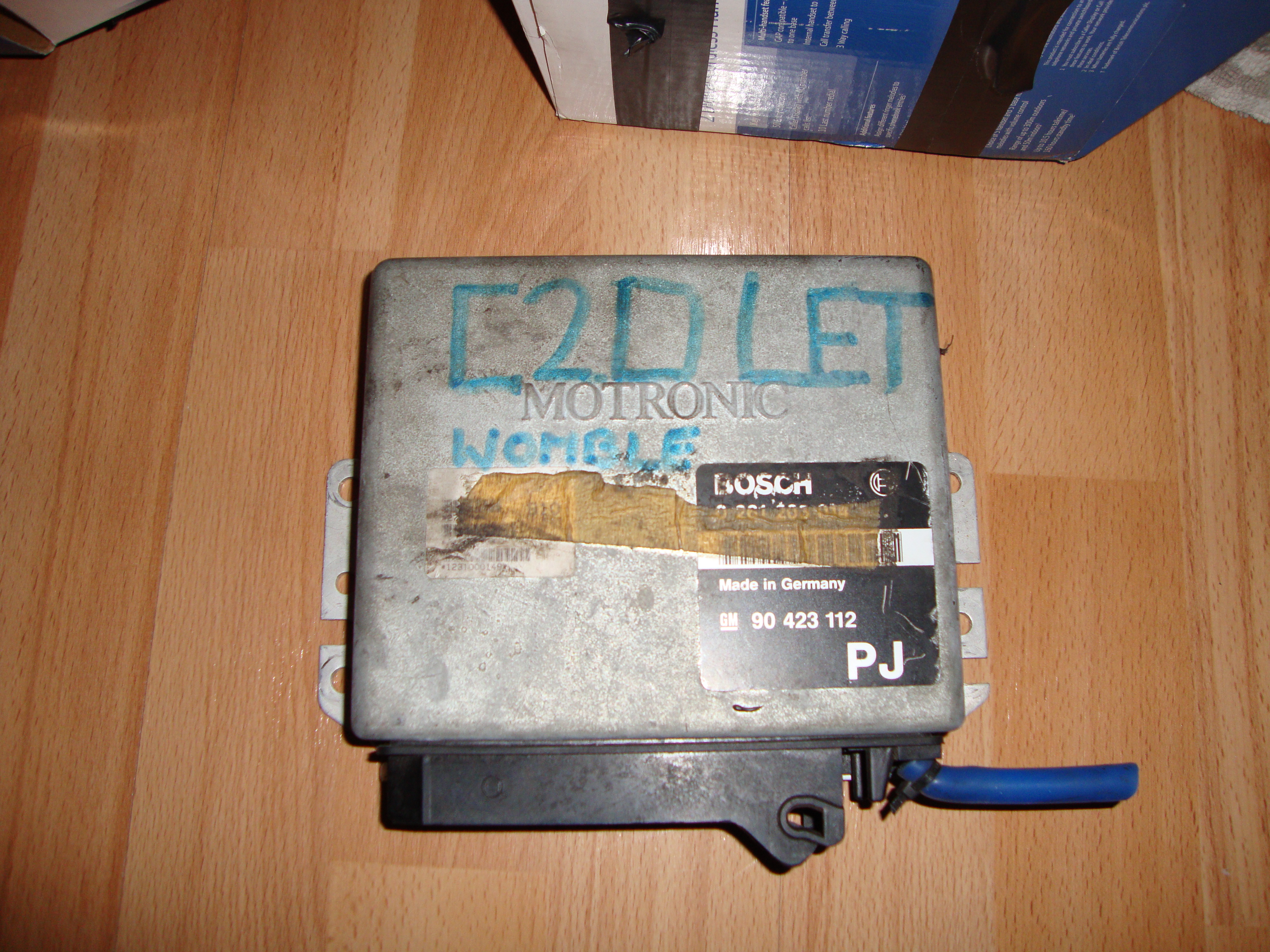

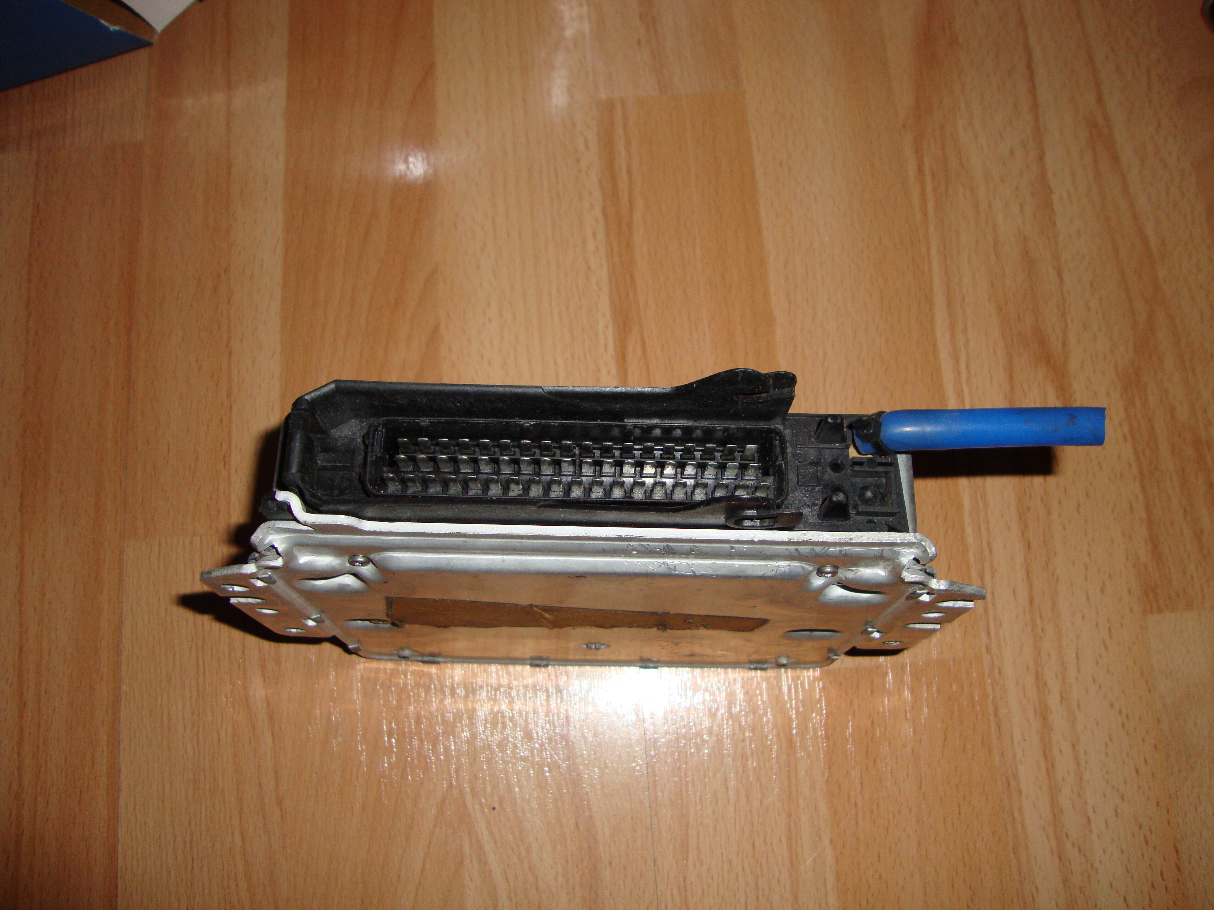

It's been a while, but sadly only a small update. Never the less, it's a part of the project which is still very much important as without these bits, it wouldn't get finished.
This time an extremely important part of the LET... the ECU. Bought it off -JELLY- on here (cheers pal ). Needs a bit of a clean up and wipe, but nothing I can't handle.
https://images2.imgbox.com/ad/c1/OsY09hCf_o.jpg
https://images2.imgbox.com/f1/51/Ad4k54Xa_o.jpg
https://images2.imgbox.com/6e/21/iZsFVSEZ_o.jpg
All the pins looking good.
Now I don't wanna sounds stupid, but what is the blue hose for?

Pipe will be for the vaccum/boost.

pipe from the ecu will go to a map sensor or vac signal line. there is a full schematic diagram of the LET loom & it's sensors floating about somewhere.
I'm a carb guy mate lol
Cheers for the explanation of the Vac line.
