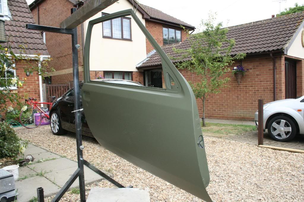

I then proceeded to rub down the high build primer on the N/S door
http://i248.photobucket.com/albums/g...painted090.jpg
Wiped it all down and shot it in the green, then hung it out to dry
http://i248.photobucket.com/albums/g...painted091.jpg
http://i248.photobucket.com/albums/g...painted092.jpg

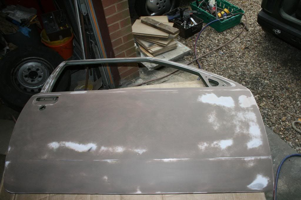

And moved on to the second door, all rubbed down and cleaned off ready to paint
http://i248.photobucket.com/albums/g...painted093.jpg
This was the point were disaster struck i w a n k e d the first coat on like a cu nt and it ran like forest gump (i think i mixed in a little too much thinners what a c ock) so that will need addressing tomorrow :mad:
T oss
http://i248.photobucket.com/albums/g...painted094.jpg

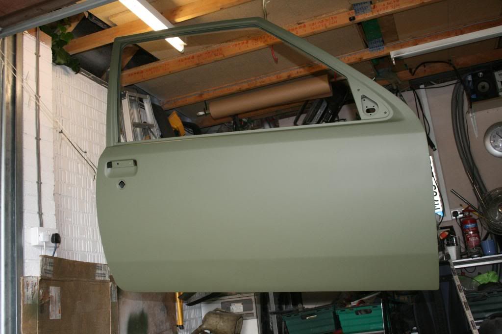

I started by amending the paint on the door issue by sanding it all back
http://i248.photobucket.com/albums/g...painted099.jpg
And painting it up - much better now
http://i248.photobucket.com/albums/g...painted100.jpg
hanging out to dry
http://i248.photobucket.com/albums/g...painted105.jpg

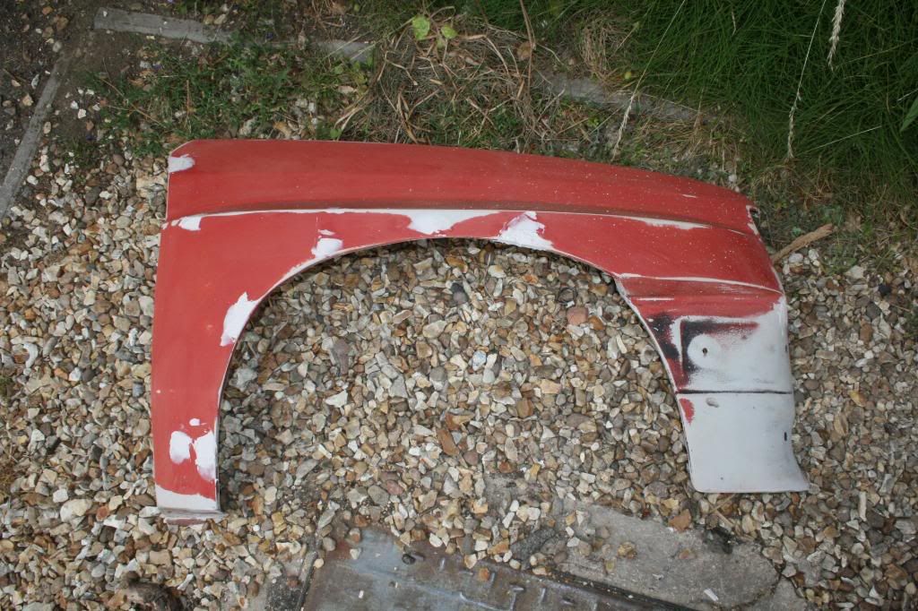

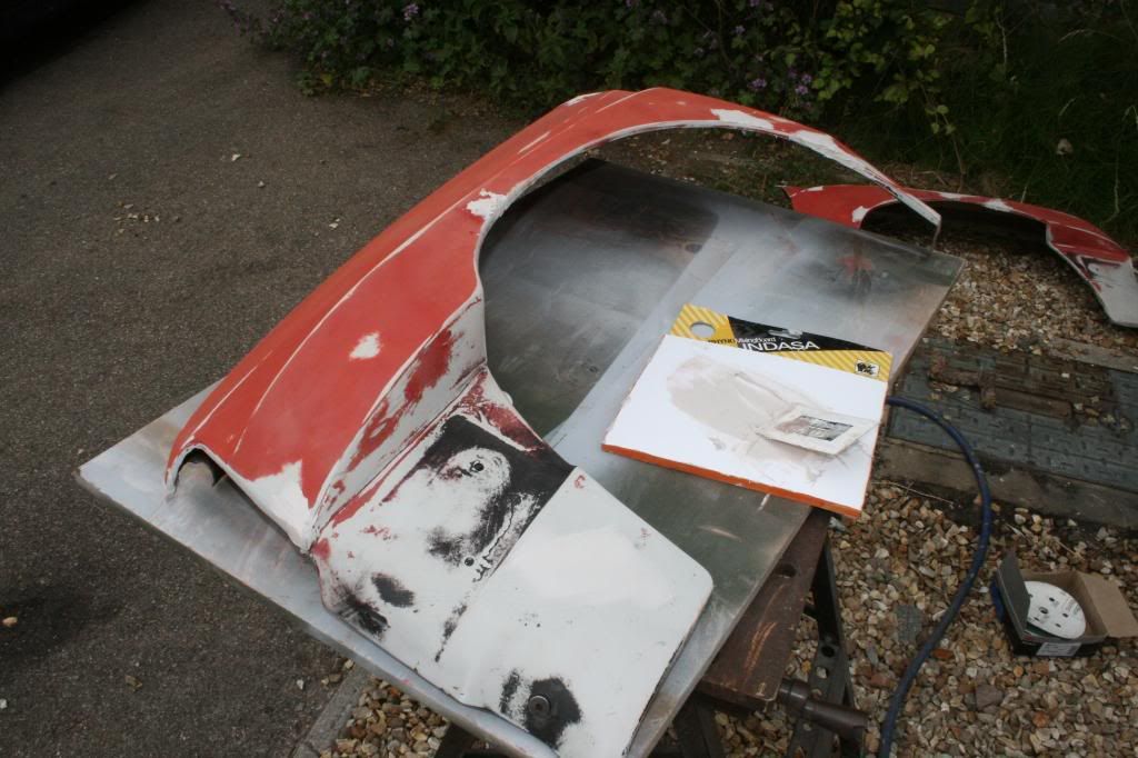

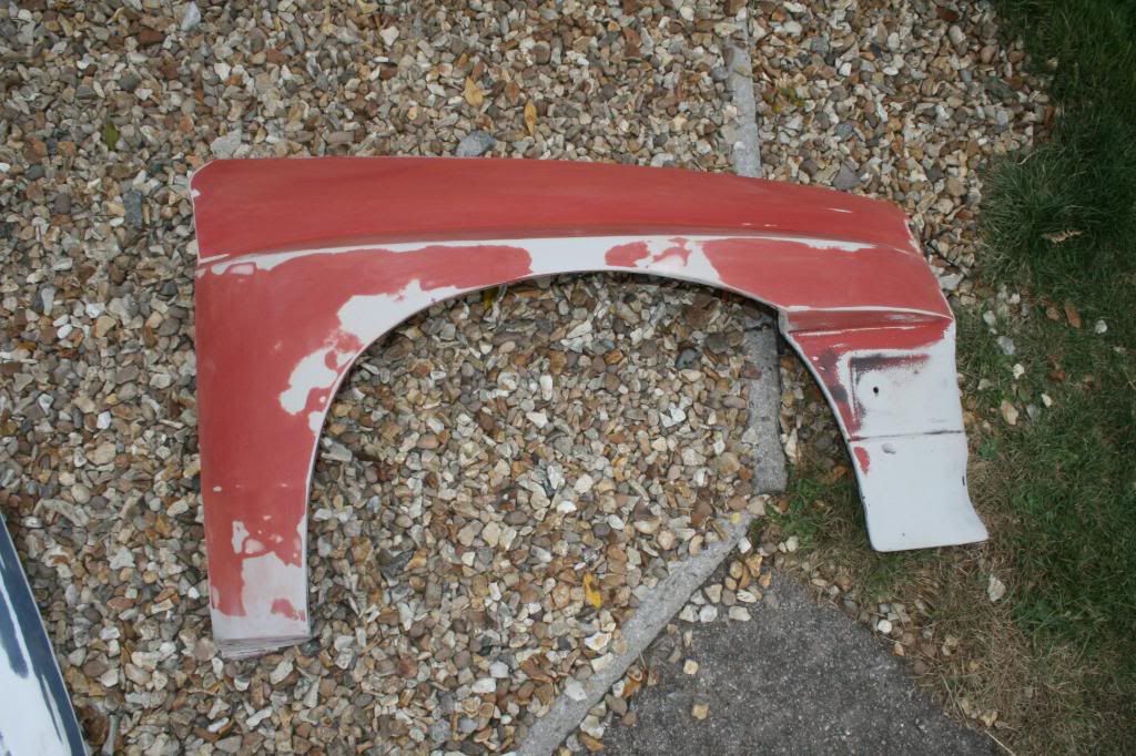

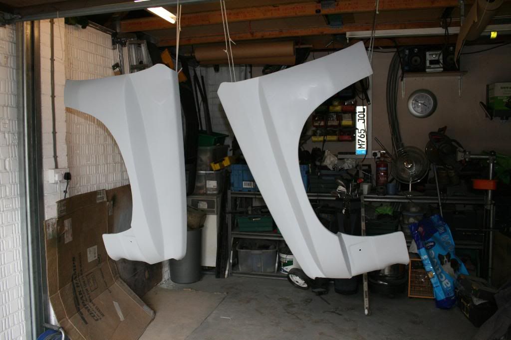

I moved swiftly on to the wings i fitted the head lights to check the fit of the wings on the car
http://i248.photobucket.com/albums/g...painted103.jpg

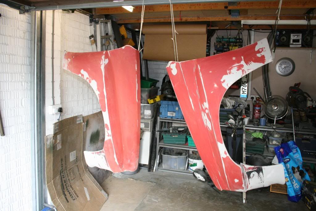

Th wings needed some sanding back, and a little filling
http://i248.photobucket.com/albums/g...painted102.jpg
http://i248.photobucket.com/albums/g...painted104.jpg
and some more sanding
http://i248.photobucket.com/albums/g...painted107.jpg
http://i248.photobucket.com/albums/g...painted108.jpg
A good wipe down
http://i248.photobucket.com/albums/g...painted109.jpg

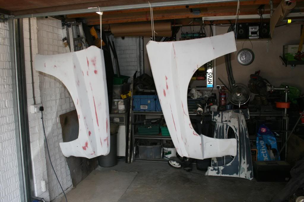

then primer
http://i248.photobucket.com/albums/g...painted110.jpg
Sanded the primer back using 150 grit (as it was high build and it went on heavy with some runs, bugs and general sh1te in it) then 320 grit to finish it
http://i248.photobucket.com/albums/g...painted111.jpg
http://i248.photobucket.com/albums/g...painted112.jpg
http://i248.photobucket.com/albums/g...painted113.jpg

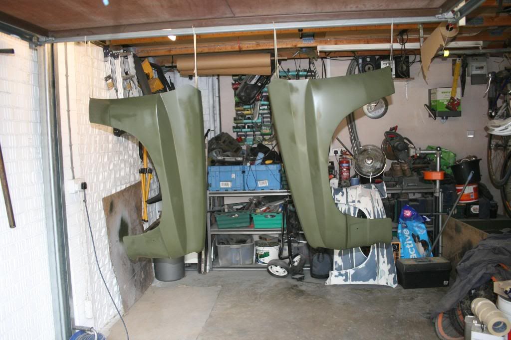

and painted
http://i248.photobucket.com/albums/g...painted114.jpg

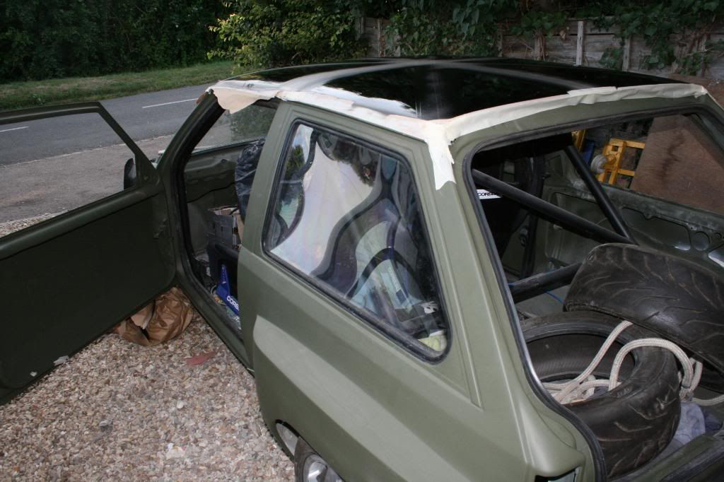

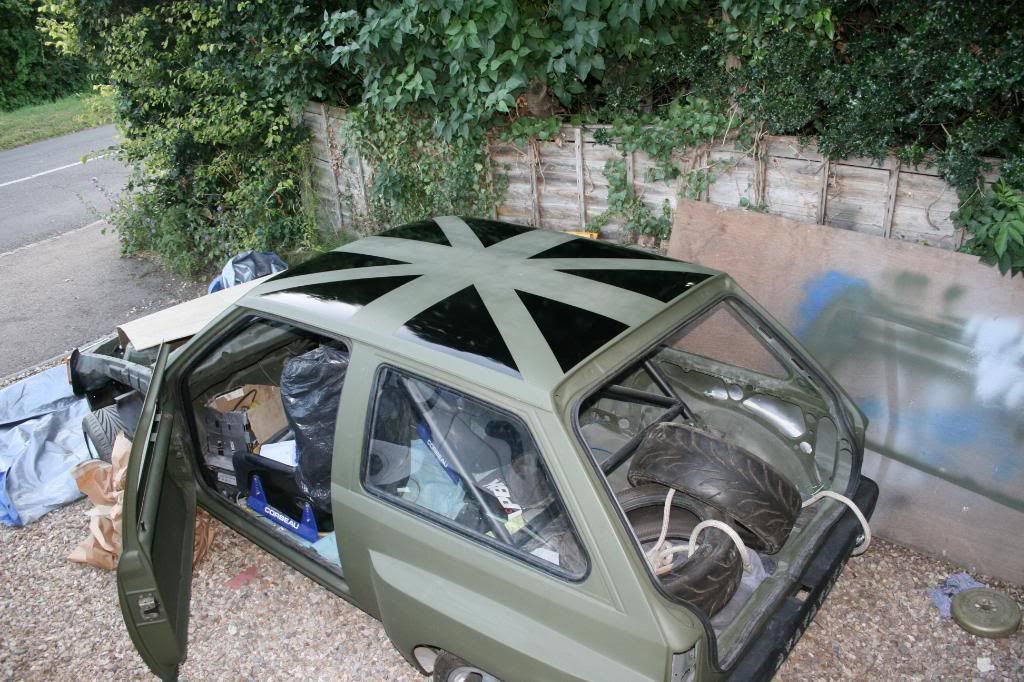

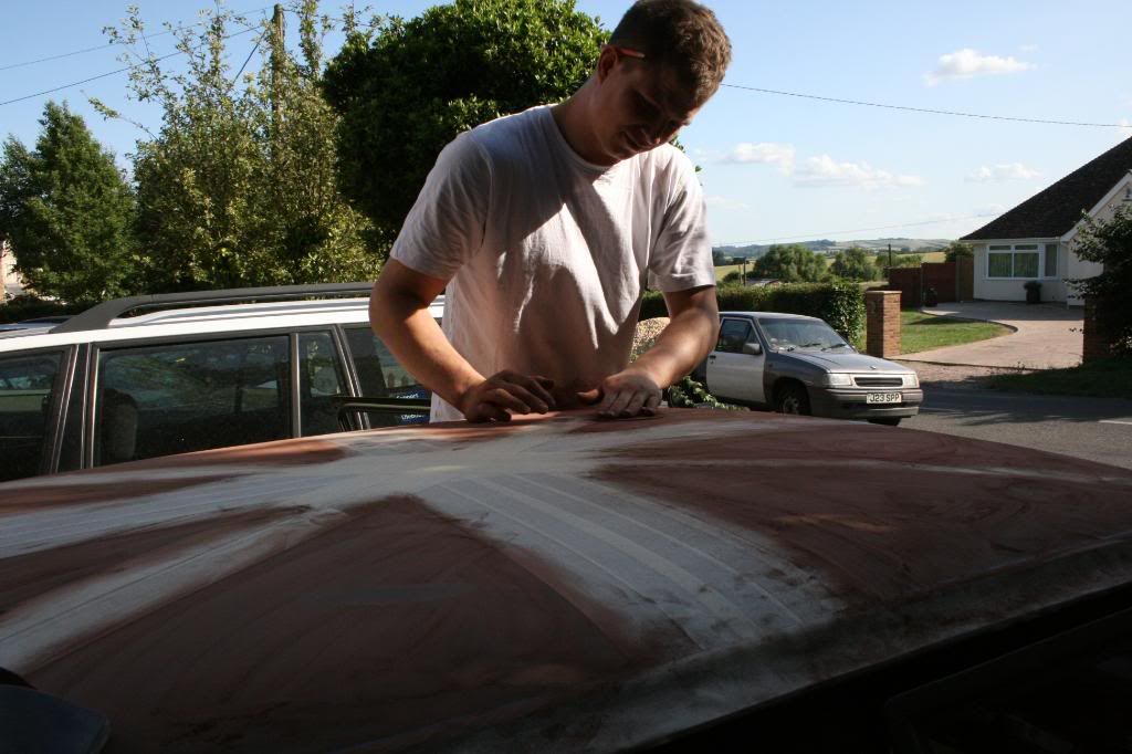

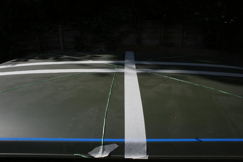

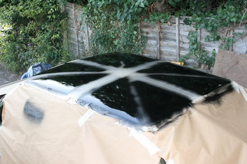

Leaving the wings to dry i moved on to some head scratching, measuring and lining out in the roof area
http://i248.photobucket.com/albums/g...painted116.jpg
http://i248.photobucket.com/albums/g...painted119.jpg

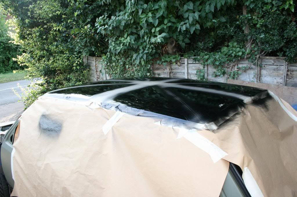

can you guess what it is?....after masking up there was you guessed it some more sanding
http://i248.photobucket.com/albums/g...painted121.jpg
Then some colour
http://i248.photobucket.com/albums/g...painted123.jpg
http://i248.photobucket.com/albums/g...painted126.jpg
Its come out well but its not finished - i have the smaller lines in the middle to do yet, thought it would be some thing a little different
http://i248.photobucket.com/albums/g...painted130.jpg
http://i248.photobucket.com/albums/g...painted131.jpg

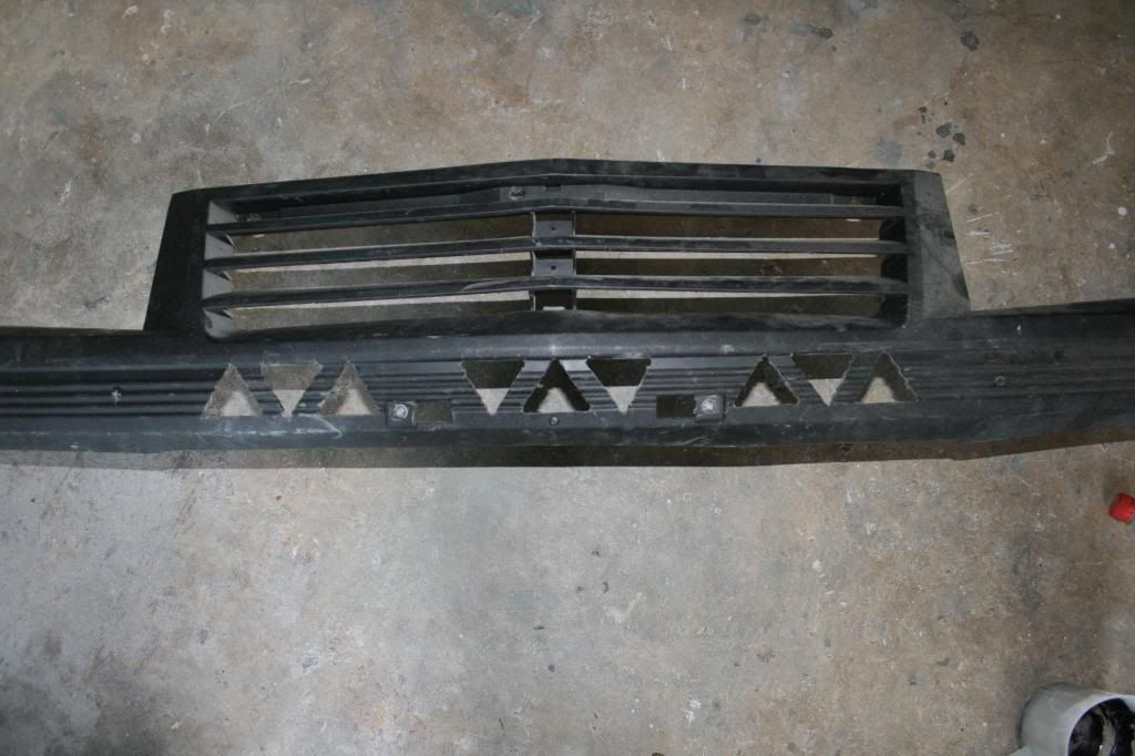

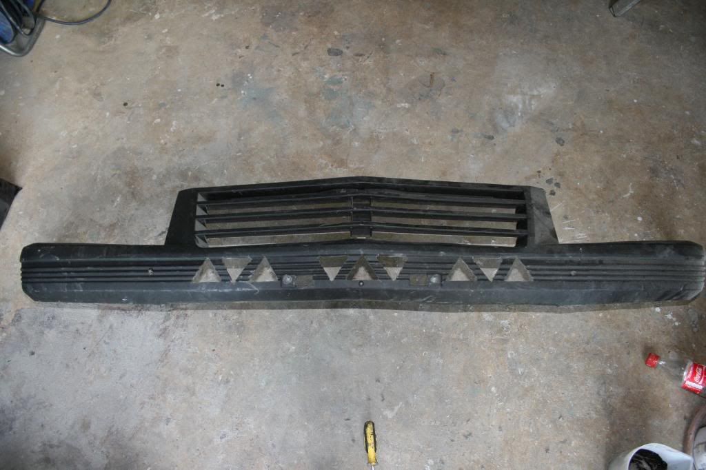

And cut some triangles in the front bumper
http://i248.photobucket.com/albums/g...painted127.jpg
http://i248.photobucket.com/albums/g...painted128.jpg

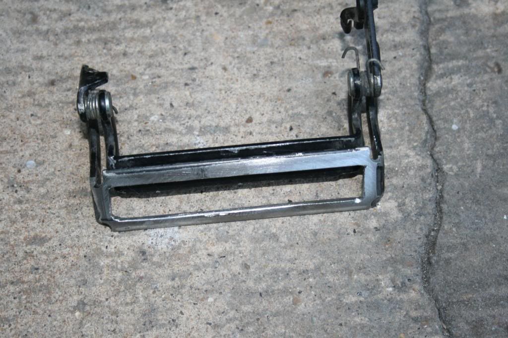

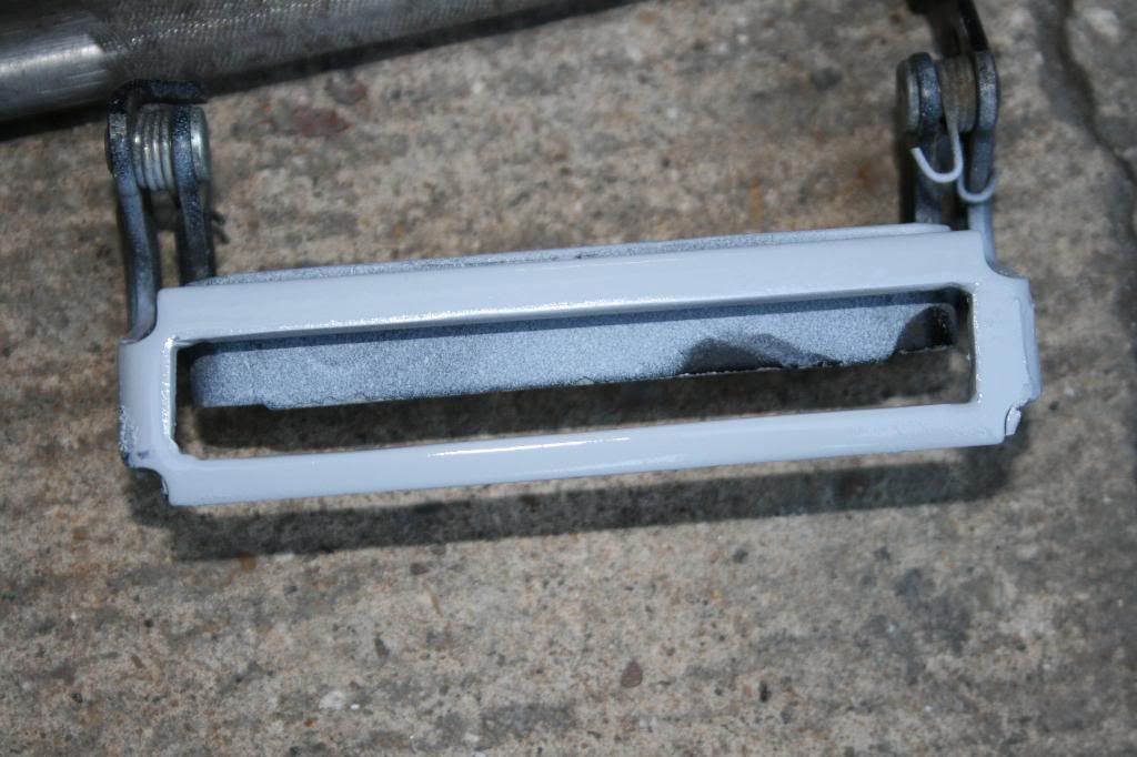

Along with lightening one of the door handles prior to priming
http://i248.photobucket.com/albums/g...painted132.jpg
http://i248.photobucket.com/albums/g...painted133.jpg
http://i248.photobucket.com/albums/g...painted134.jpg

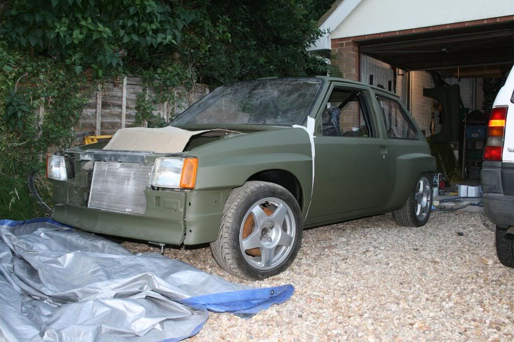

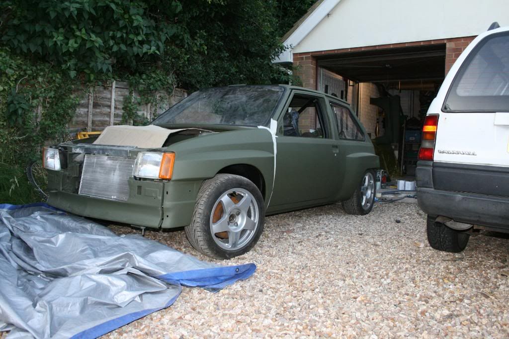

And to finish a couple of pics with the front wings balanced on
http://i248.photobucket.com/albums/g...painted135.jpg
http://i248.photobucket.com/albums/g...painted136.jpg

Awesome work, i wouldnt sand primer back with anything more than 320 tho.
Love the handles! Roof looks cool as, but looks to far forward...?
The bonnet is sitting on some card board and a massive sheet of tarpaulin so its higher than it would be just sitting on the turrets :thumb:Quote:
Originally Posted by Geordie-Chris
Edited on the sanding methods just for you Benn lolQuote:
The roof has a gap at the front also its just a w a n k picture
lol ok dude, but you might find you'll see some sanding marks thru the paint even after a 320. 800 will get runs out.. and cool cool. Do love the car.
