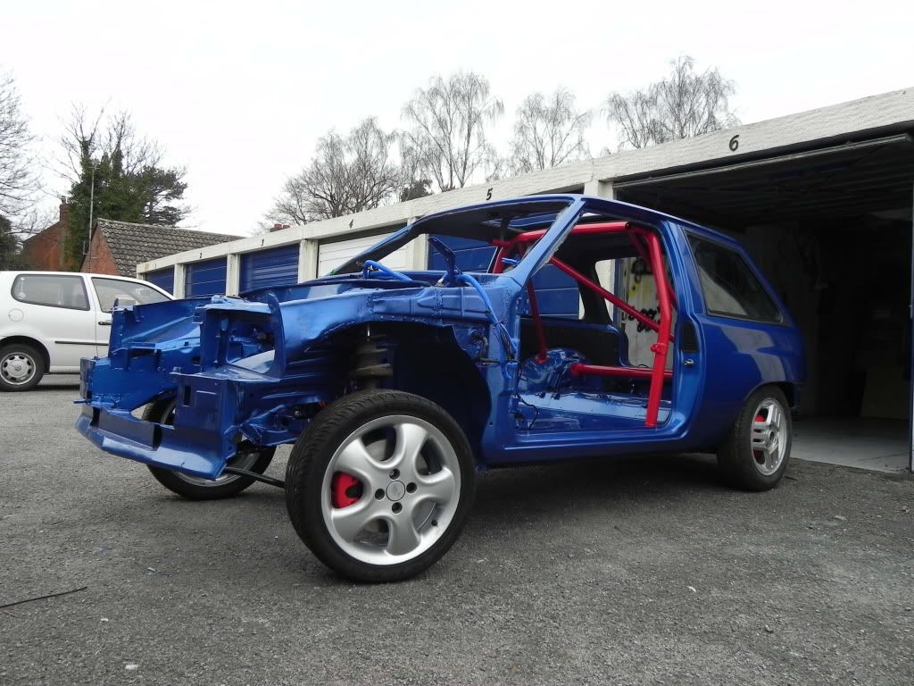

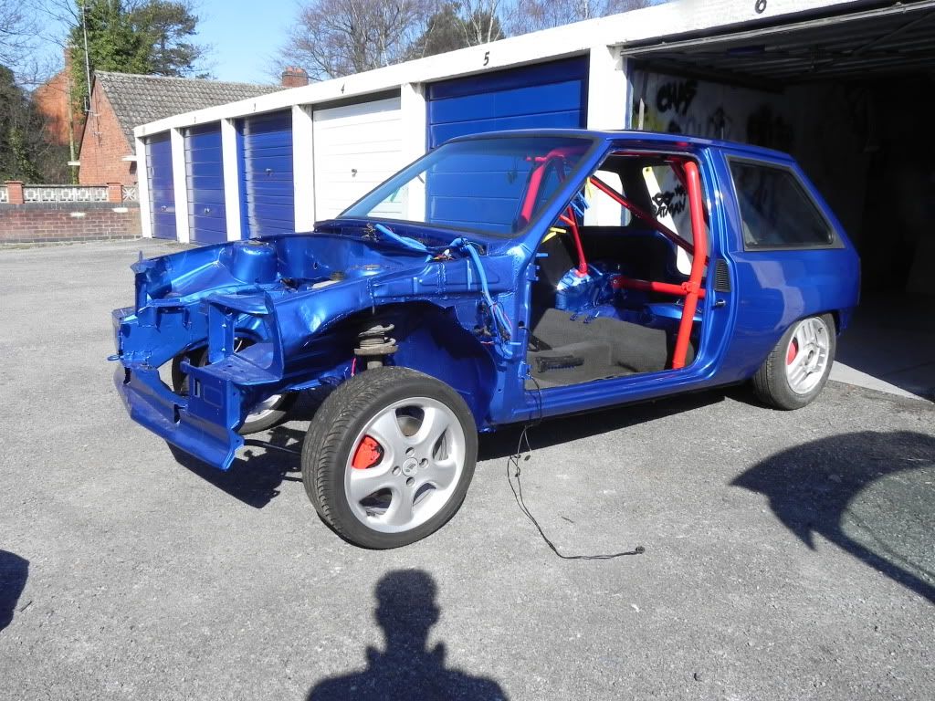

today i had a great day working on the car, got pretty much all i wanted to done. its coming along great at the moment.

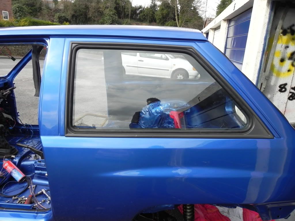

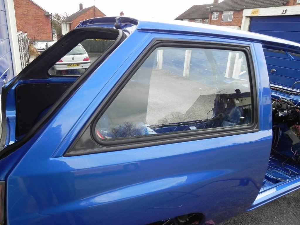

to start off i got the rear glass and surrounds in. as usual i used the strip method and some small angled prickers to peel up what the string didnt.
http://i193.photobucket.com/albums/z...8/DSCN2351.jpg
http://i193.photobucket.com/albums/z...8/DSCN2353.jpg

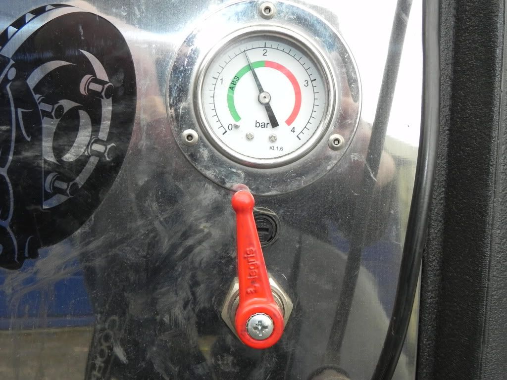

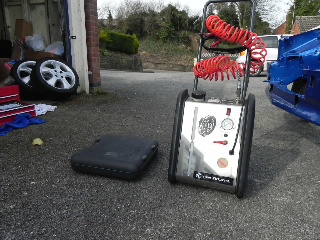

after that i coupled up the brake pressure bleeder i borrowed from work.
http://i193.photobucket.com/albums/z...8/DSCN2345.jpg
had 2 leaking brake nuts, just needed another nip up and they held pressure. bled all four corners and left the pressure bleeder connected for 2 hours. fortunately the compressor inside it never came on once which indicated i had no leaks. result. have got quite a decent pedal now.

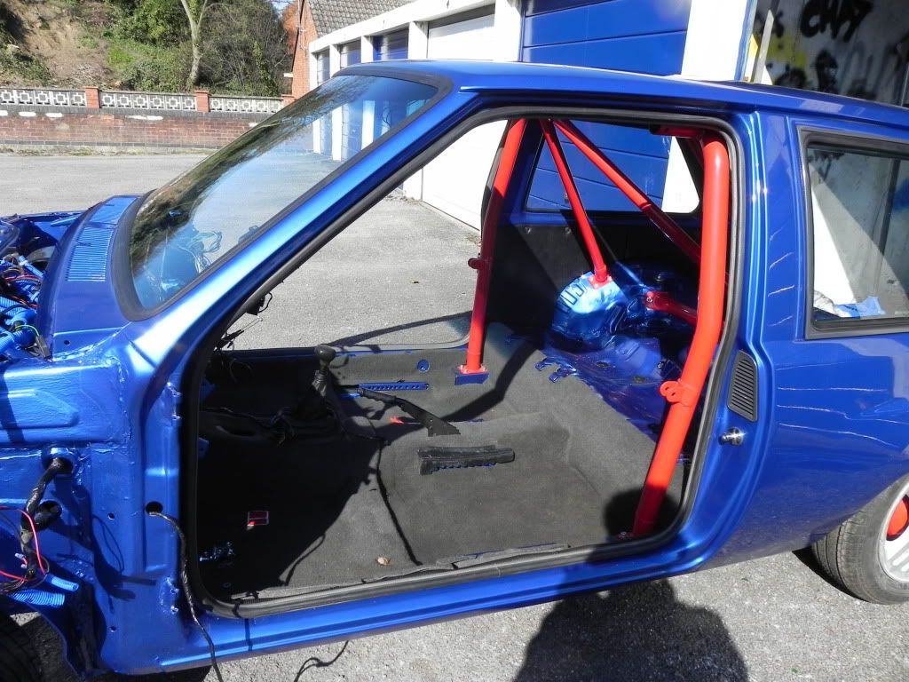

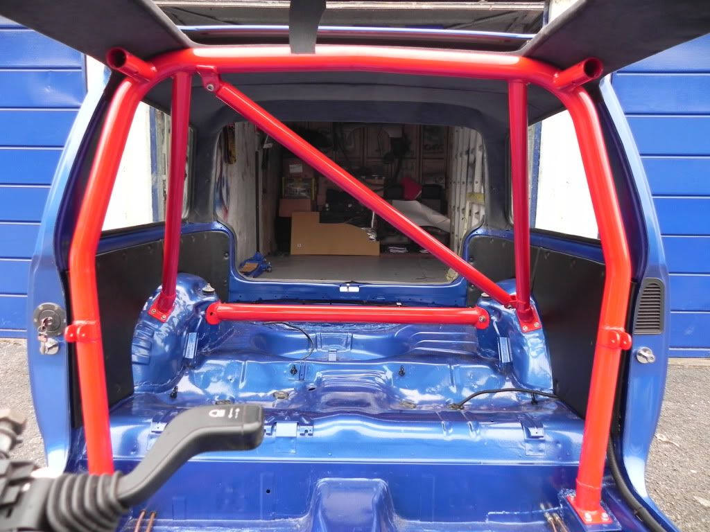

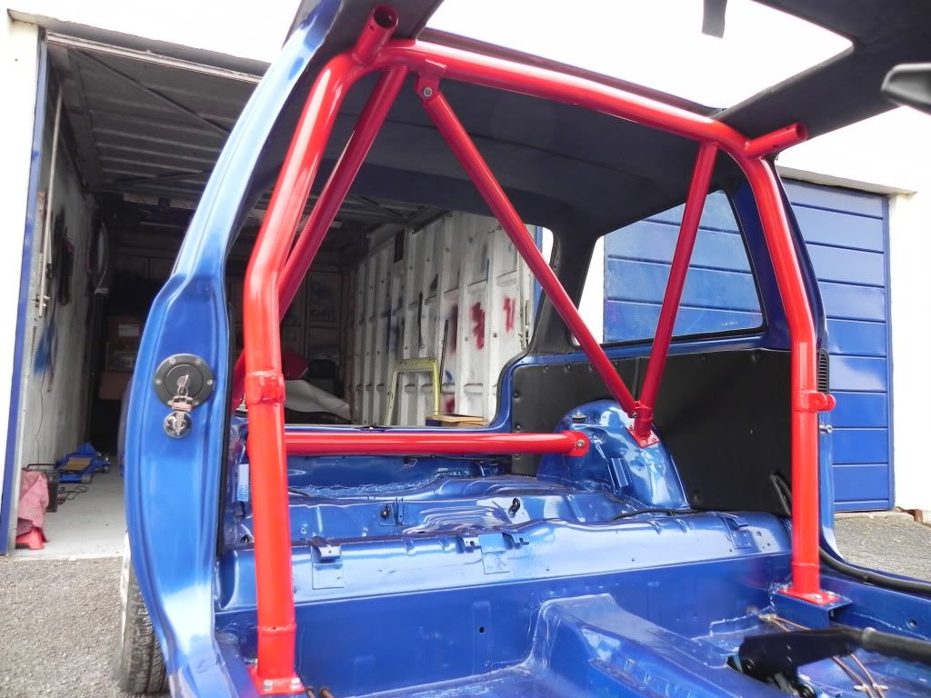

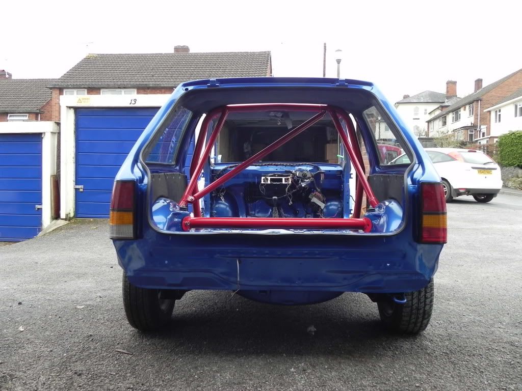

once i was happy with the brakes i slipped the cage in, fastened it down with stainless cap head bolts.
http://i193.photobucket.com/albums/z...8/DSCN2357.jpg
http://i193.photobucket.com/albums/z...8/DSCN2362.jpg
http://i193.photobucket.com/albums/z...8/DSCN2363.jpg
http://i193.photobucket.com/albums/z...8/DSCN2359.jpg
http://i193.photobucket.com/albums/z...8/DSCN2356.jpg
sexy you might think! :d

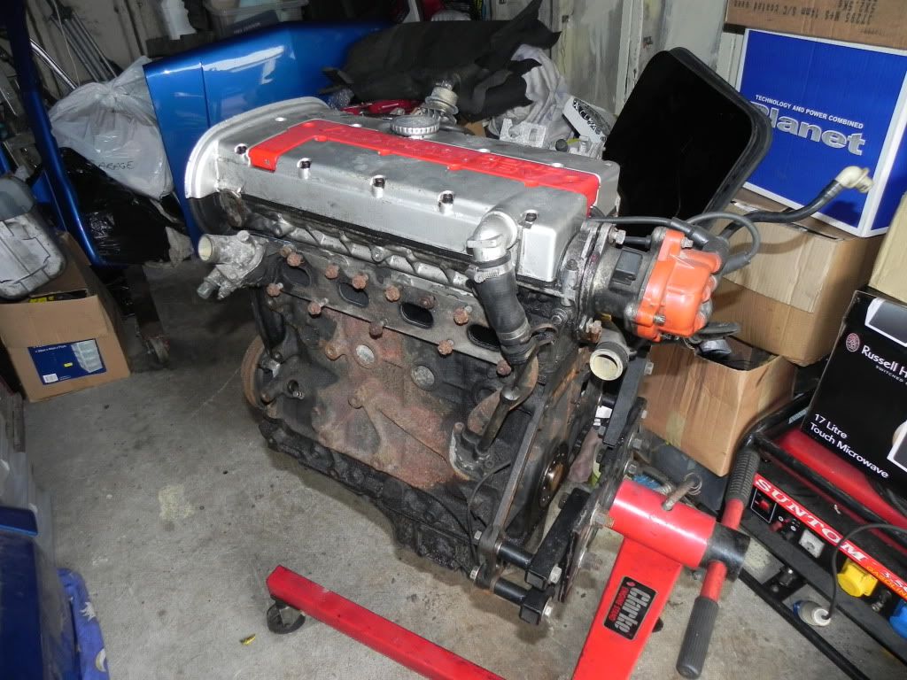

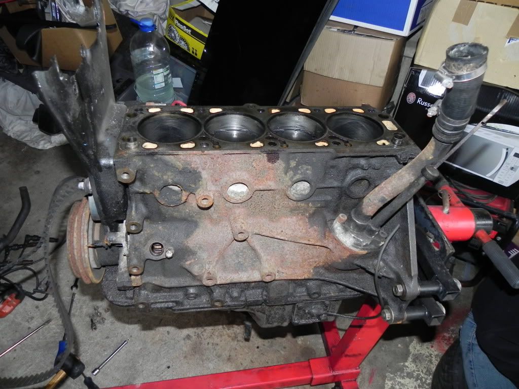

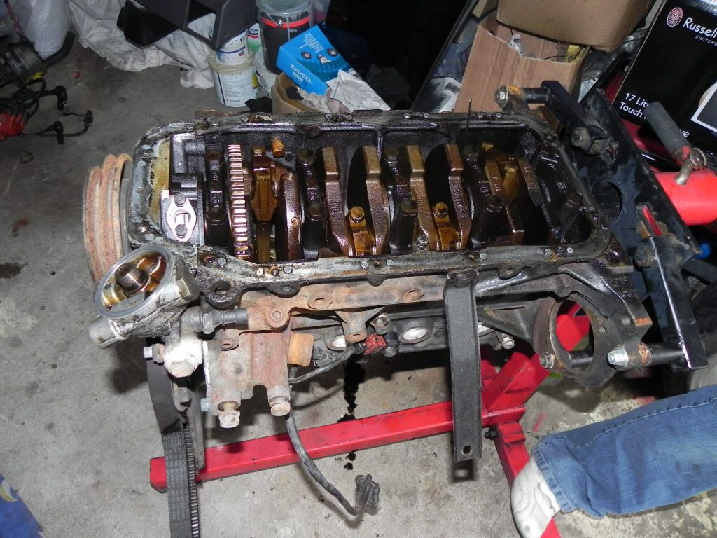

had enough of the car so i moved on to the engine. had to dig it out from all the crap that had gathered around it the last year or so.
one XE.
http://i193.photobucket.com/albums/z...8/DSCN2366.jpg

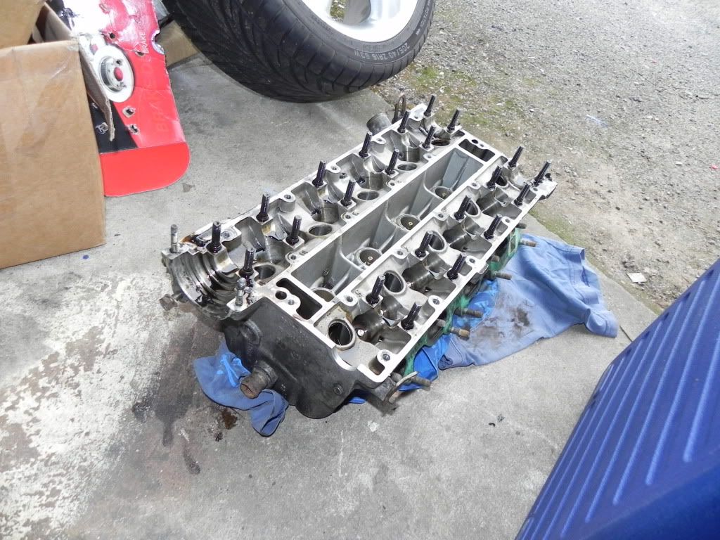

whipped the head off and inspected it quickly. will take it to work and strip it down for the clean up and rebuild.
http://i193.photobucket.com/albums/z...8/DSCN2373.jpg
http://i193.photobucket.com/albums/z...8/DSCN2372.jpg
removed the sump,pick up pipe and baffle.
http://i193.photobucket.com/albums/z...8/DSCN2374.jpg
the bolts on the crank pulley are mega rusty, didnt attempt to undo them as i will take it to work and try get them undone with any means necessary.

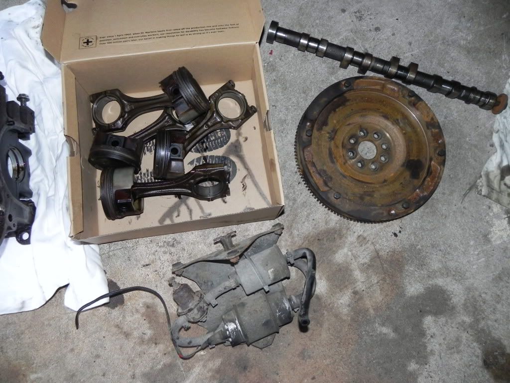

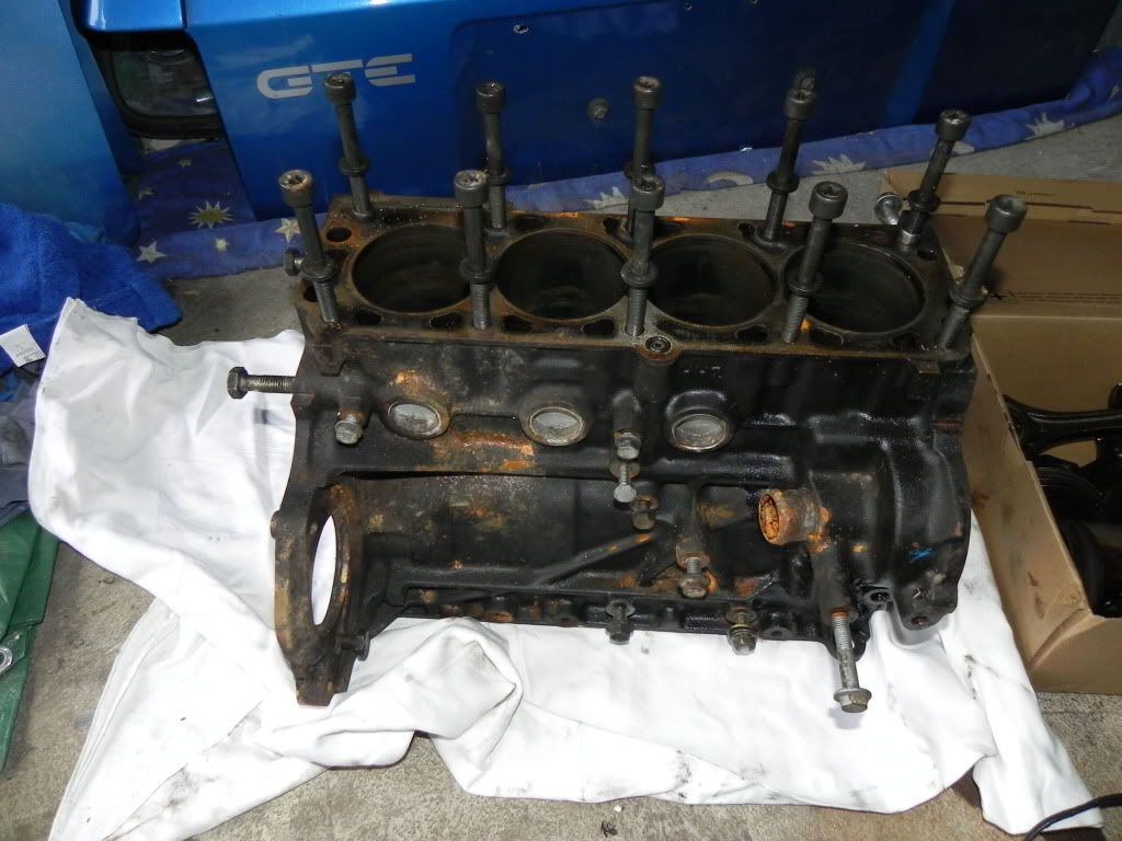

heres some pics of what i bought the other night off cemex.
one LET block
http://i193.photobucket.com/albums/z...8/DSCN2375.jpg
4 pistons, exhaust cam, pot flywheel and fuel pump form an LET.
http://i193.photobucket.com/albums/z...8/DSCN2376.jpg
hoping the rebuild of the LET engine should commence over the next month.

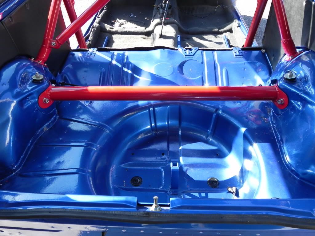

the rear brace was finally tightened down with stainless cap head bolts. the nuts the other side do miss the coilovers, thank god.
http://i193.photobucket.com/albums/z...8/DSCN2433.jpg

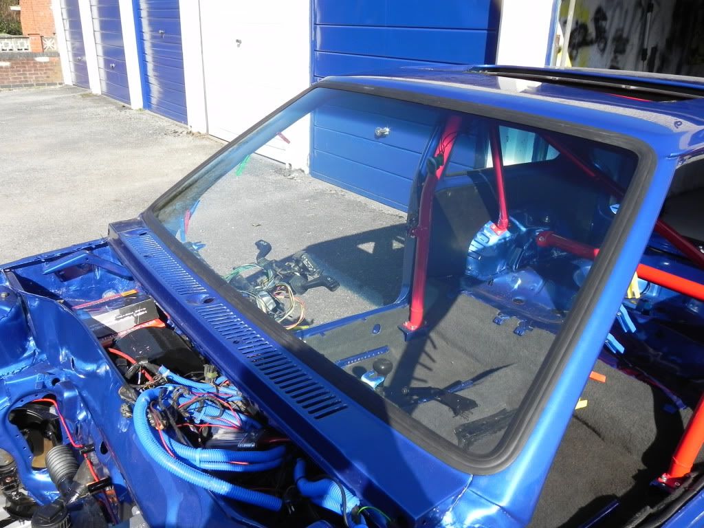

had a brand new screen and seal fitted today, think it was well worth it as the screen is gleaming clean.
http://i193.photobucket.com/albums/z...8/DSCN2435.jpg
http://i193.photobucket.com/albums/z...8/DSCN2436.jpg

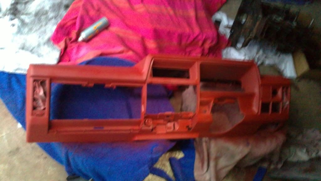

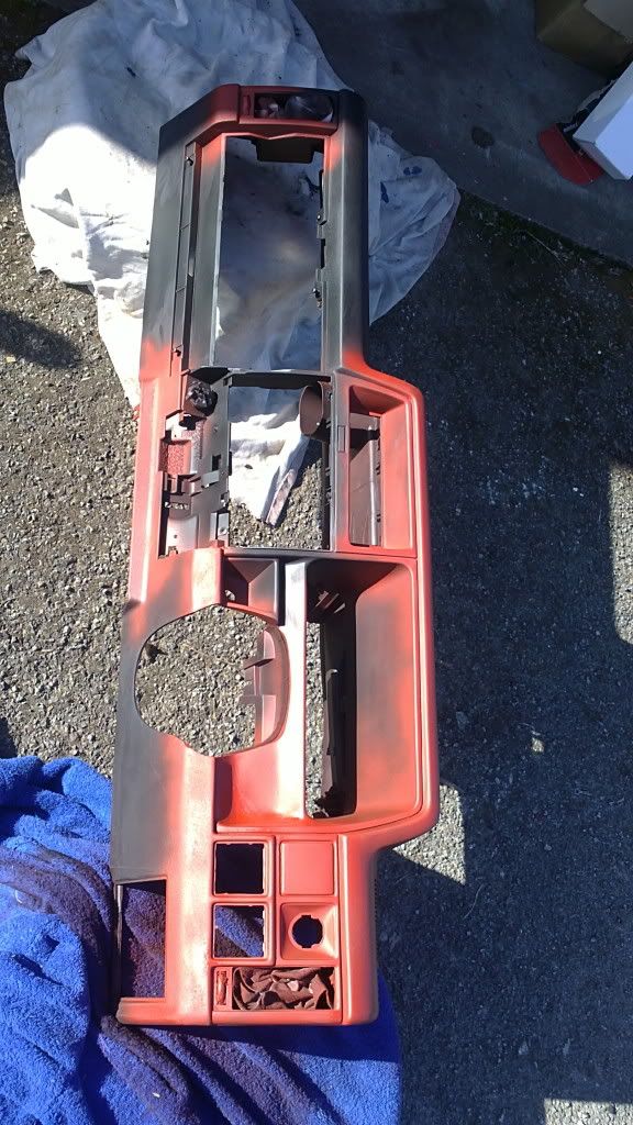

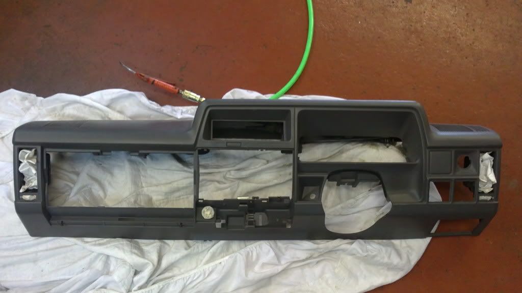

got the dash out and cleaned it up from any dirt and dust it had on it.
http://i193.photobucket.com/albums/z...6032011113.jpg

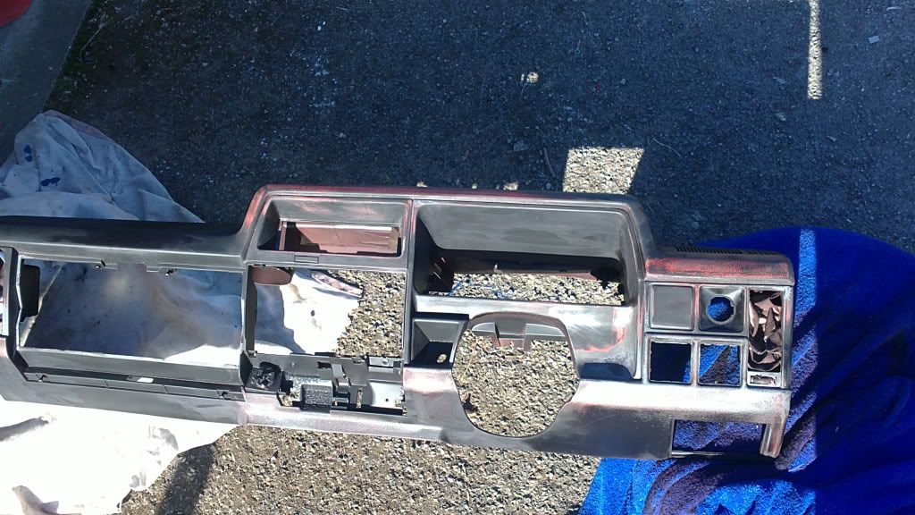

the only plastic primer they had in halfords was red, owell had to use it.
http://i193.photobucket.com/albums/z...6032011114.jpg
i then gave it a couple coats of satin black (as advised by nova_tek) and left it to dry. came back in the morning to find some parts had a reaction, havnt a clue why. so i rubbed down those areas and primed them again.
http://i193.photobucket.com/albums/z...9032011120.jpg
http://i193.photobucket.com/albums/z...9032011122.jpg

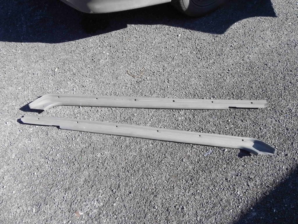

ive now ran out of paint so this is on hold for now. i got to buy some more anyway as ive got to paint the rest of the dash peices and the sill trims.

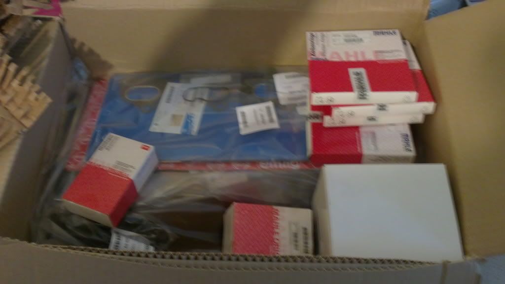

i gave autovaux a call on thursday to order my engine rebuild parts. managed to get free delivery in as it was my first order. top quality service and the parcel arrived friday. cant complain.
so far i have got; head gasket set with z-let steel head gasket, bottem end gasket kit with 8v sump gasket/baffle, big end bearing shells, mains bearing shells, water pump, piston rings and head bolts.
still got other things to buy like arp rod bolts etc etc.
