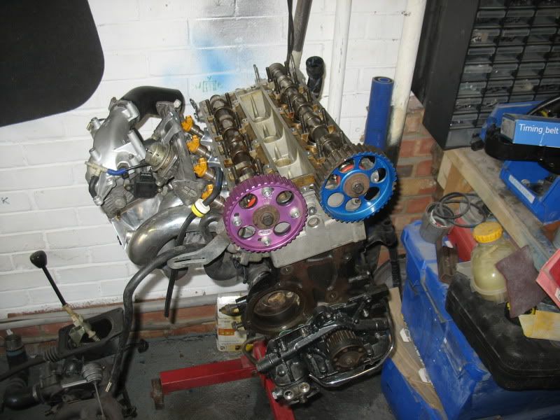

So found out yesterday that the water pump was wrong, as it was a late one. GGrrr, got that out, then me and Dan set about setting the timing and cams up with the adjustable pulley on the inlet.
So to day i wanted to get my inlet manifold built up and on..

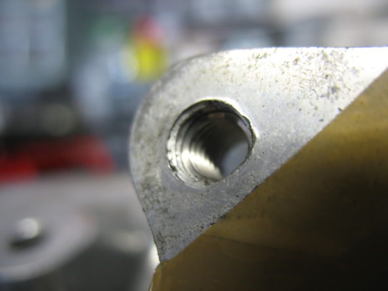

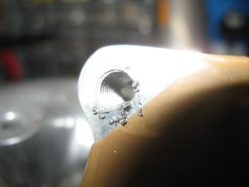

First thing was remove the tb to see why the bolts had come undone. Did this to find the thread had pulled out of both holes.
http://img.photobucket.com/albums/v3...n/IMG_9597.jpg
Set and tapping and helicoiling them to fix it.
Drilled and tapped.
http://img.photobucket.com/albums/v3...n/IMG_9598.jpg
Coil in.
http://img.photobucket.com/albums/v3...n/IMG_9600.jpg

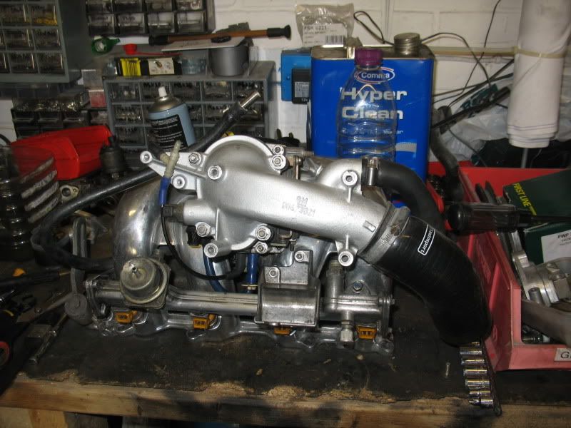

Tb cleaned and refitted with a new gasket. Rebuild inlet. Really annoyed, i have a chromed fuel rail that i rebuild some where, cant find it for the life of me.. So a dirty one will have to do for the time.
http://img.photobucket.com/albums/v3...n/IMG_9607.jpg
Clean surface ready for new inlet gasket and get all fitted.
http://img.photobucket.com/albums/v3...n/IMG_9620.jpg
Made sure these can all be got at from under the car just in case... Polished the jubliee clips too.

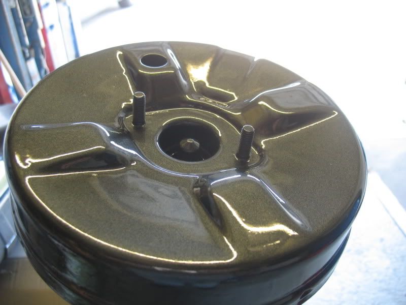

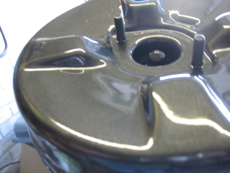

Found that the lacquar had moved the base colour on the servo, so you could see the black i had used as a pre base.. So flatted it all off and repainted.
http://img.photobucket.com/albums/v3...n/IMG_9621.jpg
Looks ok..

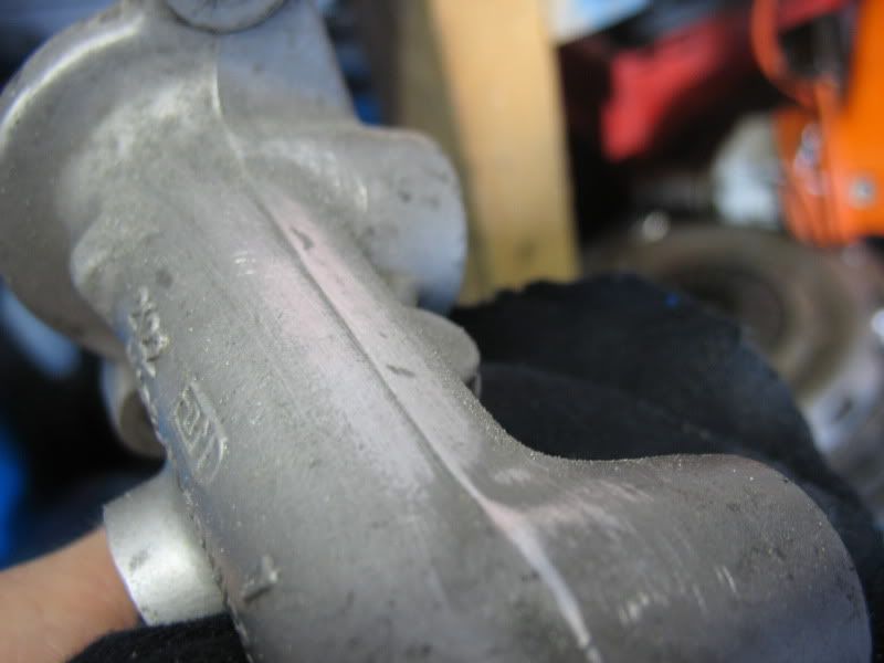

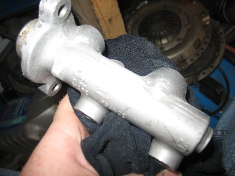

Mc looked dirty, so cleaned it off, smoothed it a bit..
http://img.photobucket.com/albums/v3...n/IMG_9606.jpg
http://img.photobucket.com/albums/v3...n/IMG_9603.jpg
Its now been painted grey to match the servo, think that should look ok...

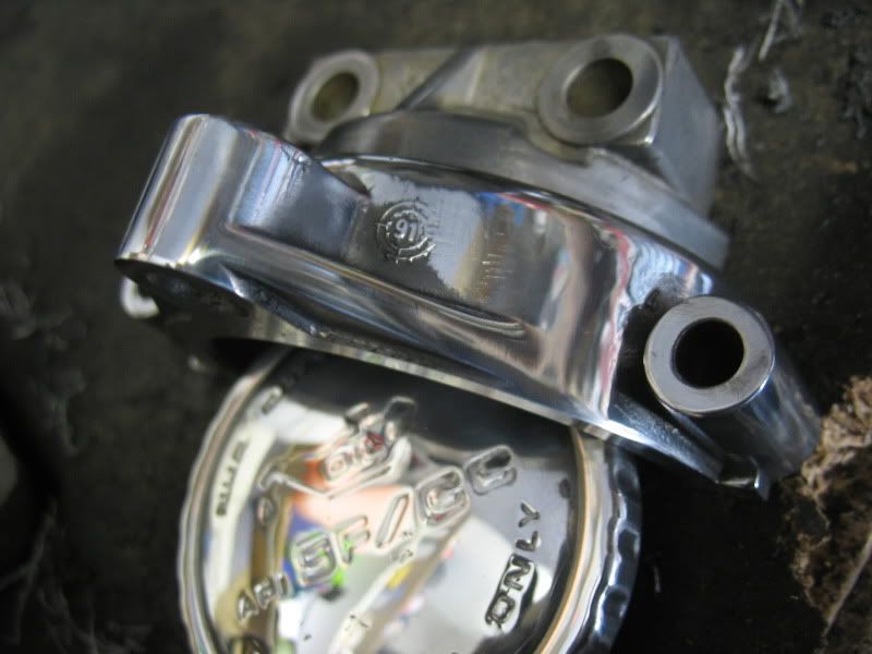

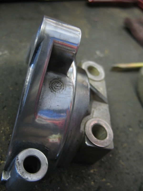

This bit gets forgotten about by alot of people, but you can see it as the dizzy mounts to it. So if you have a nice sexy dizzy and rocker cover, this can let it down... So sanded and semi polished.
http://img.photobucket.com/albums/v3...n/IMG_9616.jpg

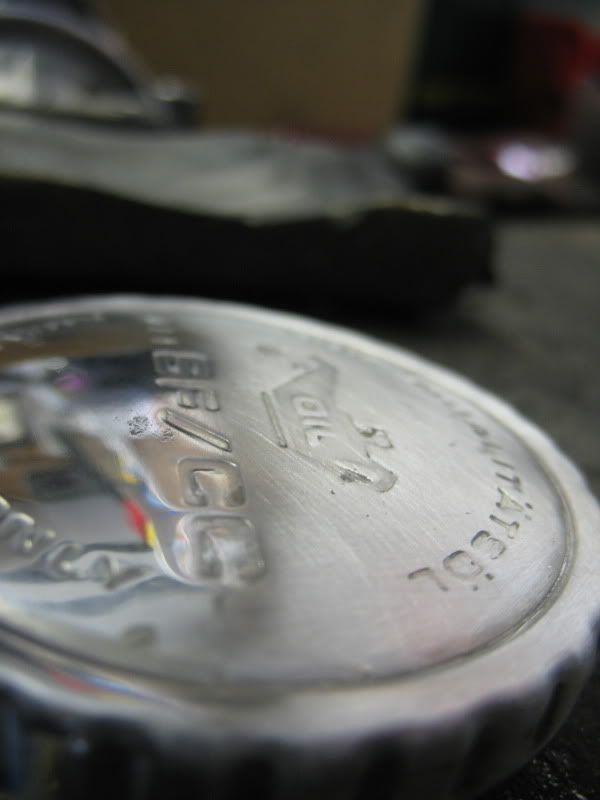

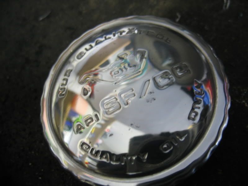

Started a new oil cap too... half and half jobbie..
http://img.photobucket.com/albums/v3...n/IMG_9614.jpg
Final buff.
http://img.photobucket.com/albums/v3...n/IMG_9618.jpg
And with the cam end too, need a tiny bit more on the soft head.
http://img.photobucket.com/albums/v3...n/IMG_9619.jpg

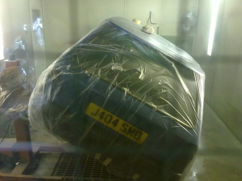

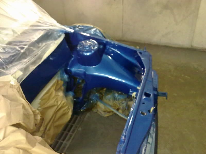

Body shop final got the tinter today to make the colour up.... So Roll on colour.

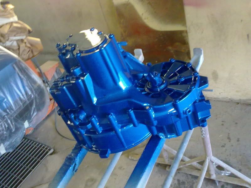

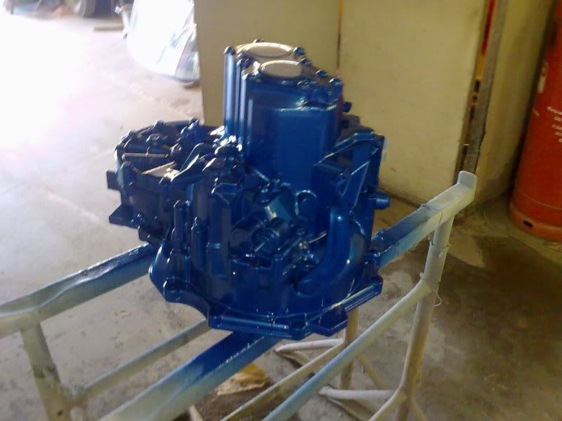

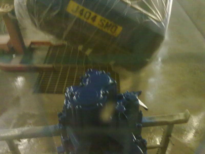

Gear box being painted...
http://img.photobucket.com/albums/v3...epaintjob3.jpg
Car all jacked up..
http://img.photobucket.com/albums/v3...epaintjob4.jpg
Gear box done... Well kinda... Needs more shiney...lol

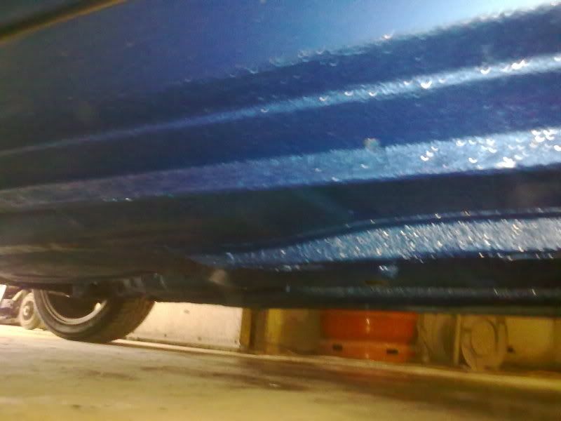

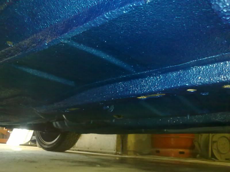

Under side, not the best pics as i was holding the phone on the floor..lol
http://img.photobucket.com/albums/v3...epaintjob1.jpg
http://img.photobucket.com/albums/v3...epaintjob5.jpg

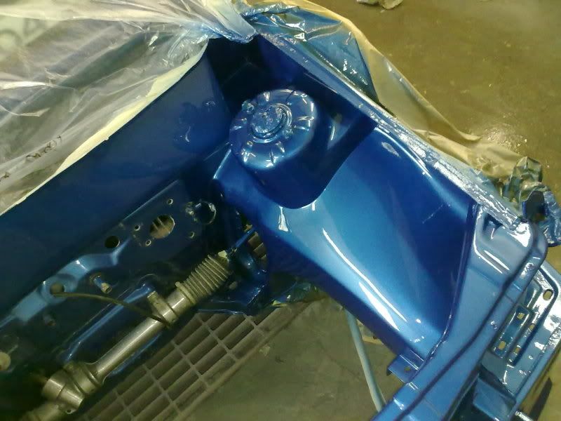

Engine bay...
http://img.photobucket.com/albums/v3...epaintjob7.jpg
http://img.photobucket.com/albums/v3...epaintjob9.jpg

Wahey! That underside looks very nice. Surprised you stonechipped the outer sill though incase it looks less smooth.
awwww new shiny parts and look a nice new shiny nova all new and wrapped!!!! lol
