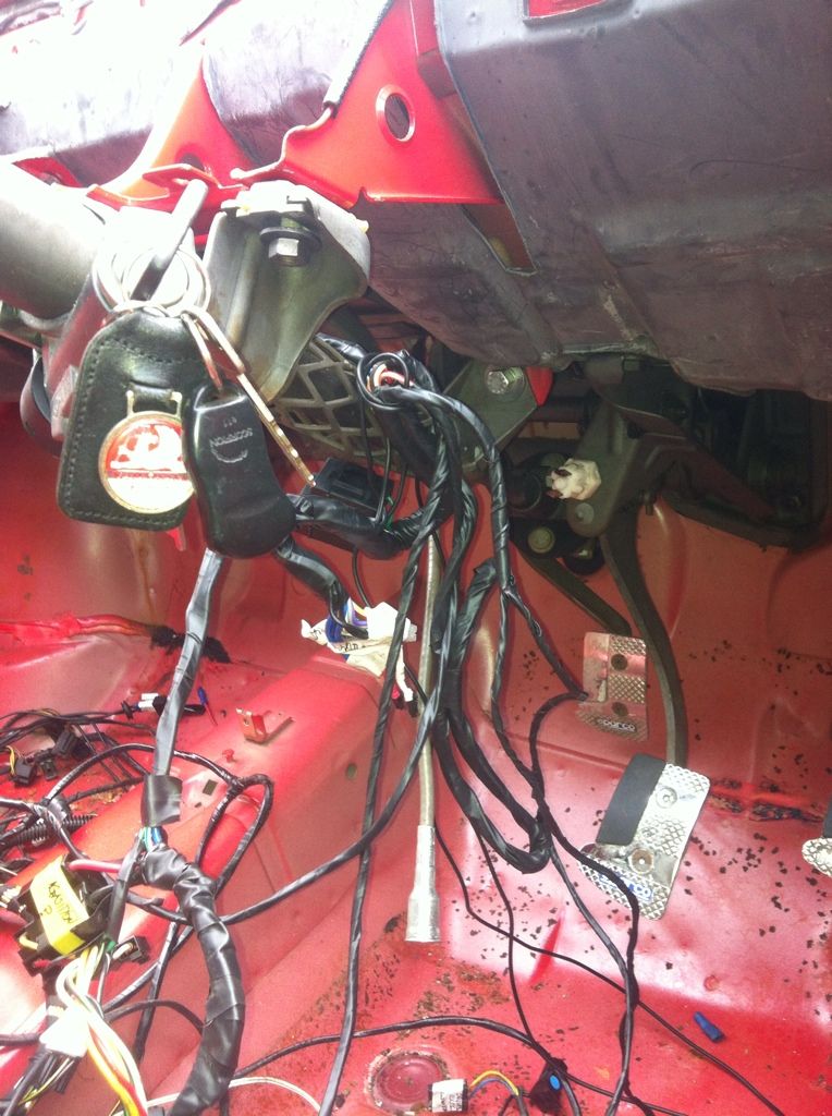

I won't be able to take the loom out in 1 piece as its wrapped around the rack, and yeah I bought the laser one the pins are just cheap steel so I've made a better one to do the job. Nick I've got a we blowtorch at my lockup so I'll attack te hinges with that next time I'm over. Cheers
Rack or column? Loom is only 1 bit at the fuse box end, so just unplug the rest and it will come out...
The way this is wired in I can't simply unplug it, I'd have to cut it which ain't happening.

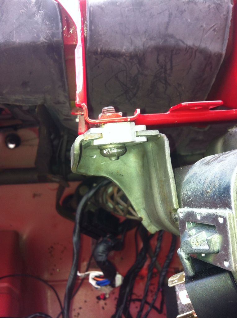

http://i660.photobucket.com/albums/u...ps87040854.jpg
Just remove the column then the loom should slip out through the middle, shear bolt a pain but get it easy with Yeh dash out
Just keep hitting it with a chisel until it comes free?
Never seen it over the top of the column like that, I'd unbolt it too, and even snapping the bolt with a spanner will free it off, the one in the pic doesn't look done up anyway...
