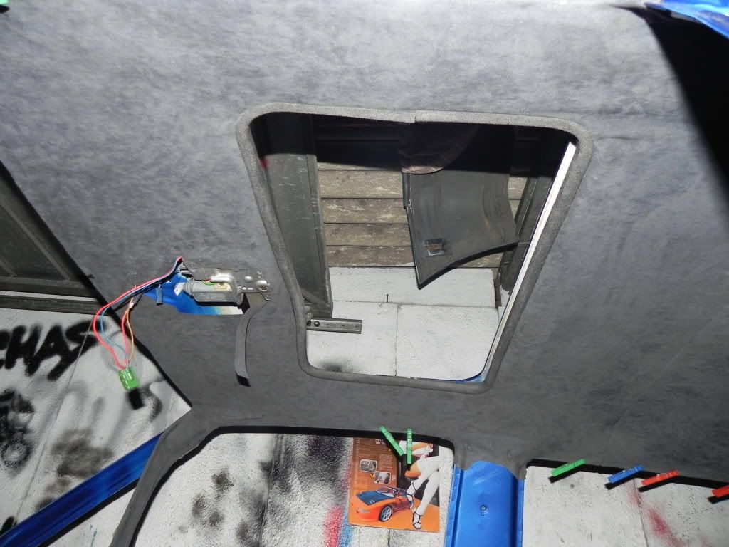

The one I made (which faded) only cost me like £20 in fabric (trade prices thanks to my Cuz). I made it using the original headlining as a template.
The new one will be Alcantara most probably and it'll be done whilse the seats ge re-trimmed.

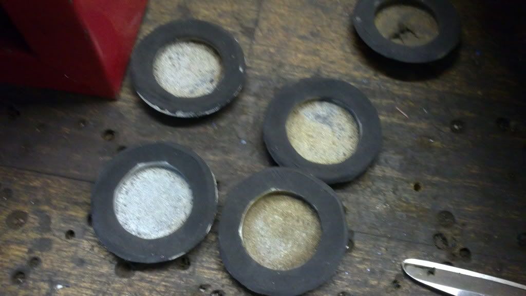

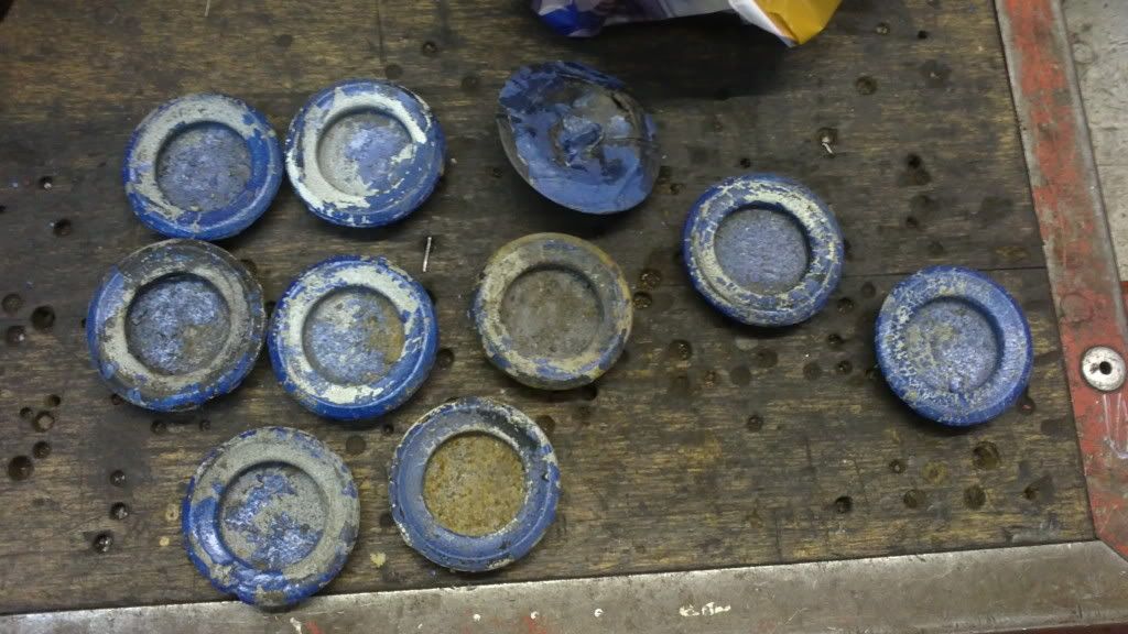

first of all was the floor grommets, after speaking to vauxhall they wanted a stupid price for each one of the grommets, so opted to tidy up my ones i had. these ones will be under the carpet so wont be seeing them. i have ordered 5 grommets as they will be on show where the rear seats used to be.

gave them a wire wheel which took up the paint/underseal/grime.

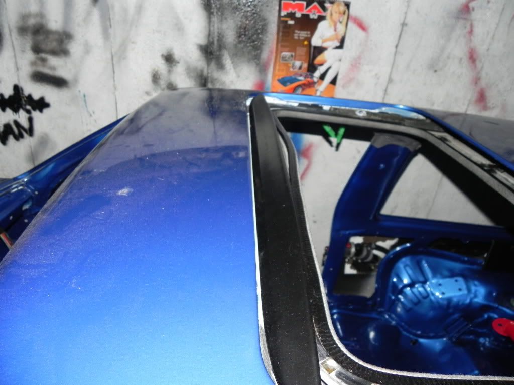

after numerous attempts to get a sunroof windbreaker for the car i had to give up. my old one has broke on the one mounting point, but as i couldnt get another i had to reclaim mine. it still fixes on the one side and doesnt wobble about. so kind of a result. gave it a spray of black to tidy it up.
http://i193.photobucket.com/albums/z...8/DSCN2342.jpg
when i bought my sunroof glass i managed to pinch the inner surround seal. it was a very light grey and wouldnt have matched the headling at all. gave it a couple of coats of black spray and it came out like so...

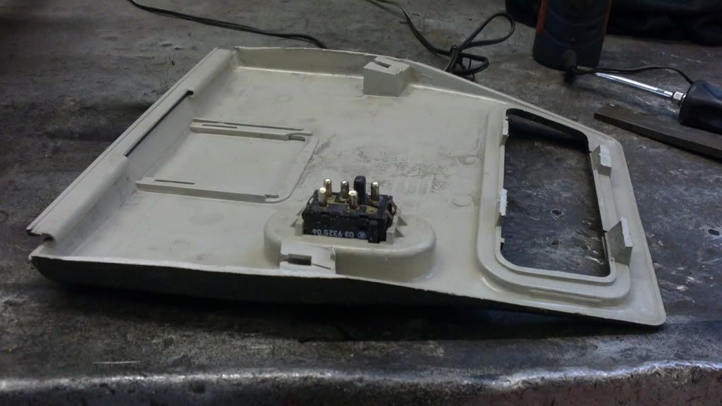

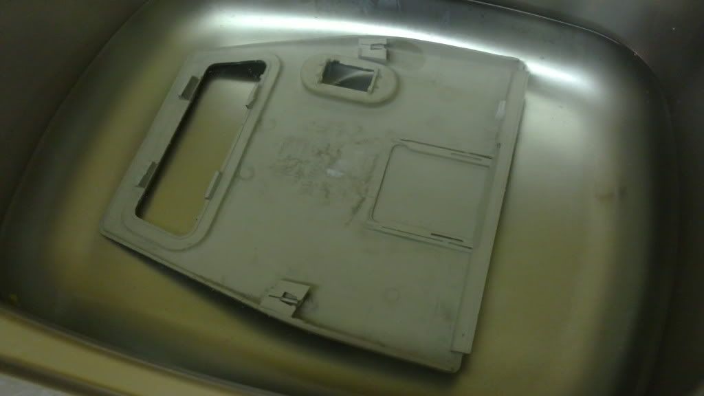

the electric sunroof switch/surround is getting modified from its previous state. it doesnt quite sit flush with the headlining at the front so i modified it like so...
ground off on both sides the tallest lip so it doesnt dig into the headlining so much.
http://i193.photobucket.com/albums/z...0032011105.jpg

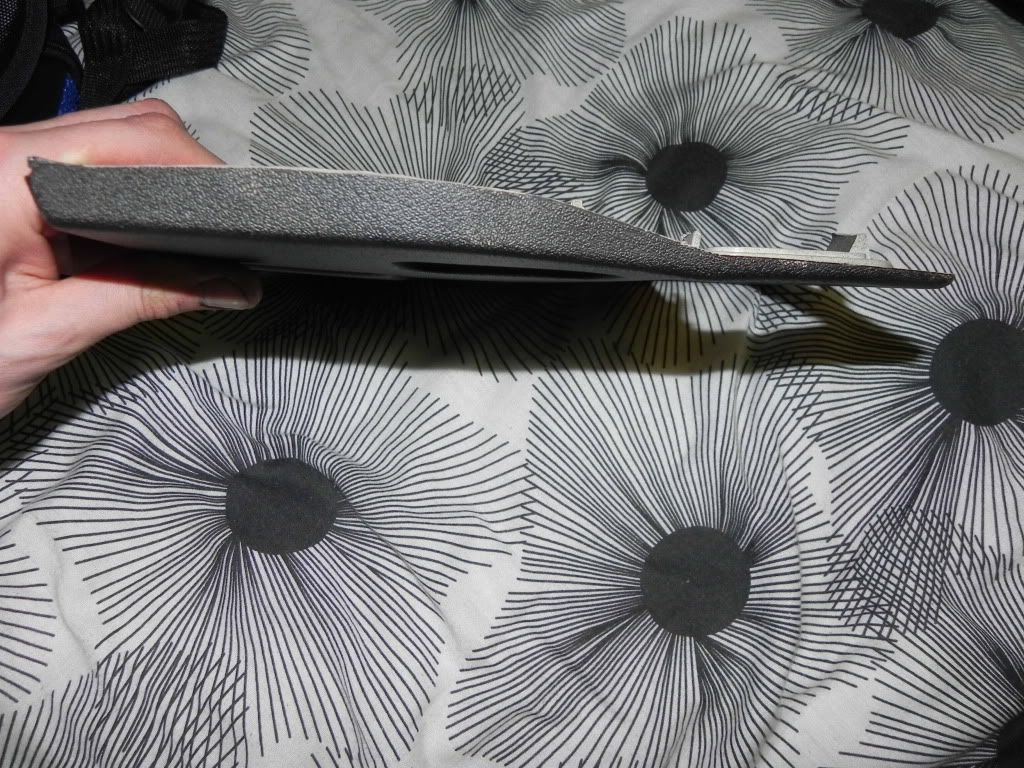

it then needed to be straightened. i tried putting it in the sink with boiling water to soften it and bend it flat.
http://i193.photobucket.com/albums/z...0032011106.jpg
didnt realy work that well, i then got out the hair dryer and evenly heated it up across the bend point, i molested it until it came out pretty much how id like.
http://i193.photobucket.com/albums/z...8/DSCN2344.jpg

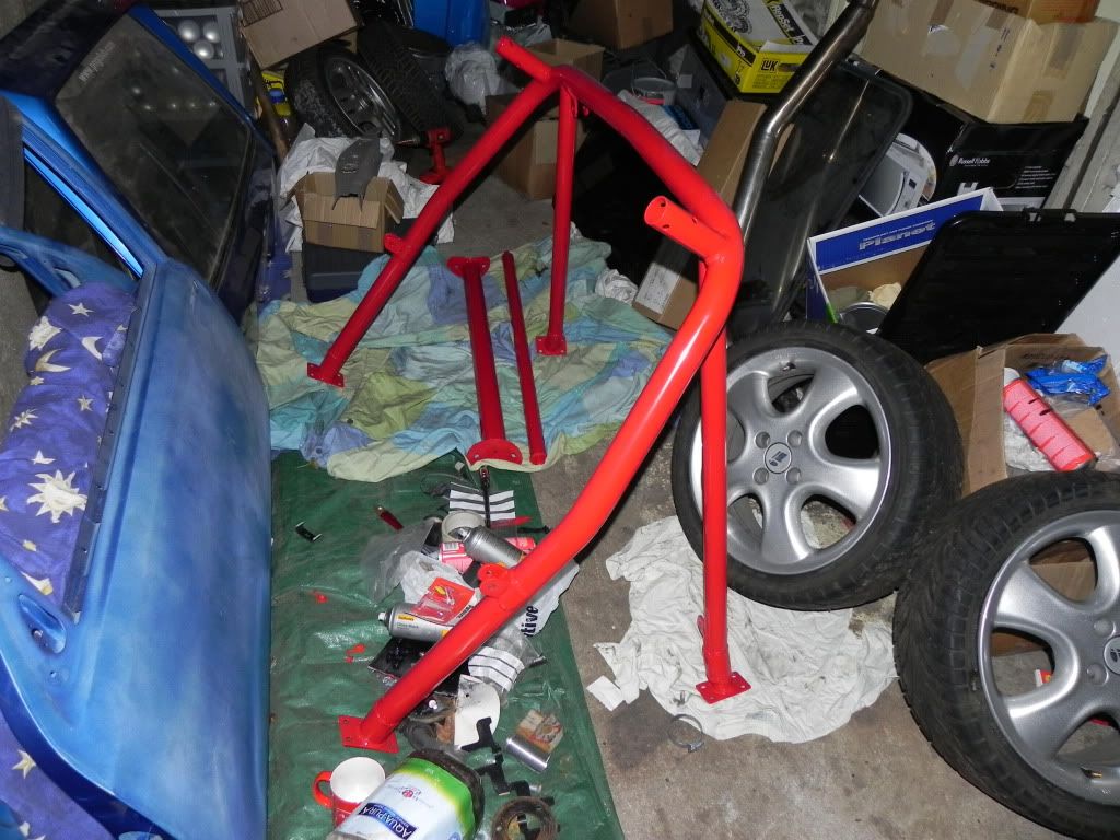

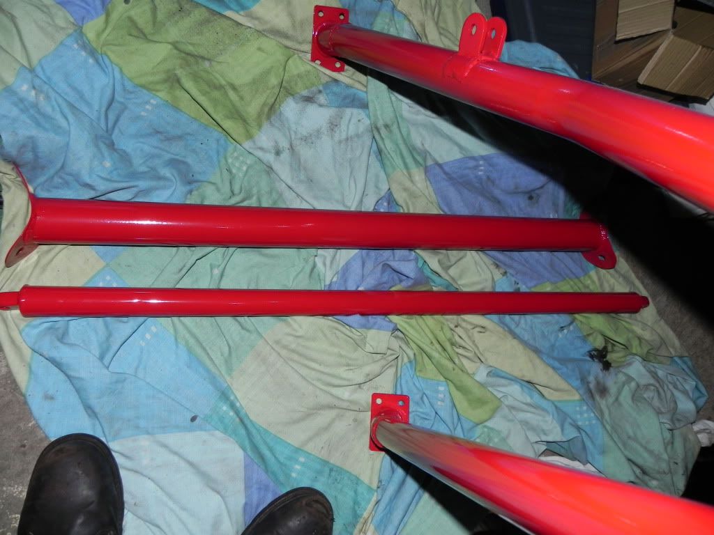

today i had a text from my powdercoater saying my cage and brace were all ready, got him to deliver them to me. im really chuffed how they came out, dont know what i expected them to come back like but i think they look great. the front section will get done when i need it.

trial fitted the brace back in, needs twisting around slightly to line the holes back up but other than that it can be bolted down for the final time.
