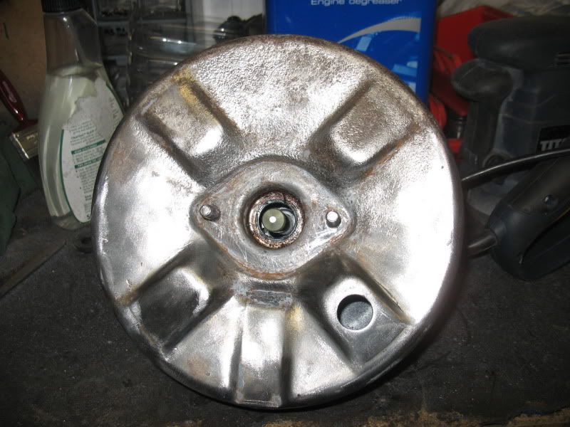

After clearing up in the garage and moving stuff about so i had some bench space to work on i started to strip the servo down to bare metal to re paint.
http://img.photobucket.com/albums/v3...n/IMG_9555.jpg
Under a few layers of paint. All bare and now been etch primed and high build primerd to get a nice smooth finish. But finish it in black or grey? hhhmmm

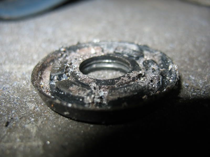

Ever had the mc to servo join leak? This will be why!
http://img.photobucket.com/albums/v3...n/IMG_9553.jpg
http://img.photobucket.com/albums/v3...n/IMG_9554.jpg
The std finish is like a power coat, add on that other layers of paint and you get a crap seal and leakage. So its all cleaned up now.

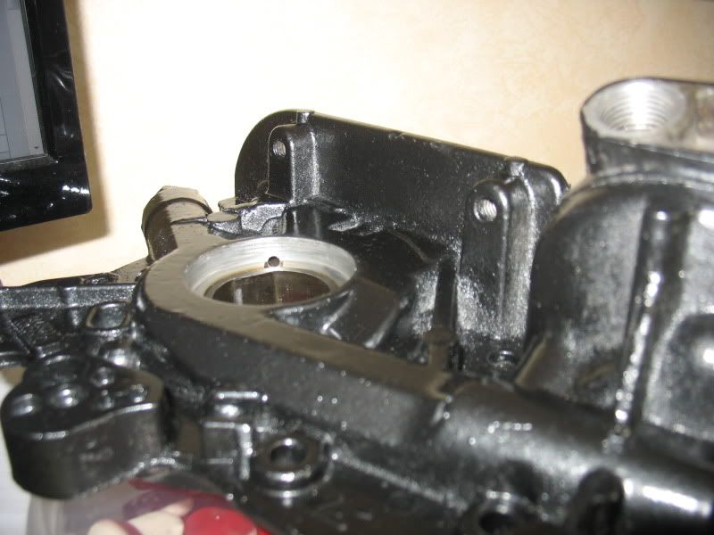

Also while i was on a roll. I paint my Zlet pump up in bumper grey too (crap pic)
http://img.photobucket.com/albums/v3...n/IMG_9556.jpg
Picked the sump up Friday after work, so i can fit the zlet pump and bits and the sump tomoz so then the bottom ends all done, just need to finish the head.
