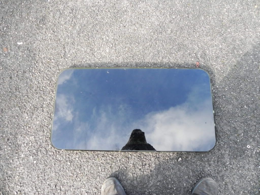

drove down to cinderford yesterday to pick up this sunroof....
http://i193.photobucket.com/albums/z...8/DSCN2297.jpg
bought off a nice chap called lee that was breaking a vectra. sorts out the sunroof for the nova. happy days.

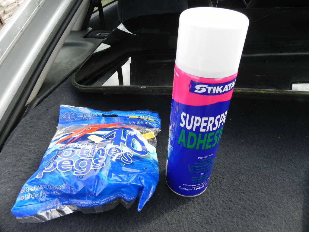

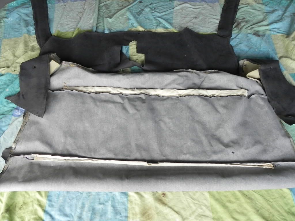

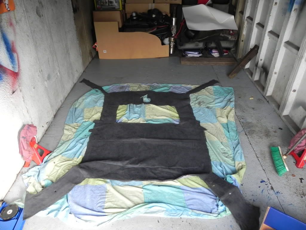

so i dug out the headlining (mmmmmm alcantara), the pegs and adhesive i had.
http://i193.photobucket.com/albums/z...8/DSCN2301.jpg
http://i193.photobucket.com/albums/z...8/DSCN2300.jpg

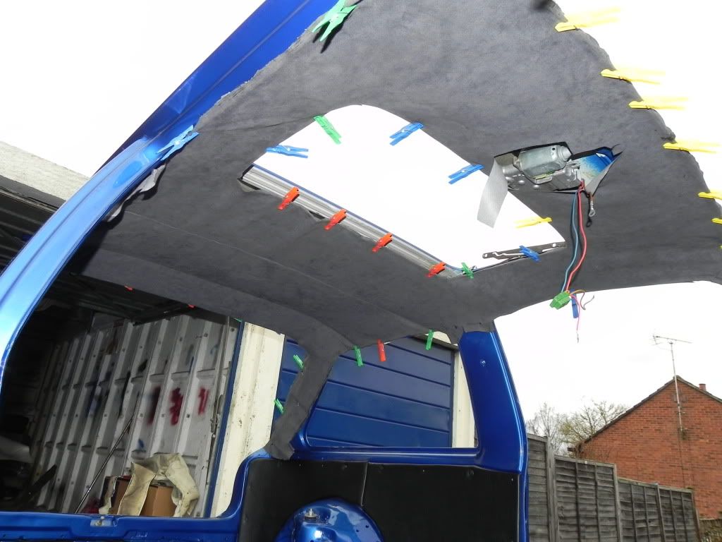

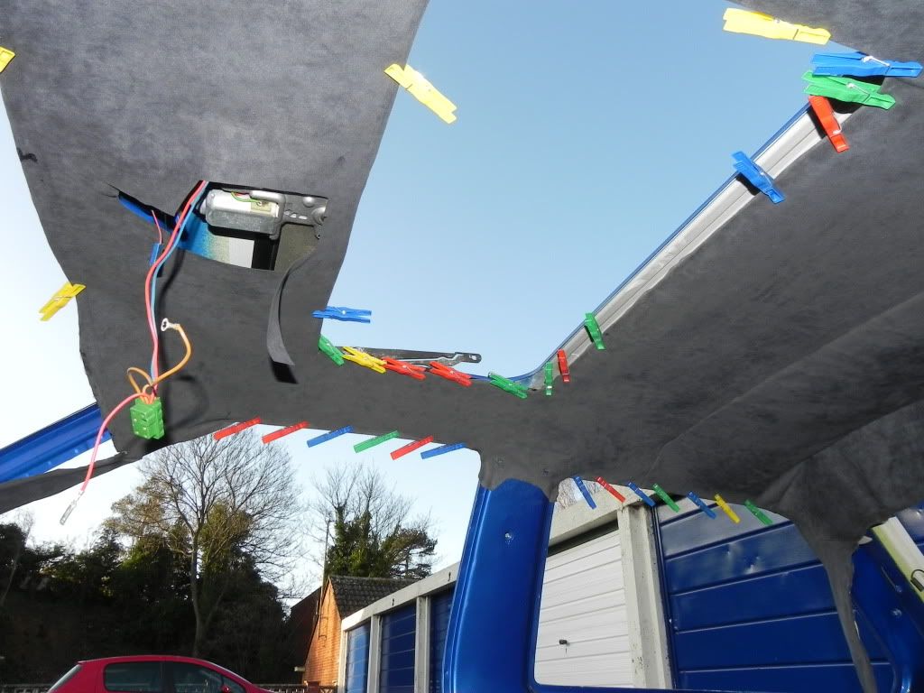

fitted the rods and got them up in place.
http://i193.photobucket.com/albums/z...8/DSCN2302.jpg
http://i193.photobucket.com/albums/z...8/DSCN2303.jpg

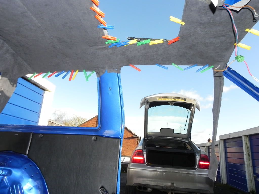

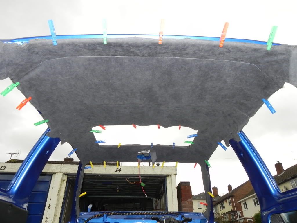

temporarily pegged it all up. i was scepticle if it was going to fit correctly.
http://i193.photobucket.com/albums/z...8/DSCN2304.jpg
http://i193.photobucket.com/albums/z...8/DSCN2308.jpg

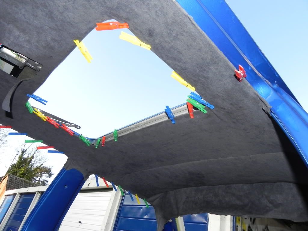

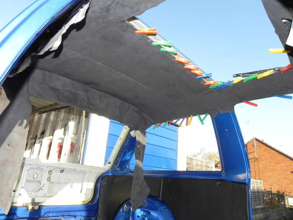

i thought 40 pegs would be enough, but i was wrong. had to do small sections at a time to get it to fit nicely.

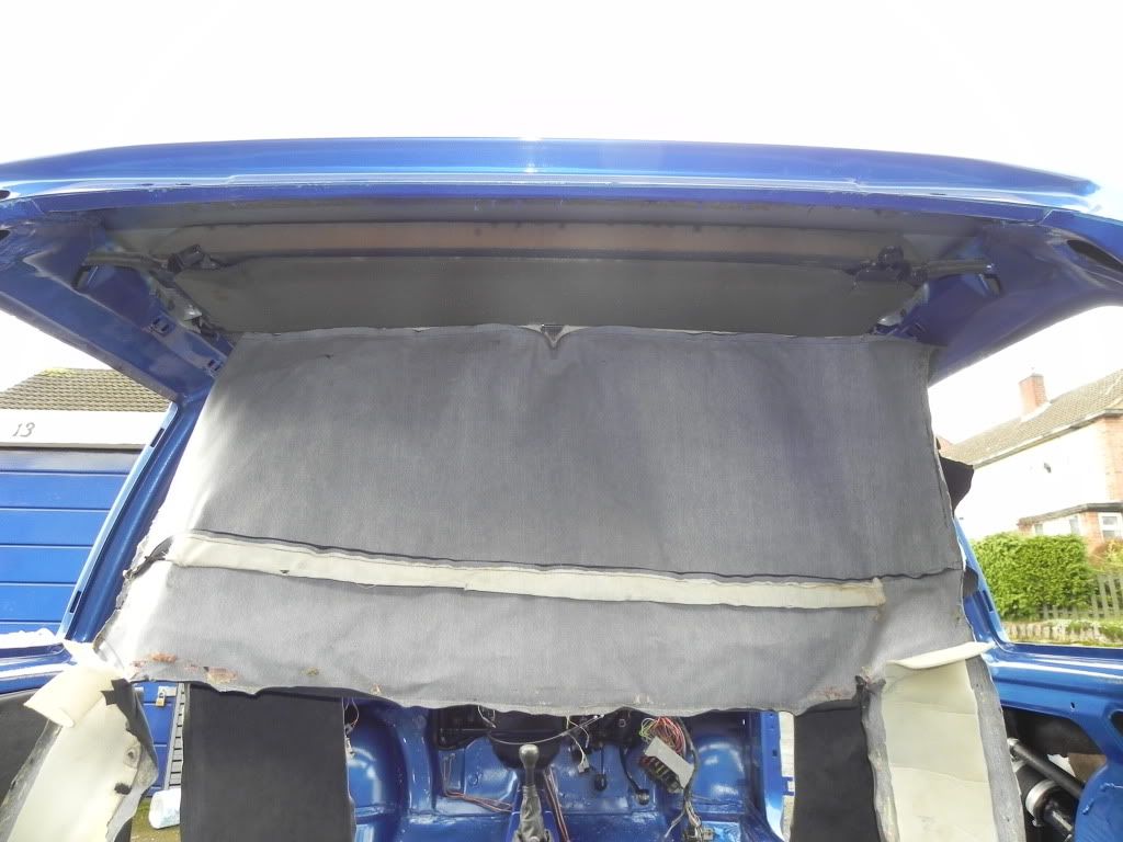

i still have the front windscreen section to do and the rear tailgate bit to do.

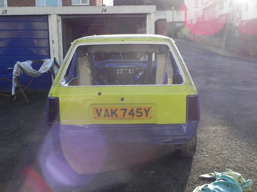

i had to get my tailgate fitted as it needed adjusting on the hinges, as you know there under the headlining, hence i had to get it fitted before i finish the h.lining.
http://i193.photobucket.com/albums/z...8/DSCN2322.jpg
its still bent on the one corner, damn couriers.
http://i193.photobucket.com/albums/z...8/DSCN2324.jpg

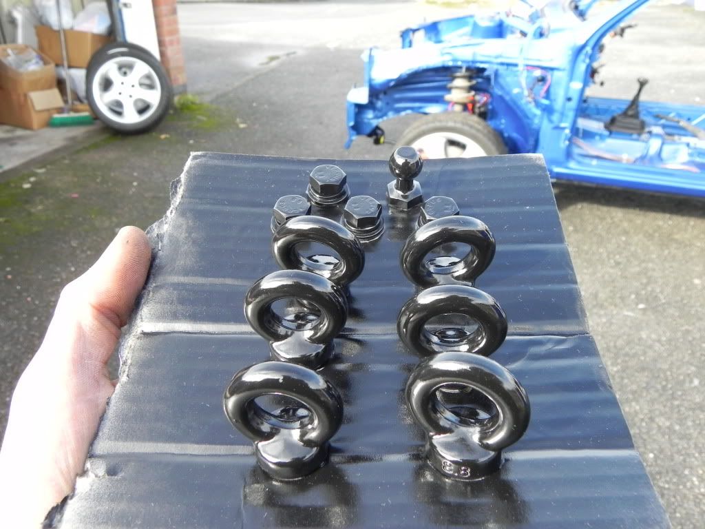

painted my eye bolts for my harnesses and fitted them

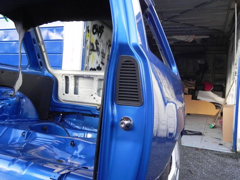

had also painted the door shut vent in the same colour as the fuel cap.
http://i193.photobucket.com/albums/z...8/DSCN2327.jpg

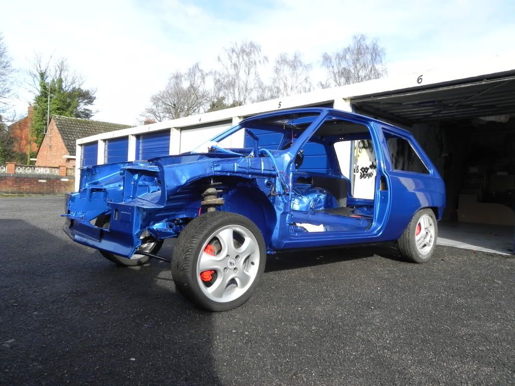

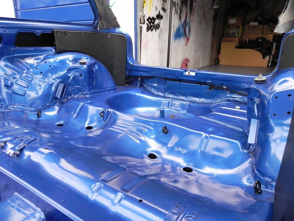

as it stood this morning.
http://i193.photobucket.com/albums/z...8/DSCN2289.jpg

Good work again dude! Rather you than me on that headlining tho! lol
it does look daunting, but it really isnt. aslong as your patient and stretch it to take out the creases then its an easy job. :)
