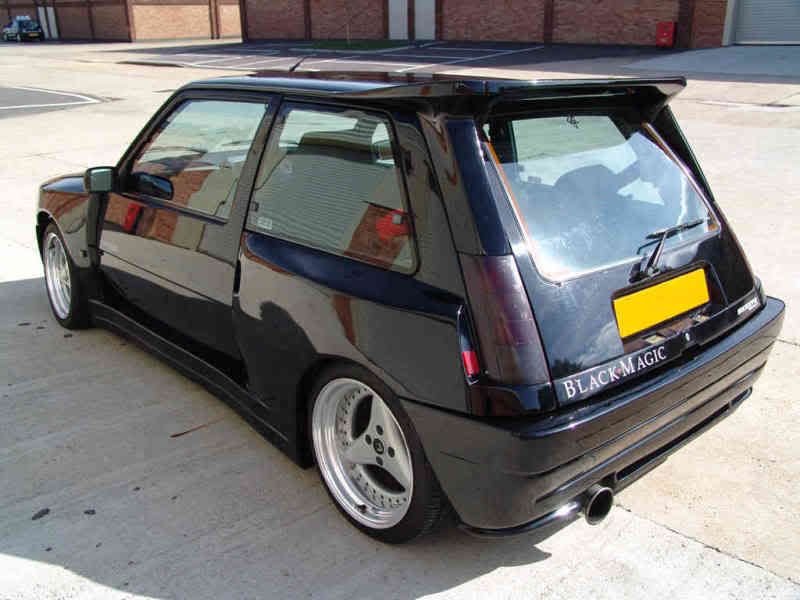

heres a Dimma 5 in better shape, Image wheels again! 3 spokes.

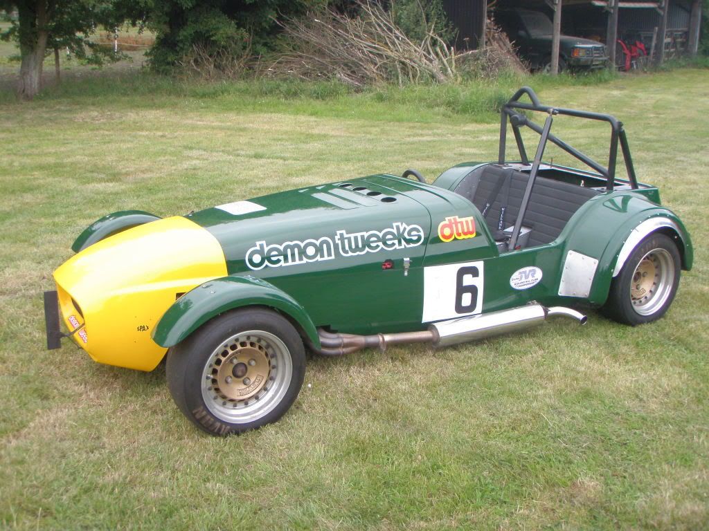

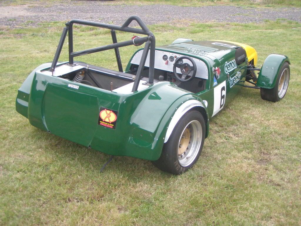

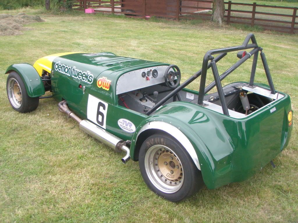

I've bought this Westfield, complete with a very nice trailer and a lot of spares, for a fraction of what the Nova has cost me to date.
Regular readers will know I've had Westfields before, and there's no doubt they are amazing value for money, but best of all great fun, which is after all the whole reason for playing with cars.
Aaah, a kitcar! I love it!
competitive or just for fun ? or will you use this and keep the nova to one side for another time ?
You want a smaller steering wheel on that :(
Looks amazing mate,i say either break the nova/sell it on, or put it to one side, as I'm sure this will be far more competitive then the nova?
You have too much money to! lol
Be a real shame to see that nova broken for spares :(
Put it to one side if your fed up with it IMO
