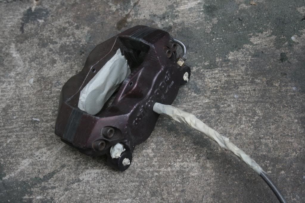

And on that note some more progress, i only had an hour or so tonight so got what i could done

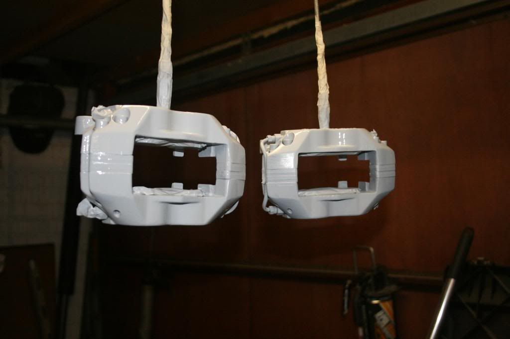

I started by giving the callipers a quick mask up
http://i248.photobucket.com/albums/g...dcooler027.jpg
Followed by a couple of coats of acid etch
http://i248.photobucket.com/albums/g...dcooler028.jpg

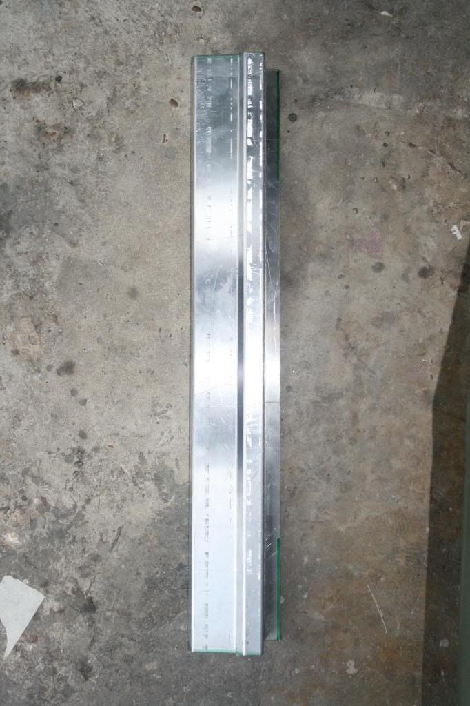

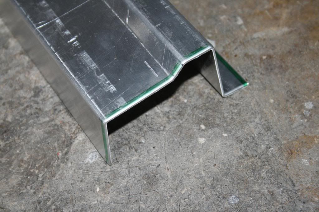

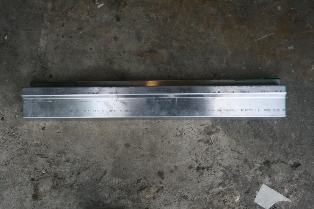

While these were drying i turned my attention to something i had knocked up whilst enduring an extreme stretch of boredom at work
And here it is
http://i248.photobucket.com/albums/g...dcooler030.jpg
http://i248.photobucket.com/albums/g...dcooler031.jpg
http://i248.photobucket.com/albums/g...dcooler032.jpg
And it now lives here
http://i248.photobucket.com/albums/g...dcooler033.jpg
http://i248.photobucket.com/albums/g...dcooler034.jpg

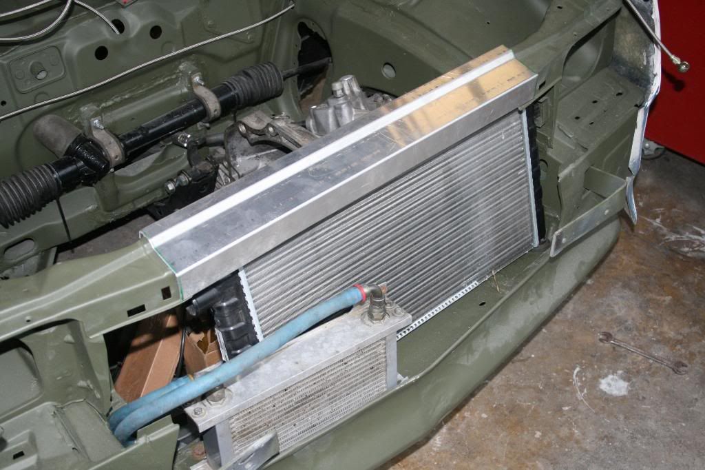

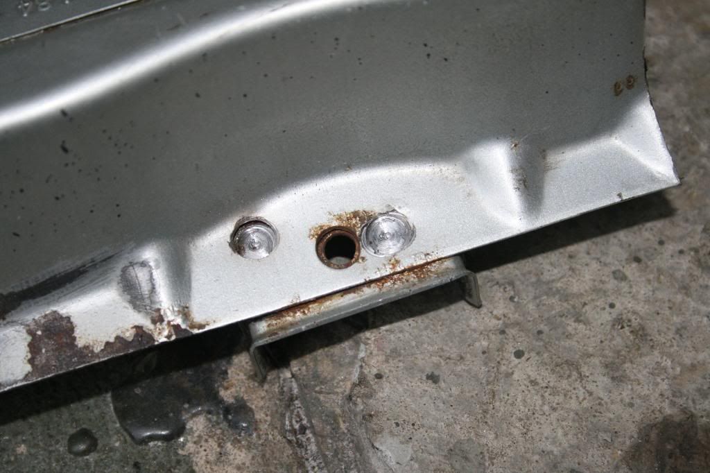

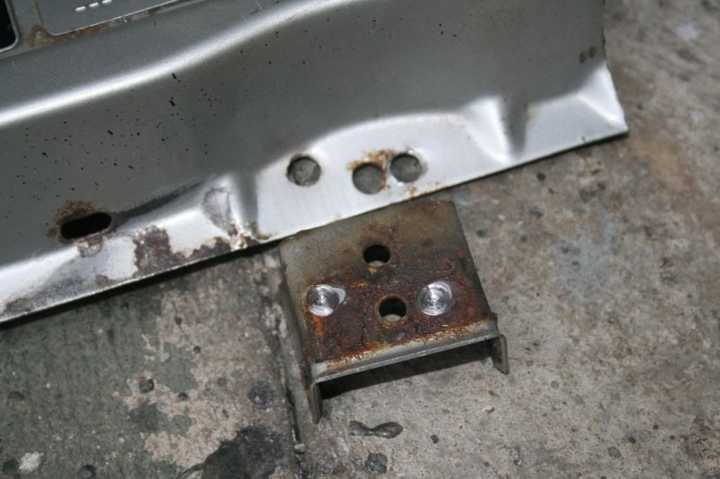

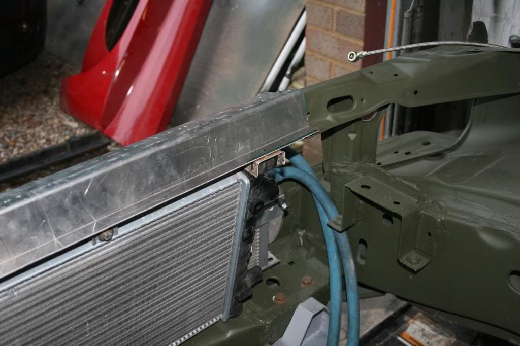

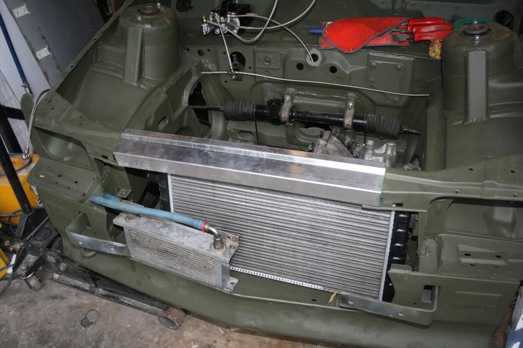

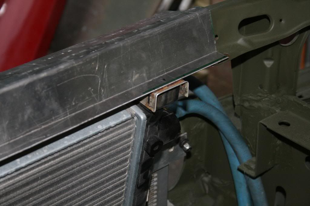

It will be bolted in and to ensure the rad is kept were its supposed to be i drilled the spot welds out of the old rad mount on the original slam panel
http://i248.photobucket.com/albums/g...dcooler035.jpg
http://i248.photobucket.com/albums/g...dcooler036.jpg

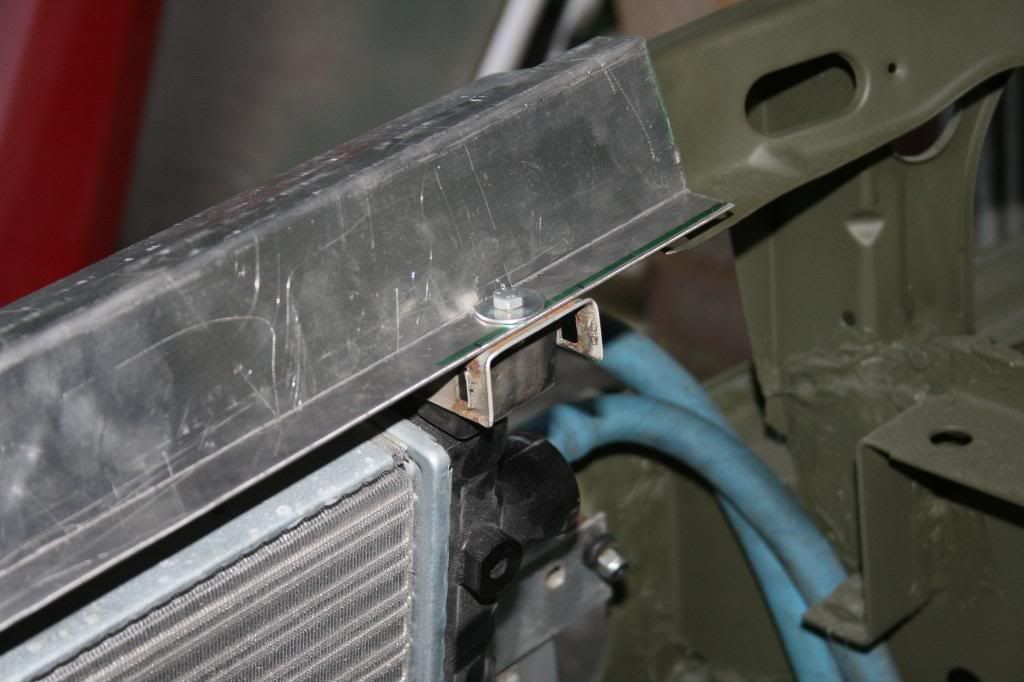

And bolted it to the new Ali one
http://i248.photobucket.com/albums/g...dcooler038.jpg
http://i248.photobucket.com/albums/g...dcooler037.jpg
http://i248.photobucket.com/albums/g...dcooler039.jpg
Thus ending tonight's activities :D
Love the re placement slam pannel. Would look awesome polished.. ;)
lol Benn it would look good polished but it hasn't got a lot of chance of that, it might get painted if its lucky!
lol i know, if i was closer i'd do it.
Thanks buddy, if i do another show car (if) i will make sure i polish the slam panel lol

Good idea with the rad mount.
