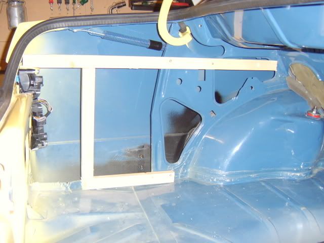

Finished up the boot this weekend.
Started by making a timber frame for the side panels.

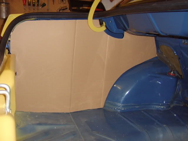

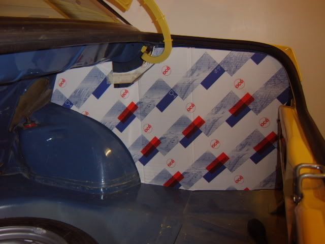

Then made up some cardboard templates
http://i73.photobucket.com/albums/i2...STA60002-2.jpg
http://i73.photobucket.com/albums/i2...STA60003-1.jpg
http://i73.photobucket.com/albums/i2...STA60004-1.jpg

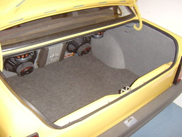

Transferred the outines onto 18mm MDF along the back of the seats and 4mm Hardboard for the sides.
http://i73.photobucket.com/albums/i2...l/STA60005.jpg

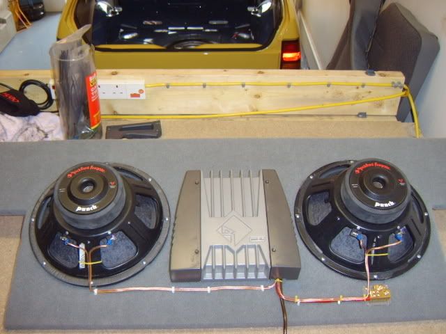

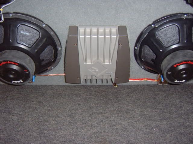

Carpeted it up and fitted the subs and amp.
http://i73.photobucket.com/albums/i2...l/STA60006.jpg

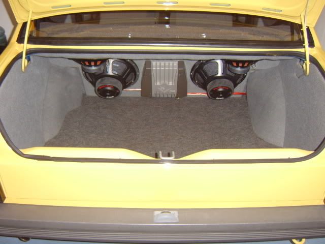

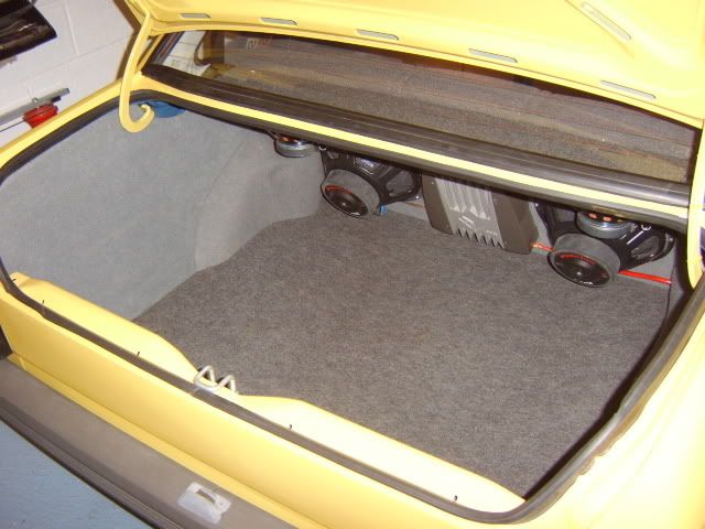

Carpeted the arches then fitted it all in.
http://i73.photobucket.com/albums/i2...STA60007-1.jpg
http://i73.photobucket.com/albums/i2...STA60008-4.jpg
http://i73.photobucket.com/albums/i2...STA60009-6.jpg
http://i73.photobucket.com/albums/i2...STA60010-8.jpg
The side panels are held in place with velcro to so visible fixings are seen. You can still see a little blue behind the hinges, so next time I have nothing to do, going to take the sides back out and carpet behind there.
