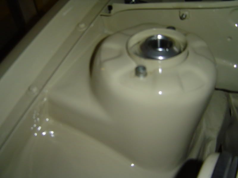

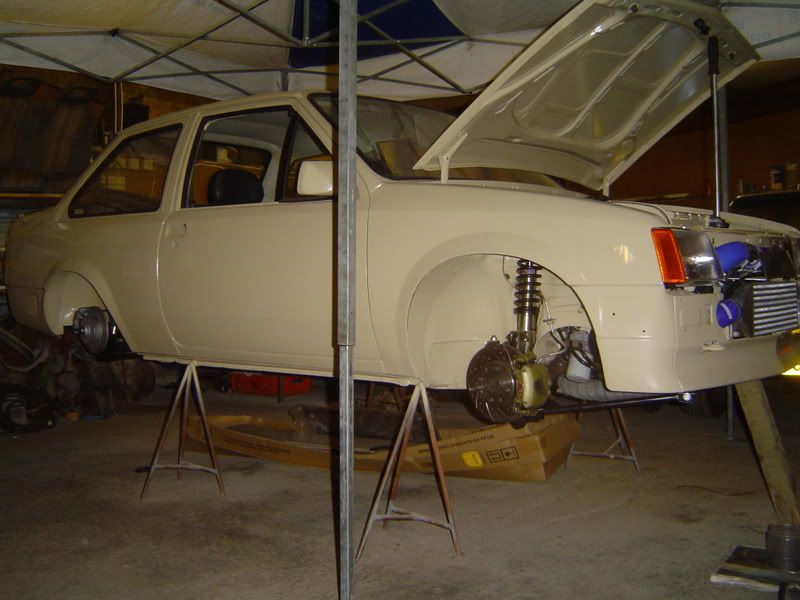

Eccentric top mounts

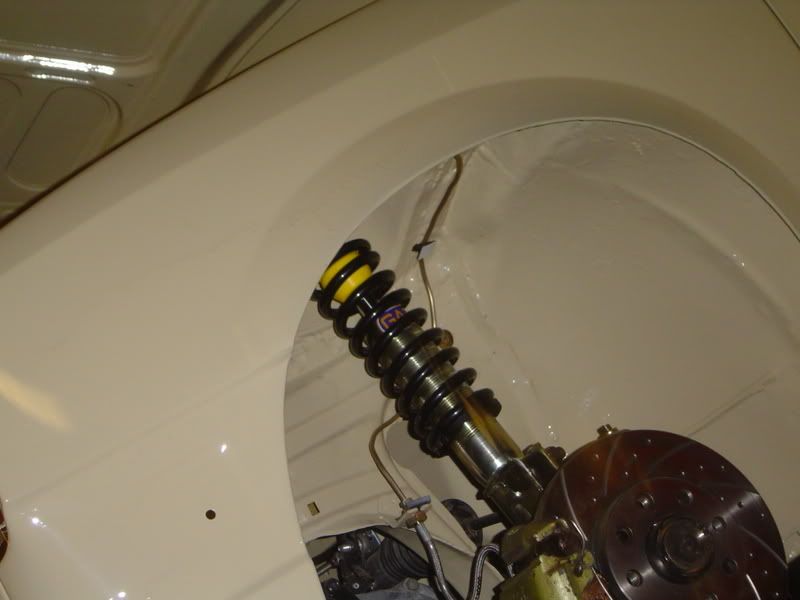

http://img.photobucket.com/albums/v1...8.jpg~original
custom gaz front coilys
pipe
http://img.photobucket.com/albums/v1...5.jpg~original

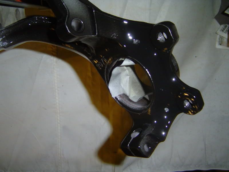

knucles and hubs re-furbed and coated with zinc primer and hammerite from the gun.. these had reversed tapers for the stearing joints...but I changed these back to std later...

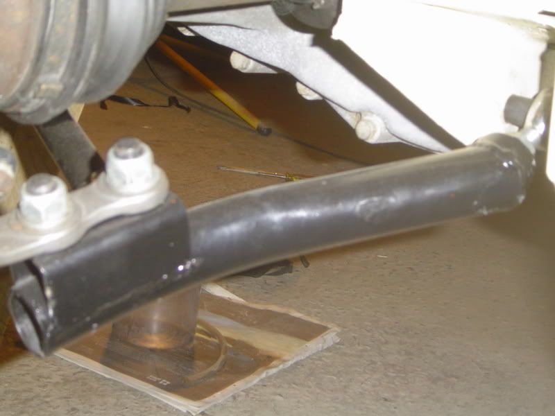

Rose jointed bottom arms - I'll have to get some more pics of these...
http://img.photobucket.com/albums/v1...2.jpg~original

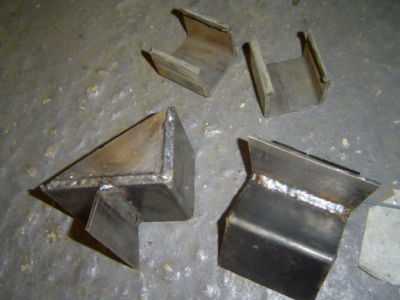

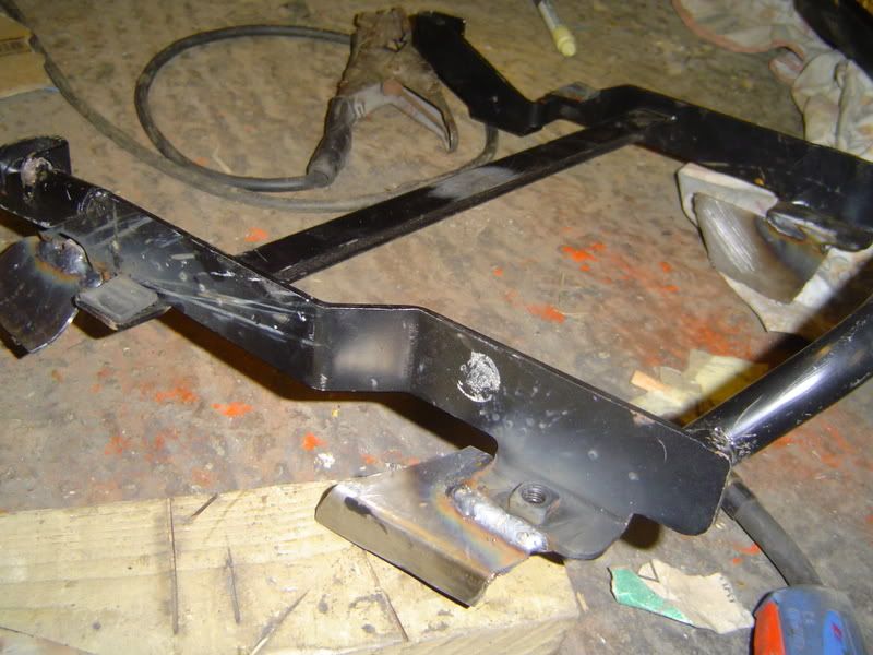

..And the start of the tie bar mounts

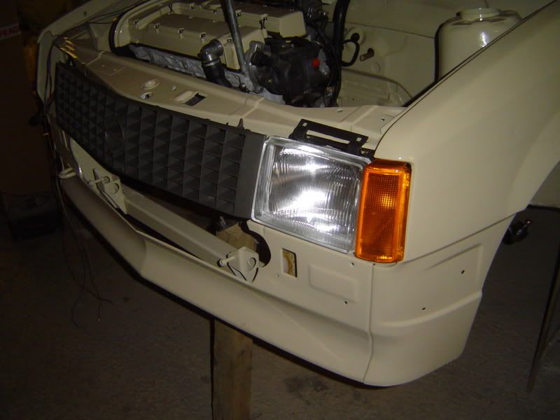

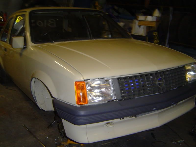

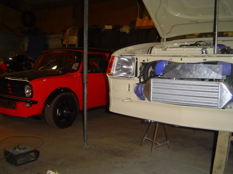

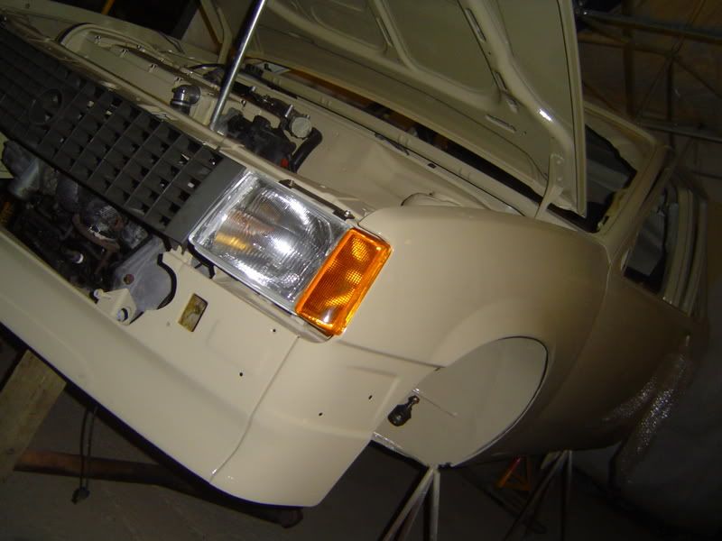

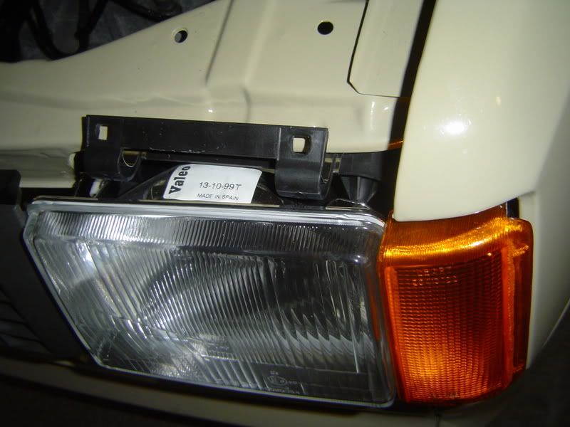

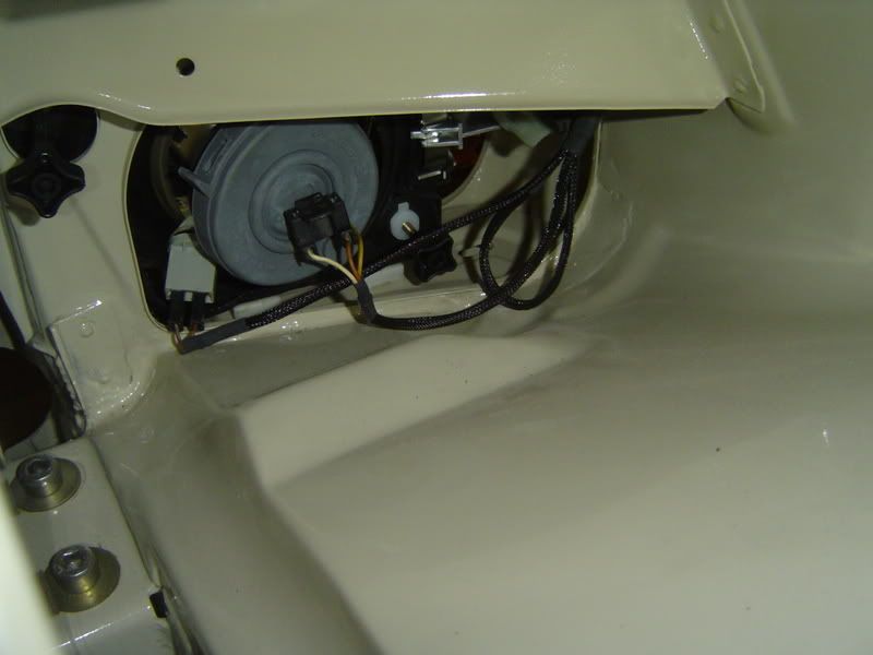

New valeo headlamps
http://img.photobucket.com/albums/v1...7.jpg~original
http://img.photobucket.com/albums/v1...3.jpg~original

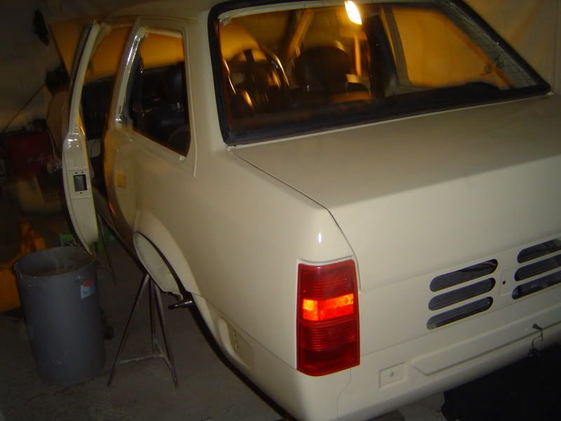

Red clusters
http://img.photobucket.com/albums/v1...6.jpg~original

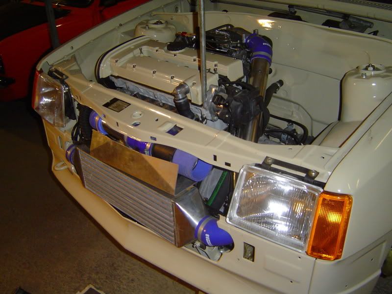

All the fronts bolted up
http://img.photobucket.com/albums/v1...9.jpg~original

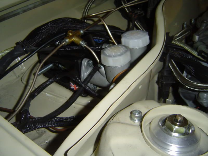

Bit of plumbing

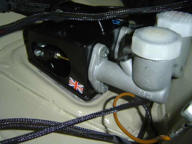

Sorted a compbrake bias box, and plumbed in with copper/ncikel pips and braided lines.

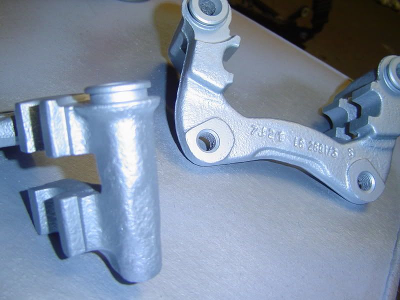

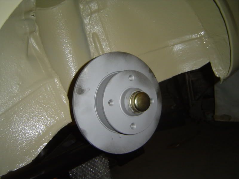

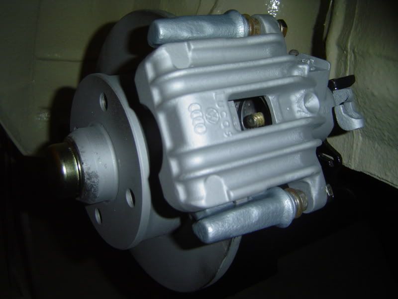

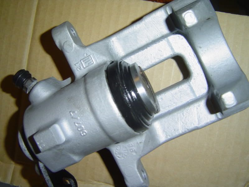

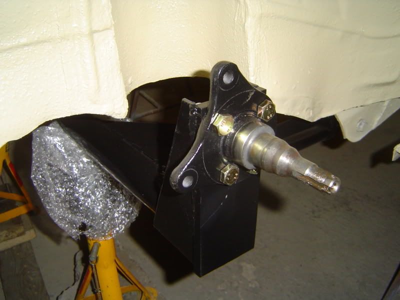

sorted out the rear calipers/stubs/brackets and discs out. All de-rusted in teh baking soda then painted. calipers are Audi items off an s4, but all the same...all sorted with new seals throughout.

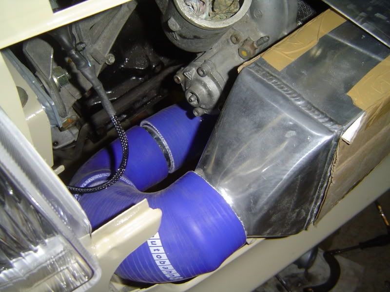

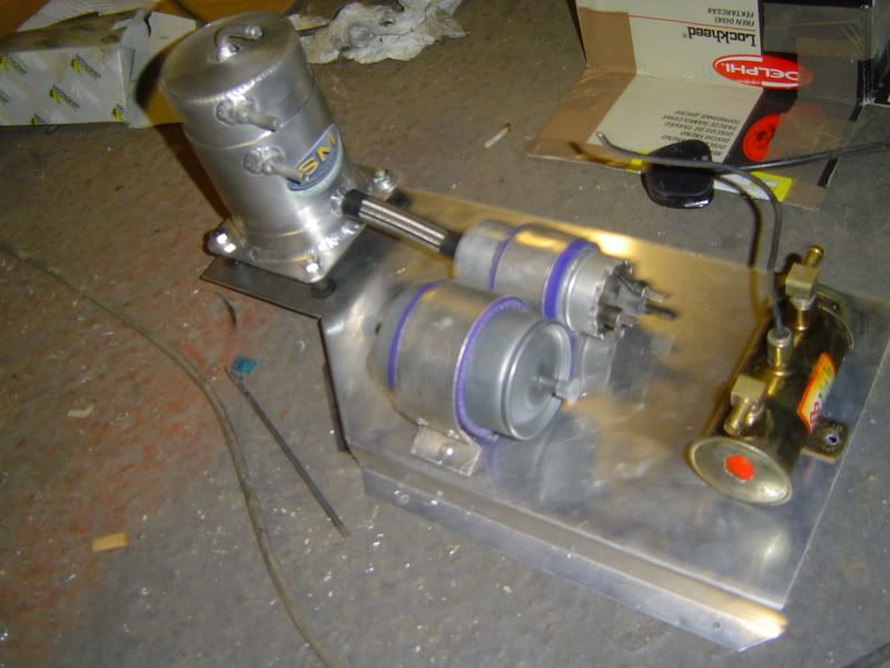

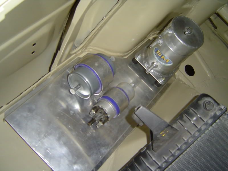

Next up, A mount for all the fuel gubbins. As its a carb tank, I gota n external swirl pot with facet pump and filter.
tucked in next to the rad

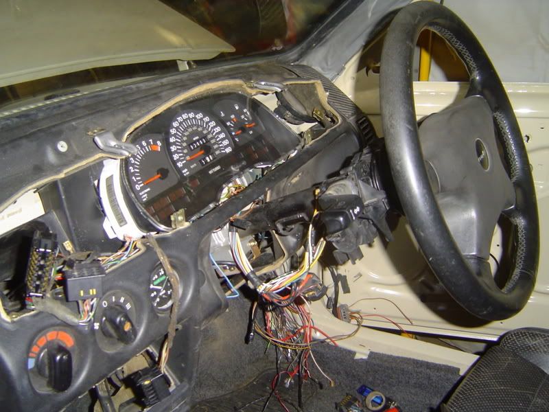

Next, back on to the interior..

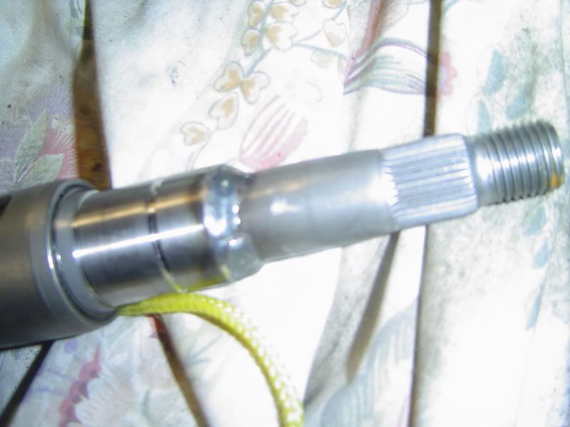

mod to the column to fit the turbo steering wheel

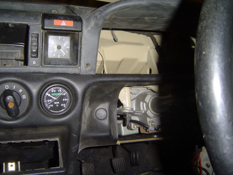

classic boost guage mounting
...and turbo clocks
Gte seat mounts moded to bolt the cally seats in...non adjustable as I needed the seats low!

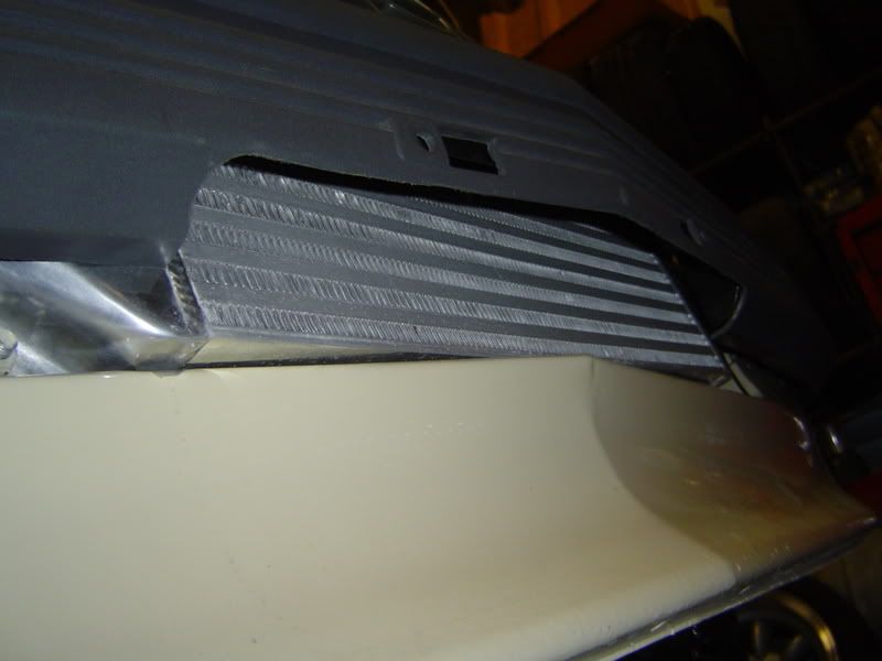

mods to bumper mount
and bumper
All fitted up..
