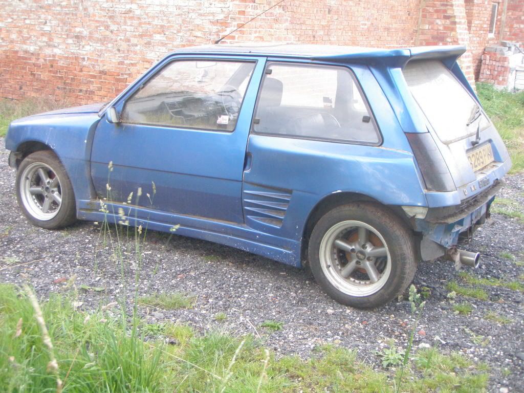

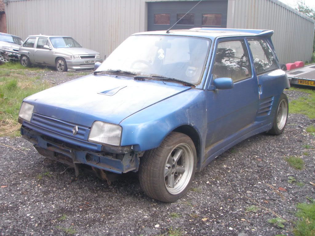

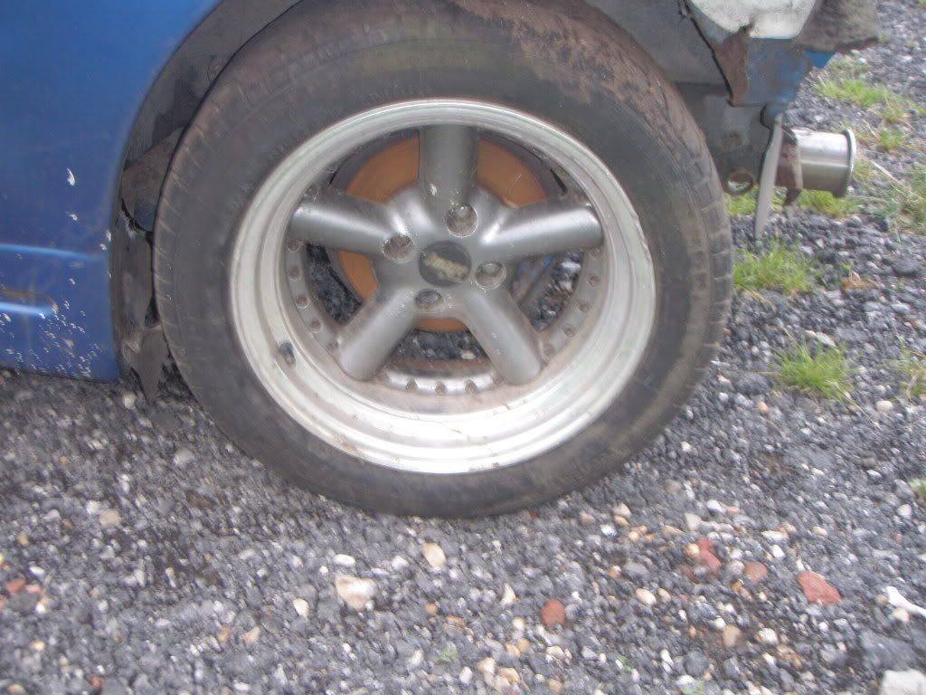

For a long while I've been on the hunt for some 15" split rim wheels to use on the front of the Nova, but had no success, so today I bought a complete car, with wheels thrown in!;
http://i285.photobucket.com/albums/l...ort/001-14.jpg
http://i285.photobucket.com/albums/l...ort/003-49.jpg
http://i285.photobucket.com/albums/l...ort/002-46.jpg
In actual fact it was 2 cars, as I had to buy another 5 GT Turbo which came with it..........
How much more late 80's retro can you get than a Dimma 5?
Awesome!! I always wanted the Dimma kit for mine when I had one!!
If didnt have this bag of **** Corsa Id snatch your hand off for that 5!
Looks like it hasn't moved since the 80's!
How light are the alloys though Colin? Always loved those kits back in the day.
:eek: what happend with the bumpers?
It's that fast, they fell off lol
