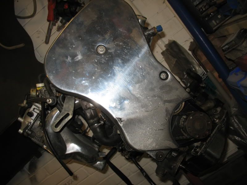

Started taking the inlet off and i noticed this...
http://img.photobucket.com/albums/v3...n/IMG_9453.jpg
http://img.photobucket.com/albums/v3...n/IMG_9451.jpg

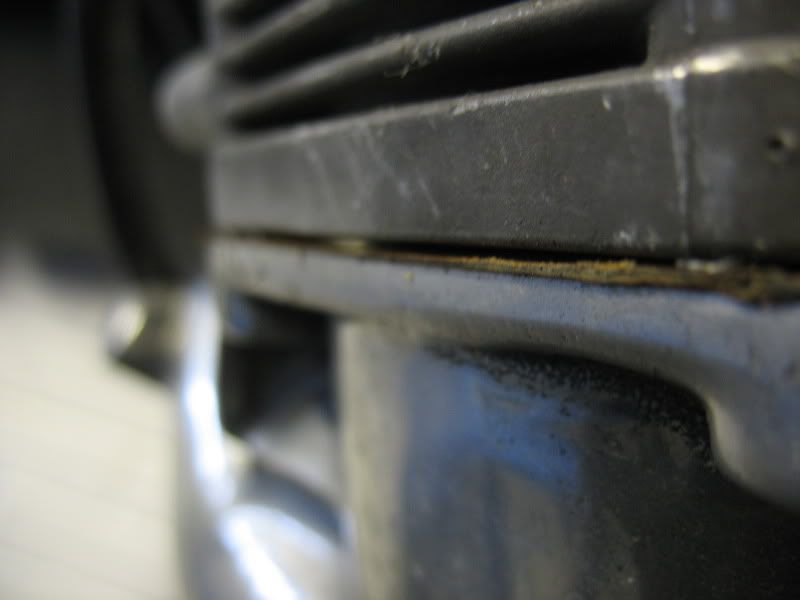

Hhmm the stud has unwound it's self out of the inlet.. Both sides! So i could lift it up at the back...
http://img.photobucket.com/albums/v3...n/IMG_9452.jpg
Light is to show the gap..( that's with out me lifting it!)
