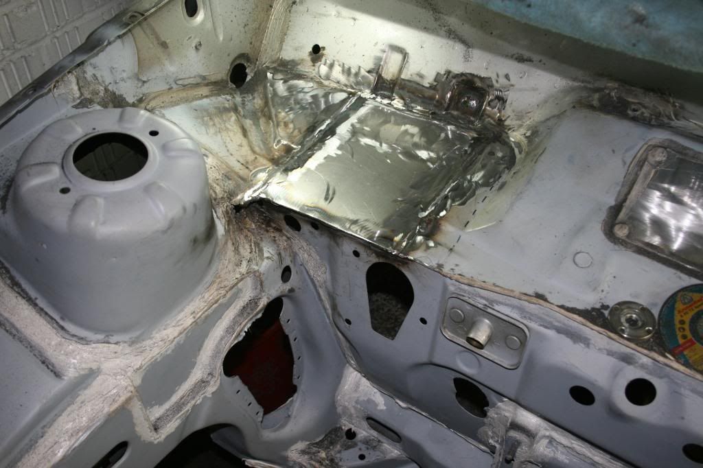

I've got the corsa servo yeah but the base plate got welded to the car.
If you do it like i did you dont need the base plate - i think this would still be possible with the fire wall in place.
http://i248.photobucket.com/albums/g...dcooler006.jpg
http://i248.photobucket.com/albums/g.../engbay155.jpg
http://i248.photobucket.com/albums/g.../engbay163.jpg

Not as hard as you think mate - here are some pics to give you food for thought.Quote:
Take this lot
http://i248.photobucket.com/albums/g.../engbay154.jpg
Cut it up and splice it with the corsa b pedal ass
http://i248.photobucket.com/albums/g.../engbay192.jpg
Modify the corsa ass further
http://i248.photobucket.com/albums/g.../engbay194.jpg
http://i248.photobucket.com/albums/g.../engbay195.jpg
http://i248.photobucket.com/albums/g.../engbay197.jpg
http://i248.photobucket.com/albums/g.../engbay198.jpg
So it fits together like so
http://i248.photobucket.com/albums/g.../engbay202.jpg
http://i248.photobucket.com/albums/g.../engbay206.jpg
Then mod the pedal to suite
I've got the pedal assembly but the pedal itself hasn't been adjusted/straighted but to be honest, if doing it again I would doing it differently, more like James', as mine can be a biatch to get out.
That method is stronger and keeps the original supports so no flex
