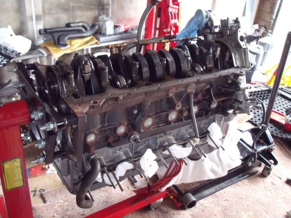

Engine looking bare:
http://iainel.co.uk/images/forums/NovaWIP2a/961.JPG
