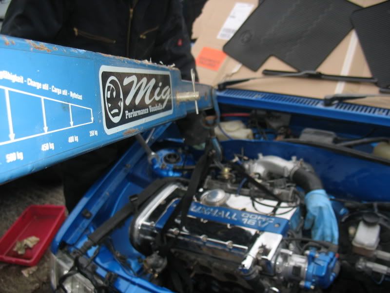

Linked the legendary hoist out.. Now years back when i bough my first xe, the guy left a really nice 3braided wiring lifting rid on it, every engine has been removed using it as its like unbreakable. Till today as it was left at Dan's. So this time we had to rid up some lifting straps instead...
http://img.photobucket.com/albums/v3...neremoval2.jpg
Coming out..
http://img.photobucket.com/albums/v3...neremoval3.jpg
Me pointing the best way (:p) to remove a engine.... lol (no damage to bay)(yes this time there is no box on it)
http://img.photobucket.com/albums/v3...neremoval4.jpg

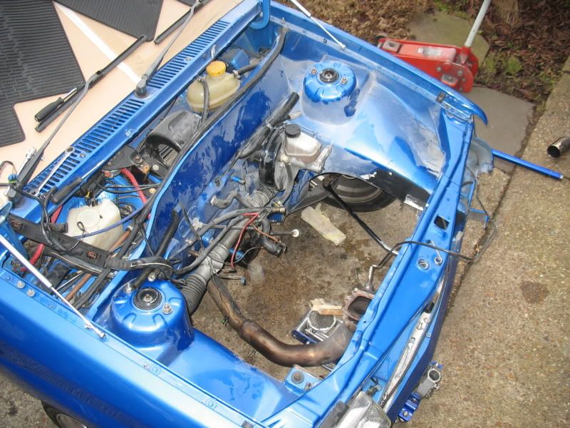

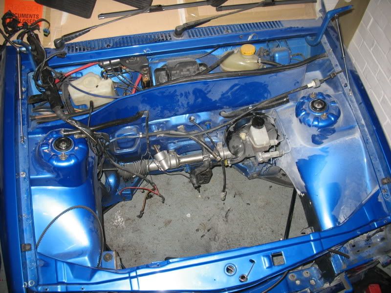

Leaving me with a filthy :( engine bay..

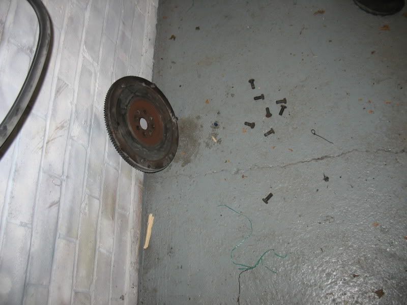

Off with Mr lighten flywheel.. Flywheel locking tools are the best thing ever! Came off easy as.
