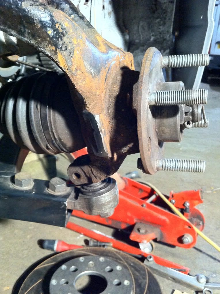

One of the main issues was a massive problem with the front brakes heating up so much that the brake pads enlarged to the point where they were rubbing on the hub and the wheel bolts kept coming loose as they got so hot. The problem also cooked the hub bearings and foobarred them so it was time for a re-think. After a lot of headscratching and general indecision we finally came up with this:
http://i205.photobucket.com/albums/bb125/cpnova/149.jpg
First I stripped the brakes out and cut off the tab that you can screw the stad protective tine brake guard on to.

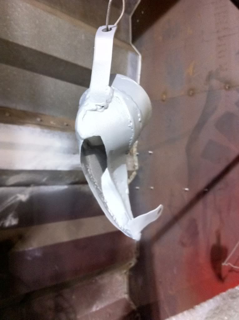

Next i made up this weird looking contraption:
http://i205.photobucket.com/albums/bb125/cpnova/150.jpg

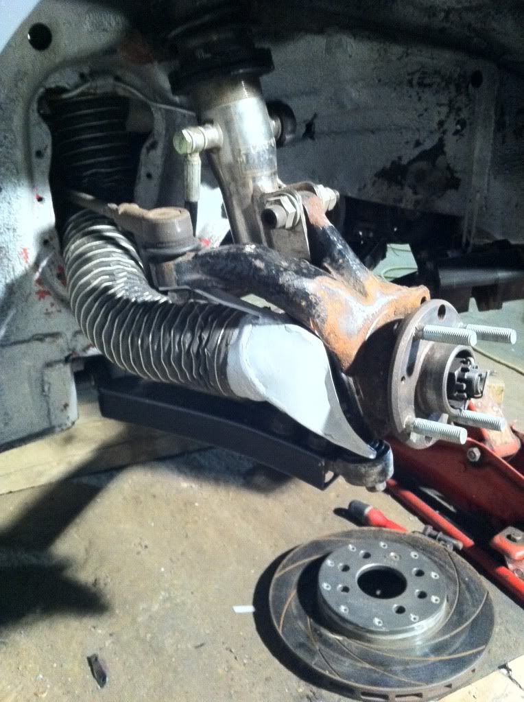

Which was attached thus:
http://i205.photobucket.com/albums/bb125/cpnova/152.jpg

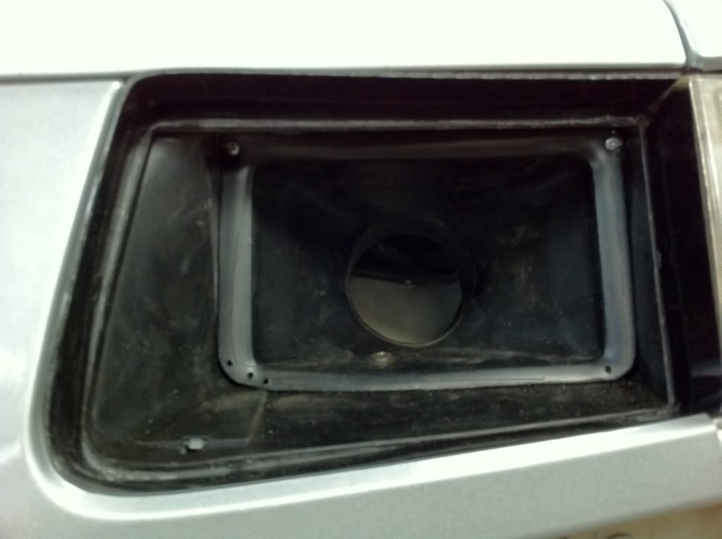

I then bodged this arrangement using the old lights and airfeed funnels bought fromTweeks:
http://i205.photobucket.com/albums/b...nova/172-1.jpg

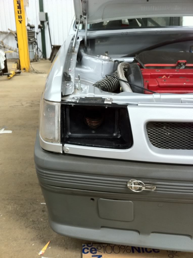

Which ended up looking like this:
http://i205.photobucket.com/albums/b...nova/175-1.jpg

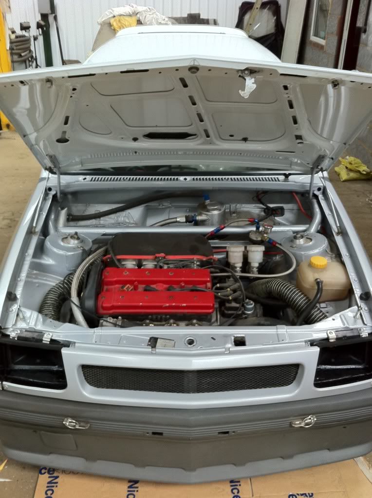

And feeding cool air through the engine bay to the brakes thus:
http://i205.photobucket.com/albums/b...nova/176-1.jpg

Ducting looks mega purposeful in the bay! lol Will the steering arms not catch the ducting going through there?
The arms will go up from that position presuming the springs do compress a bit, Would be fine unless you managed to get the hub to go lower than it does with no weight on it.

Very very good way of going it. Can you run something from the front so it points at the back of the calipar as well? To help keep that cool?
