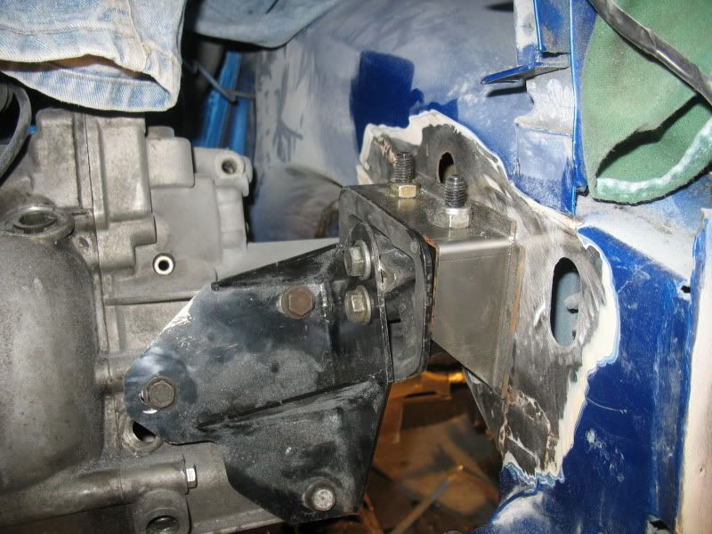

So holes slotted, had to do 4 out of the 5 annoyingly. But it means everything fits on now..
http://img.photobucket.com/albums/v3...8fitpart26.jpg
http://img.photobucket.com/albums/v3...8fitpart27.jpg
Did a bit of adjusting and checking..
Sound it was getting this..
http://img.photobucket.com/albums/v3...8fitpart25.jpg
Moving jacking and messing about but got this...
http://img.photobucket.com/albums/v3...8fitpart22.jpg
Then found this...
http://img.photobucket.com/albums/v3...8fitpart24.jpg
Re did it so the rear mount lines up (as well as it can with no rear bolts in it) But then the engine wasn't level.. But As i've been reminded the car might not be sitting level..
So its now all ready for welding.

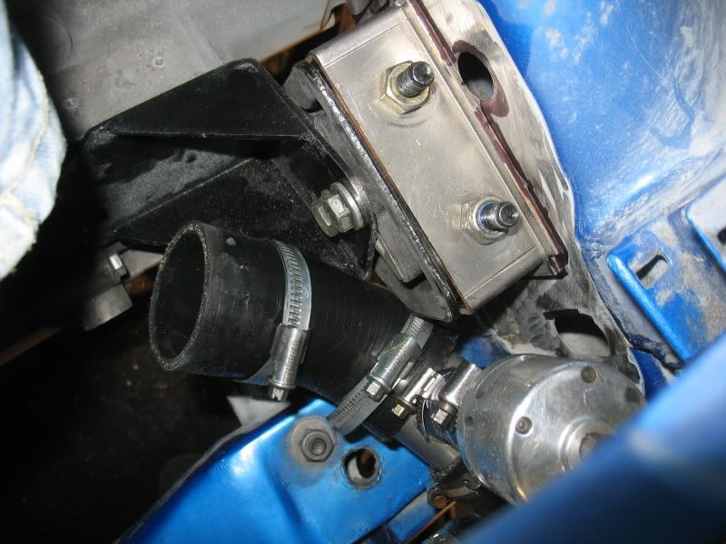

Found i'm gonna need to play here tho...
http://img.photobucket.com/albums/v3...8fitpart28.jpg
http://img.photobucket.com/albums/v3...8fitpart29.jpg
looking good bud will be intresting to see how you get on with the intercooler pipework iv still to overcome that myself well once engine goes in.lol
Bit opf a play with the silicone tubing will sort it i think..
twist the 90deg bend off the cooler so it points up and goes over the mount? thats how ive run mine, should still be able to hide the pipework.
Are you welding that mount on without bolting the rear on first??
Good work benn id bolt the rear mount up tbh before you weld the new mount to the car just to double check that its right as it'd be a pain to get off once welded lol.
