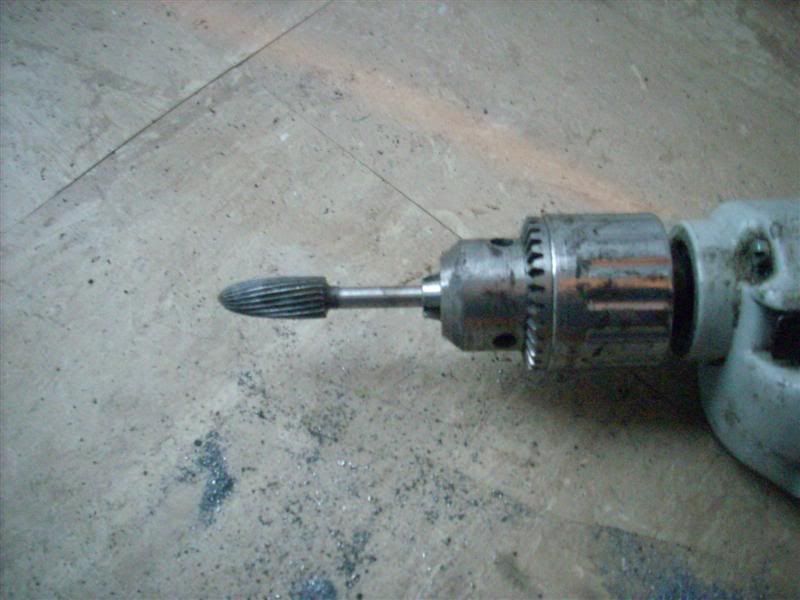

I'll just drill them slightly to get rid of the threads. If it fcuks them then i'll buy some new,Lol.
Got back from work today and cracked on with removing the insert threads.
Weapon of choice:
http://img.photobucket.com/albums/v8...1185Medium.jpg
One on the right done

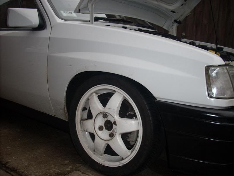

And who said Avo's dont go low :eek:
This is with an inch of thread left (jack is still holding the car up slightly as i couldn't remove it from under the crossmember, so its not fully down in this pic lol )
http://img.photobucket.com/albums/v8...1199Medium.jpg
http://img.photobucket.com/albums/v8...1198Medium.jpg

Adam, you might have an inch of thread left but, are you sure the pistons arn't all the way down, not allowing them to travel?
Theres no way i could lower my avo's that much without it seriously bottoming out!
Looks nice and low Ad.

Ive got them wound right the way up now anyways, the spring platform is sitting about 2 inches or two above the tyre :thumb:
